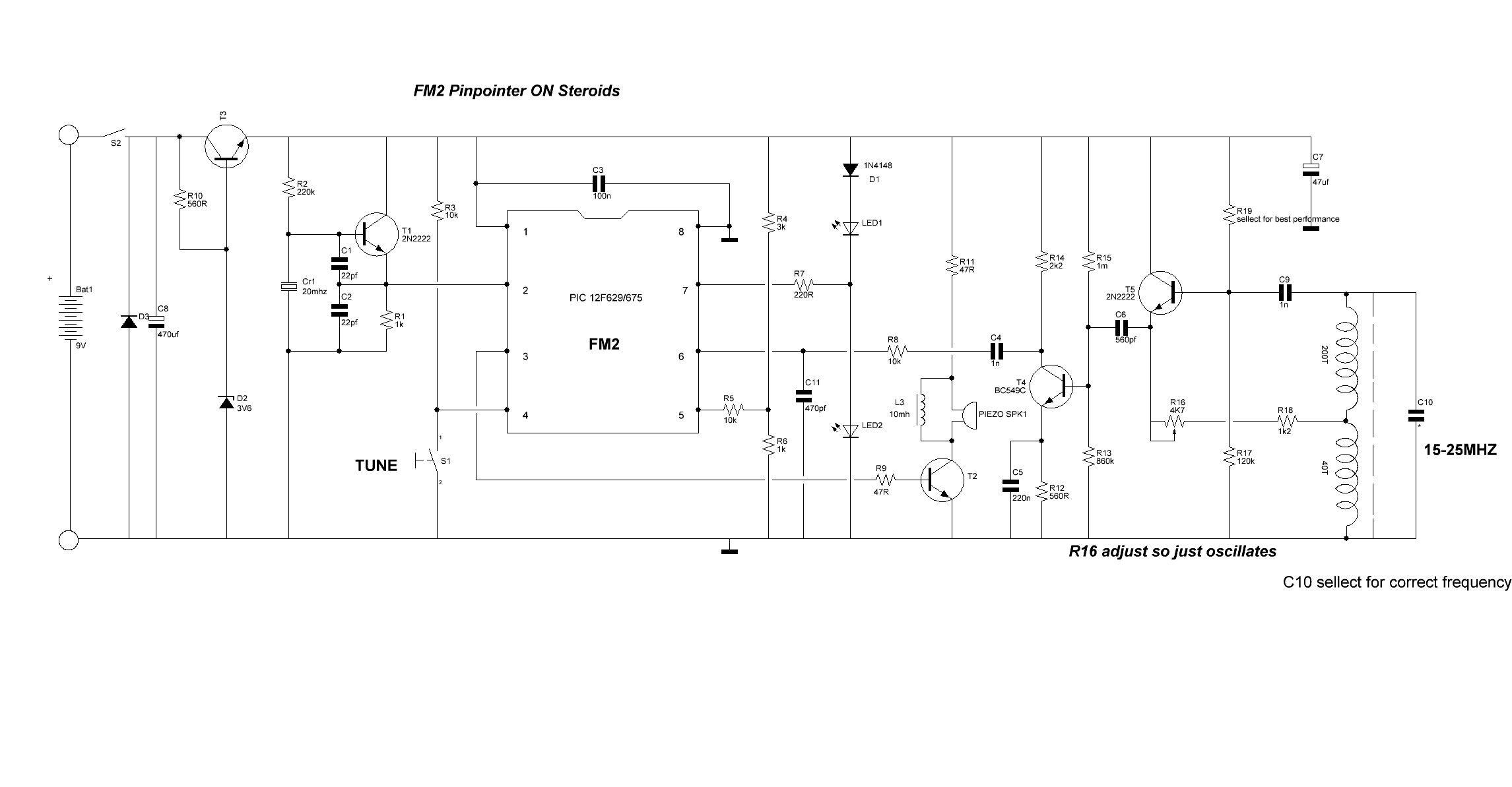

    Hiya,,,If I was using a small 8 ohm speaker (and changing the 4r resistor to 100r) do I still need the choke? Thanks. Marty
      Hi Dom,,,,Sorry, forgot to ask,,What wire did you use for the coil? Gauge/Diameter?,,,I've got 0.25mm,,0.5mm,,,and 0.18mm,,,I've got some 0.3mm somewhere but I'd have to search for it. Thanks. Marty
        if you use a speaker then use a 100R then you don't need the choke its like the original circuit i think i used .25mm wire for mine not critical if you are tuning it with a caps later i even used very thin wire like .1mm and managed to get it to work .

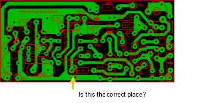

            found my instability problem its the solder station and power supply interference the probe is sensitive so you need to tune away from metals and away from electrical appliances causes problems but should not be a problem in the field also might be a good idea to add a 470pf
            capacitor from pin 6 to ground forms s low pass filter with the 10k resistor to cutoff anything above 33khz but working well main advantage is small nuggets and small metal sensitivity.

            final fixed circuit

              Hi Dom,,,,,I know what you mean,,,The ABS isn't that cheap here either,,I get 10 sheets for £18.99 and £1.99 P&P,,,It's not good especially, if you happen to make a few mistakes on the vacuum table,,lol. Could you check my diagram please Dom and tell me if I put the 470pf cap in the right place? Hopefully, if my FM2 works out, I'll design a mold for it and make an enclosure for it,,,see how the build goes. Thanks again. Marty
                try this way

                  Thanks Dom,,,I knew I'd connected it to the proper places (Ground etc),,but your's is a much better place to place it,,,you're unknowingly teaching me new things!,,lol,,Thanks for that. Right, I'll just re-amend my Layout now but I'll have to drill extra holes when I etch my PCB as I've already printed it off. Hate this 'waiting for parts' game,,lol,,Thanks again,,Marty

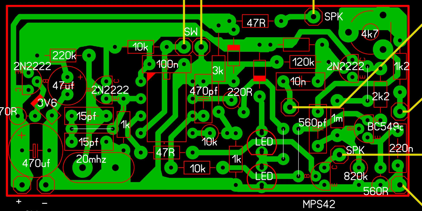

                        improved layout no links and added decoupler stage to oscillator amp stage needs to be checked thanks

                          Hiya DOM44,,,,With the coil having 3 wires,which wires would I connect to my Coil Tester (designed by KT315) to work out which value cap I need to make it resonate at 20mhz? I've used it successfully with my DD coils and PI Mono coils and it's pretty accurate,,,just not certain which 2 wires to connect?,,,I only just noticed your new layout,,,,Shall I scrap the other layout before I etch it and make this new one?,,,,Thanks again,,,Marty.
                          • #43
                            Marty you would be better of building the circuit first, wire it up then test it in circuit that way will be right first time don't scrap the board just ad the parts at the bottom or cut tracks still be ok

                              Thanks Dom,,,,,I've just printed off your last PCB Layout that you posted,,,I was going to etch the new one,,I haven't etched the other one yet. I'm building the coil tonight so I can find out what capacitor I need,,then it's ready to try when I've populated my PCB. Still waiting on 3 parts to come before I can build. I built a 'Coil tester' circut that was posted ages ago by KT315.Works really good. Which 2 wires of the coil do Iplace in the tester to check for the coil cap resonance? Is it the 200 turn part of the coil? That is, Coil End wire and Centr Tap wire? I used the tester on my IDX/TGSL and IGSL Coils that I made, connected the output to my Oscope and got them all into spec,,,I double checked my specs by wiring the caps to the coils, connecting them to my detectors, then checked the frequency was the same through the Oscope again. Really nice Coil tester circuit that KT315 posted. I can save those PCB prints in case and just etch this new layout you posted,,,So, sorry for being a pest,,lol,,if you let me know which wires on the coil to place in the tester I'll build that tonight,take some pics, and post them to see what you think. Thanks again Dom. Marty
                              • #45
                                I built the coil tester years ago different version of it its good and handy at times but this case with a taped coil better of doing it in circuit, I don't know about you but some times i make 2 or 3 prototypes when i am testing a new circuit doesn't always go to plan but thats the hobby i have many scraped metal detector circuits that just don't perform right eventually i will go through and salvage the parts and use on another circuit, as you go you learn more and more there is no substitute for hands on experience.
                                by the way you can build the oscillator stage and test it without the rest of the circuit.
