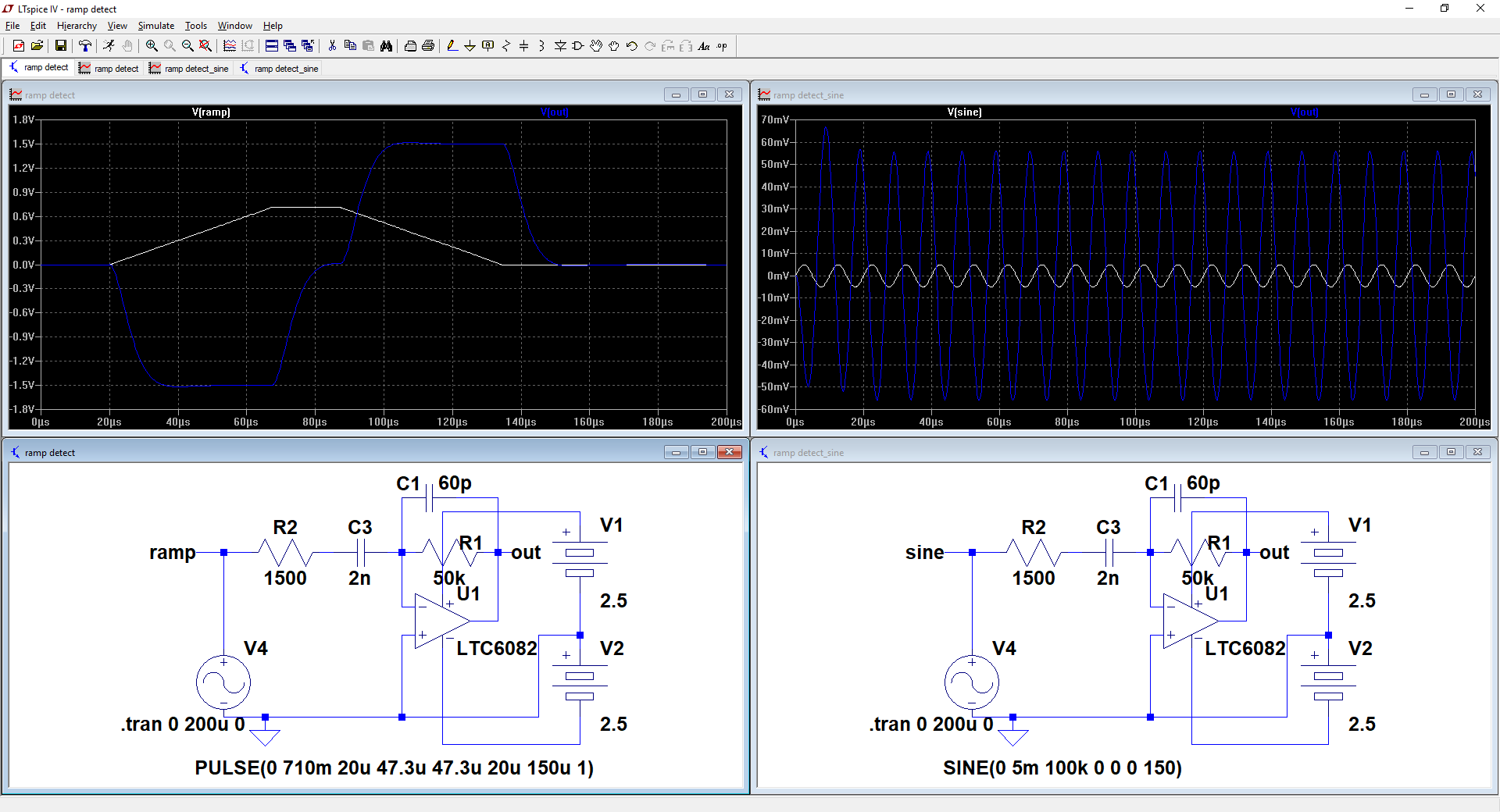

              Differentiator in spice. Set output=1.5v with 15mv/us in. Had to change time from 56us to 47.3us to get 710mv with 15mv/us in. Added sine input to show effect of noise in. Needed to add R2 and C1 to help filter noise. Causes a delay, how much delay is allowed? How much jitter is allowed? How much noise does your signal in have?

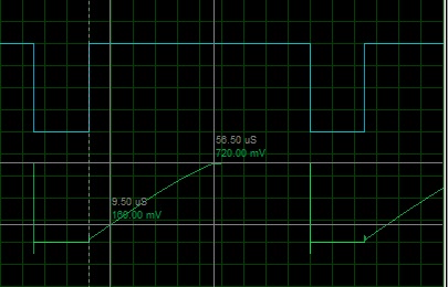

                For the rest of you, here are the waveforms (truncated as there is "secret" info in some parts)

                For Green: Jitter is NOT a problem as I can average this out. I'd rather NOT have any delay, but the less the better. If predictable (repeatable) I can compensate in later stages by using subtraction from the DC voltage in later stages. Generally, the lower all "errors" the better, but this world isn't perfect ...YET.

                  Looking at Waveform 11. Ramp doesn't start at zero volts, maybe 25mv in zero time. 100 to 200mv in 7us(14000v/sec). 500 to 600mv in 10us(10000v/s). 600 to 710mv slope changes a lot. Are you looking for certain slope change or when it flattens out?
                    When it flattens out. At that point, the magic with the other part of the circuit times (not mathematically, but spatially) another signal then, based on that time difference, these are the "X" and "Y" of the signal decay, a pot across the two provides virtually full range discrimination, from nail though to silver coins. The best part is that the sample time is <8us so this thing is insanely sensitive to the small gold flecks I'm looking for.

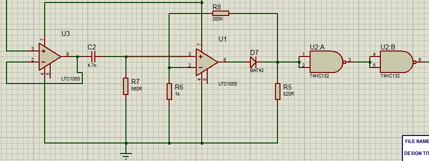

                      Messing around in between call outs at work, I came up with the following;
                      It's NOT the most elegant solution, in fact it is cruder than Bernard Manning, but IT WORKS, it shouldn't but it does! OK, it has 6us delay and quite a bit of "follow-on" on the tail edge of the rise period. The other problem is the terrible jitter which, so far, I have not traced the source of (suggestions as to source / remedy please).
                      I'm going to play with some monostables as I think I have a cunning plan to use the RESET input to cut short the pulse and eliminate a lot of the tail edge jitter as I might try synchronising signals a la FPGA techniques to ensure all inputs are timed correctly. I'll have to think a bit more about how I can do this.

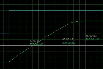

                        In your initial post you said: 'What I am trying generate a logic "1" for the rise period, but as soon as the signal levels off, I want a logic "0"., but then later on you've posted a diagram of your desired waveform which shows the generated output staying at logic "1" when the signal levels off.
                        Which is correct?
                          Initial slope approximate 15mv/us. Lot less before levels of. What slope is levels of? 1mv/us, 100uv/us, 10uv/us? What changes with target change, 710mv amplitude, time to level off or both?
                            Ah I see where some have got the wrong end of the barge pole .
                            The BLUE signal is the pulse that generates the slope via the magic circuit, the GREEN (apt really) trace is the actual slope.
                            Logic "1" when the signal is rising then falling to logic "0" when the signal levels off. The logic signal is the derivative of the green analogue signal. What I need to do is use the signal to gate off the green signal or the discriminate part "folds back" on itself and I get a disc range from nail, though to pull tabs, then instead of rejecting everything up to silver coins, the disc somehow flip and accepts these "bad" targets and rejects the good ones which is, as you can imagine, not very useful.

                              The jitter is likely due to the ramp waveform itself, not the detection circuit.
