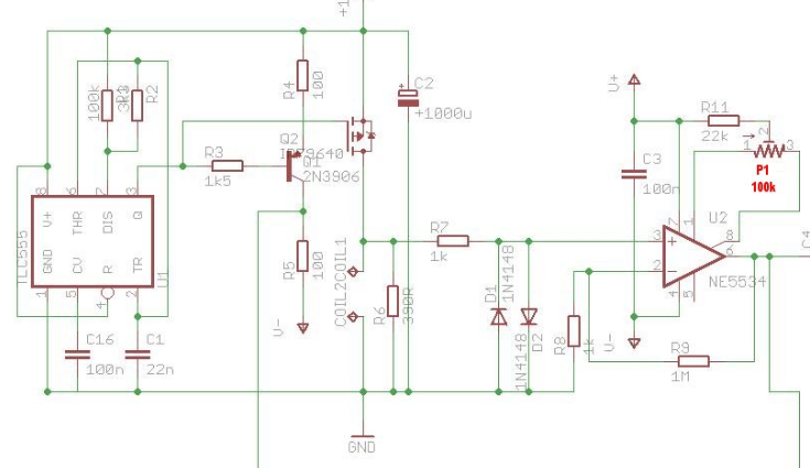

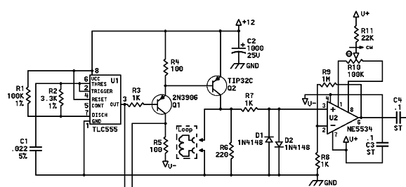

    I found two kinds of surf PI design from the Internet and this forum. I wonder to know why the output of 555 timer should have 96% duty circle and how can the 4093 chip to make it to a delayed clock signal. In addition, what is the difference between designs? Click image for larger version
ID:	371002 Click image for larger version
ID:	371003 why in the first one the MOSFET can connect directly to the output of 555 and what is the function of the Q1?

            Thanks for your reply. But why in the 2.PNG the gate is connected between R4 and Q1? what is the difference?

                Q1 was used to drive bipolar transistor then changed to MOSFET in pro version, which driven directly from leg 3.
                  So both design could work well?

                    In this picture, the Gate of MOSFET is connected to the R4 and Q1, is there any difference?
                      Pro version is improving on older version. I used ordinary power transistor to drive coil and I get very good results. MOSFET alone is no great significant improvement, required more complex circuitry to realize huge improvement in performance.
