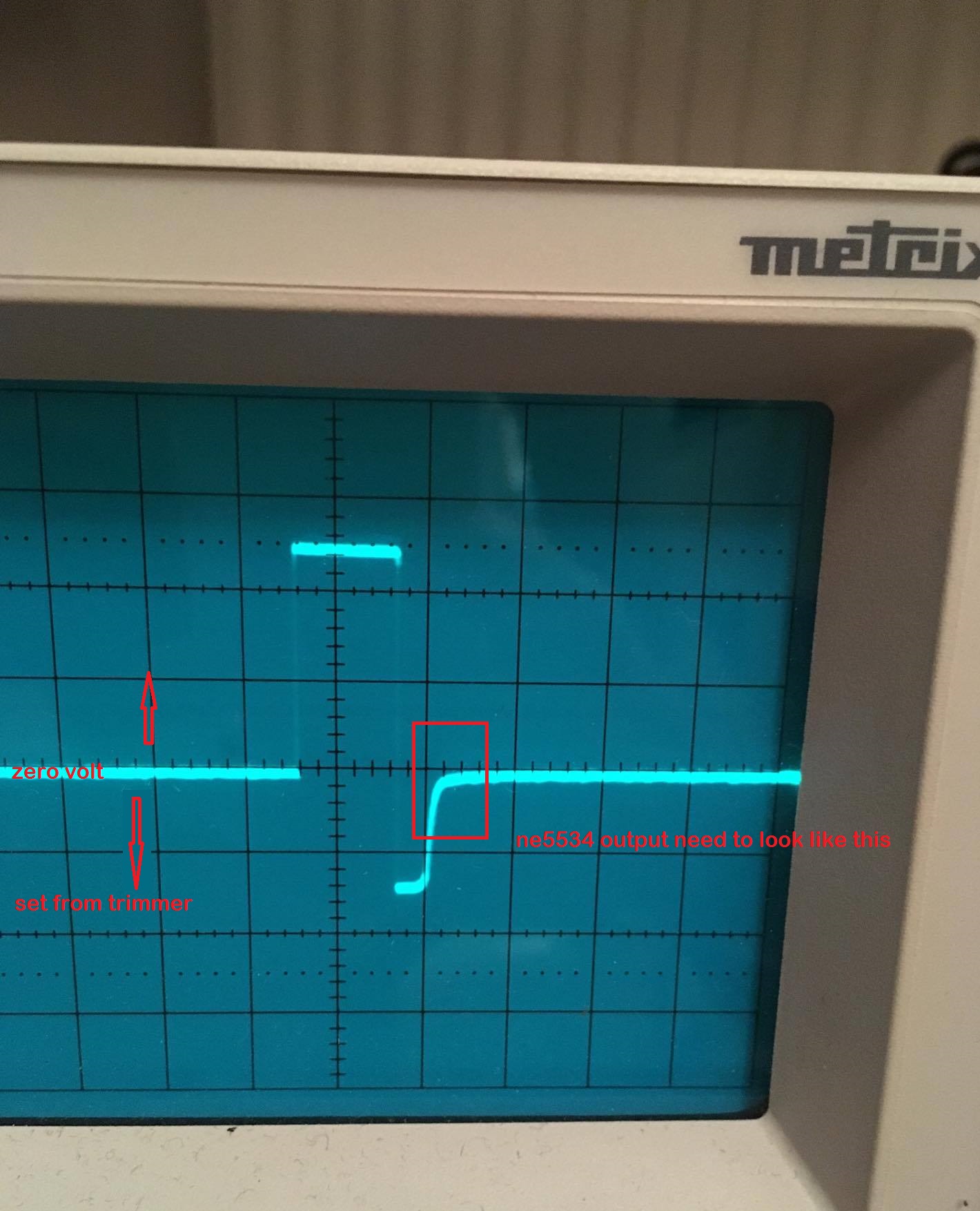

      Thank you. Would you mind telling me why this design choose the duty cycle of 96%? Will this cause too much current passing through the coil?
        The signal is inverted, so 96% off time, 96% on time would be much too much.
        I built the surf myself, it is economical in power consumption
          thanks. For surf design, how long are the delay of the clock signal after 4093B? How to calculate it?
            I do not know, I just built it.
            As far as I know, the delay is determined by the resistors and capacitors.
            Which version do you want to build?
            This was my first PI detector and I am still learning
              I think I am learning about the pro version and I am doing the simulation now. But I do not understand how to achieve delay using the NAND gate chip
