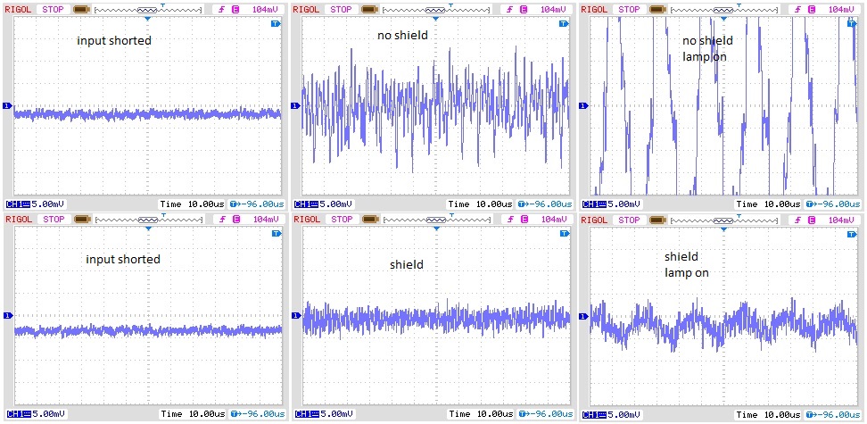

    (numbers) on right side. (17) absorption and reflective + a calculator. Entered aluminum, .64mil and 10kHz, 100kHz and 1MHz in calculator. Absorption loss was low, reflective loss >100db. If I look at amplifier out, coil connected to amplifier with a scope(Tx off, just looking for EMI pickup). I see a noise level. Covered coil with regular strength aluminum foil both sides, saw some reduction in noise. No where near 100db. What should I expect to see? Maybe something I'm doing wrong?

    Thank you for starting a shielding thread. The shield, in your case, the aluminum foil, needs to be connected to the ground of the detector. Aluminum foil has a thin layer of aluminum oxide covering it. Aluminum oxide is a very good insulator. Since it is a very thin layer, it can be broken with some friction, but new oxide forms very quickly, there is always a risk of bad electrical contact unless there is a solder connection.
    I used to make a simple test to check the shielding on a PI coil. Approaching my hand to the coil without shielding, produces a lot of noise. With shielding the hand should not be seen by the coil. Not much of a precise science.

          Trying to learn something about shielding. It was suggested in another thread that I should shield the detector circuit. Using the coil as a transducer for noise pickup. The test is to determine drop in noise from shielding. Wrapping the detector coil in aluminum foil wouldn't work because it would act like a large long TC target. Another test: covered both sides of a 20cm 26turn flat spiral coil with cardboard cut from a cardboard box. Connected coil with 30cm twisted pair lead to TRT preamp. Tx coil not connected. Coil located about 1.2m from scope and .4m from a 10W CFL lamp(on or off). Distance to scope and lamp has a large effect on noise pickup. A long piece of regular strength aluminum foil was folded around the coil to shield it. Shielding better today than what I remembered last time, still along way from 100db(reflective loss) Should loss be closer to 100db?. Reflective loss not effected by thickness. If foil was thin enough to not act as a target, maybe could shield the coil? Is there another or better test for determining emi reduction from shielding?

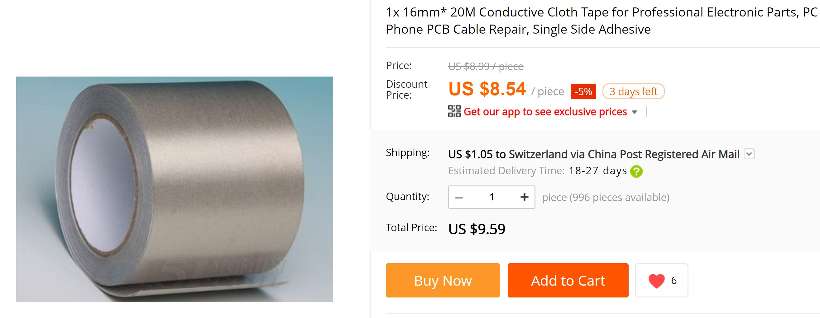

              Attached is a shielding tape sold by Aliexpress. It does an excellent job at shielding, but it also reduces the TX pulse a bit.
              It also adds capacitance to the coil and cable. As I use a 10 feet twisted pair cable, shielded with this tape, to add distance from the scope and the computer, the capacitance is very notable.
              To reduce coil to shielding capacitance there is no better way than adding distance or space between shield and coil or cable. Even 1 mm makes a big difference. The capacitive coupling seems to follow an exponential relationship.

                            This is the tape I use very successfully. I buy it from a company called 'cidimall' on eBay. Woven cloth is nickel plated copper and another good feature is that it is backed with conductive adhesive. I wrap the bare coil with PVC spiral cable wrap and then helically wrap the tape on top of this which gives mm or so spacing. For the last few turns of shielding, I wrap it over a couple of inches of bared 7/0.2 stranded wire which connects to the shielding via the conductive adhesive. the tail of the wire, with a bit of the retained original insulation, is then connected to coax ground/coil end ground. There must be a small gap of course to prevent a shorted turn effect. Wrap around shielding is by far the best, because coaxial construction around the coil bundle results in minimal eddy currents in the shield and least effect on the TX waveform.
