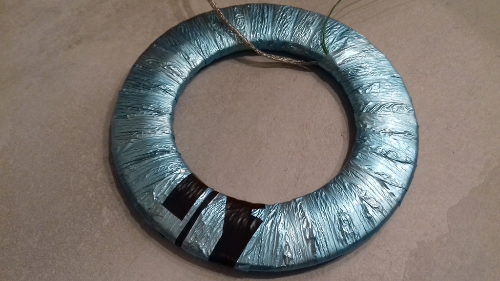

In my experience, I have got good result with mylar conductive taken from some shielded cables, e.g. video cables, used like in the attached photo.
My primarily purpose is to shield from electrostatic field in order to avoid external capacitive influences.
