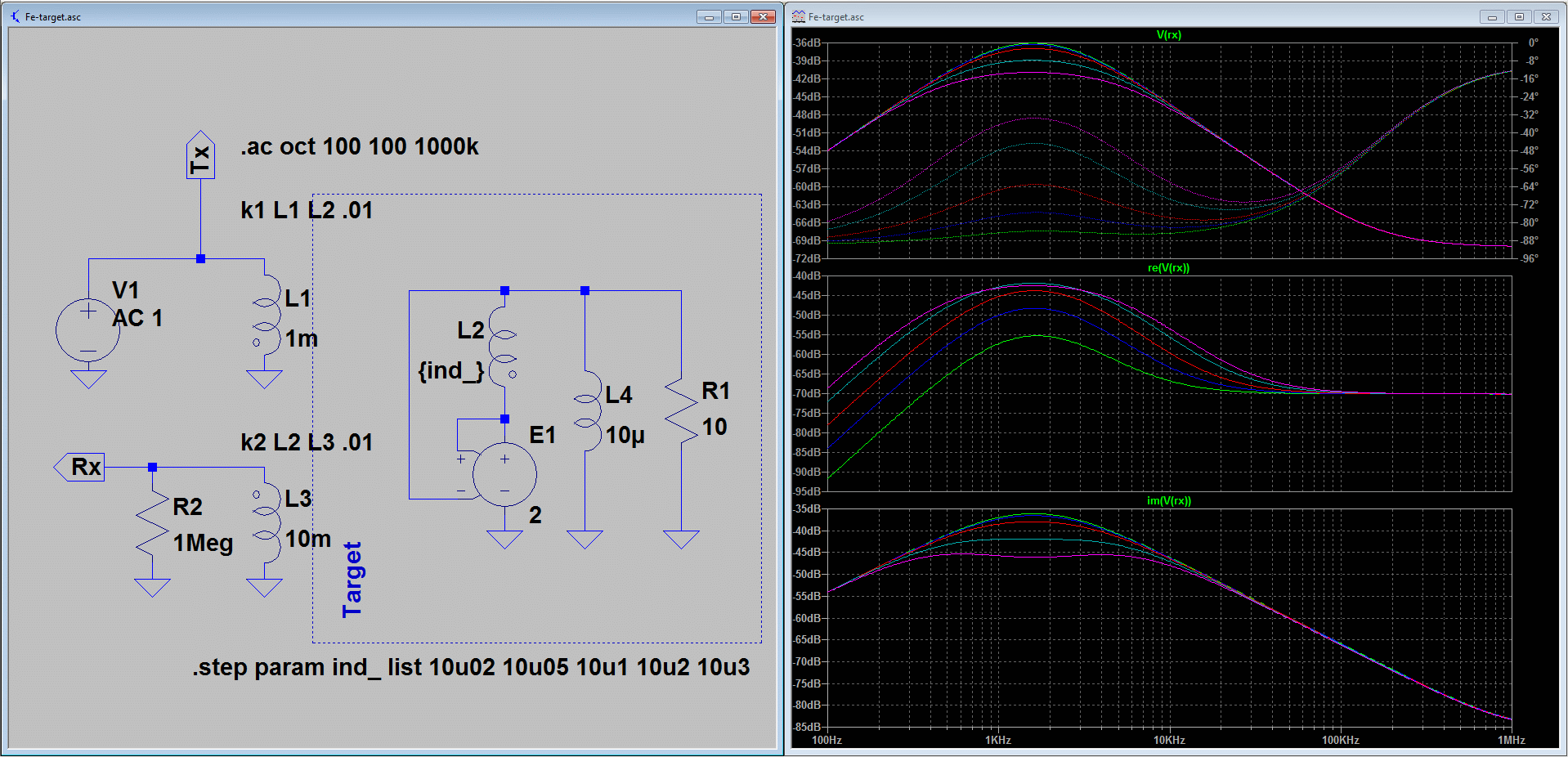

    I think I was on the right track with my previous Fe model. It was based on a negative inductance, something that naturally happens in vicinity of transformers, and it placed the response in a proper quadrant. However, response was completely wrong. Instead of a response circling from left to right with frequency, it did the opposite. But at least the quadrant was correct.
    Now I have a small correction, and it seem OK. It should be properly tested, of course. It is based on a inductance difference, which effectively gives an equivalent of μr >> 1
    Also it is rotating as it should, and it ends at high frequencies as mostly resistive, yet still on ferrous side.
    If only I could produce a Cartesian plot in AC simulation... Here are the magnitude/phase, real, and imaginary outputs. I'd say it is close enough, but please knock yourself perfecting it. It should be possible to curve-fit some materials with responses measured on professional equipment.
    Here goes:
      So my conclusion (at the moment) is that real effective ferrous / non-ferrous discrimination cannot be achieved with a mono coil.
      Now, go and prove me wrong ... not with an LTspice simulation, but with some real hardware.
      P.S. I'm talking about a standard PI setup here, and not other variations that use truncated sine or triangular waves, etc.

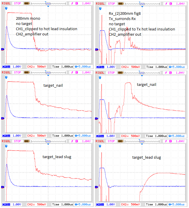

      My attempt with a mono coil. Thought I could see a difference in the beginning based on what I saw with the IB figure8 coil. Didn't see a difference with the mono coil so repeated test with IB figure8. Can see a difference. Any suggestions why I don't see a difference with the mono coil? Maybe something to try?
        The same reasons I presented in post #30. The effects of redistribution and absorption are simply not visible when using a mono coil, and can only be seen with a balanced coil arrangement.
          But the whole point is that PI is inherently an in-phase detector. The whole difference in balanced vs. mono coil is the possibility to look at the time where excitation field still collapses, and quadrature response still creeps through.
          However... there is a difference in in-phase frequency response of ferrous materials against the non-ferrous. Up to ~ 30kHz the Ferrous in-phase response is a low pass, while non-ferrous is a high pass. Because EF knocks the response tail to zero, a Fe response, with a fat low pass tail, may sink below non-Fe responses for the early samples. And there you have it.
          I believe my simple model from post #31 may prove useful. The only thing I'm missing are the different material data. You may find some data scattered on Internet, but fun part is that you may tune this model to accommodate. See this paper: Effect of nanograin?boundary networks generation on corrosion of carburized martensitic stainless steel but especially the Figure 3, and compare those to my model. I'd say I nailed it
            By in-phase i meant resistive - in PI there is little point speaking in terms of phase.

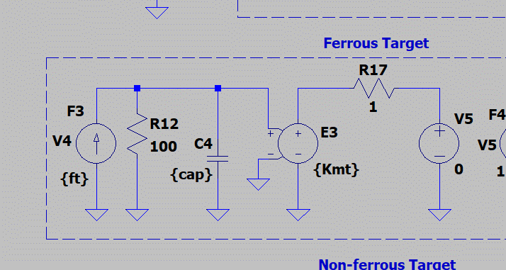

                          George, I checked your model, and the ferrous part is wrong. I attached a part of your schematic that needs a correction, and I don't expect it to work properly on the first run, but it will respond in a correct quadrant. Also you should try it in AC simulation prior to attaching it to a narrowband RTX.
                          • #43
                            I don't understand how that could work, as you've removed the target inductance and replaced the mutual coupling capacitance with a resistor and capacitor in parallel.
                            This method, that uses a combination of controlled sources, is an overly complex solution which attempts to remove the necessity to define coupling coefficients between the various inductors. The simple reason for this is because LTspice does not support the use of its Chan core model together with mutual inductance. The actual target model is the part in the middle, and the two outer sections define the mutual inductances between the TX and RX loops and the target. Although you can now use the core model with this setup, the results are not correct. I suspect this is because the target inductance is calculated implicitly from the core parameters and the geometry, whereas the mutual inductances are calculated from an explicit target inductance value. Hence I've decided to revert back to the use of coupling coefficients, and somehow defining a model for the ferrous target to give a more realistic magnetic response.
                            As far as I can see, the simple LR target model works just fine for non-ferrous targets that produce an eddy response.
                            Also, when I tried to use the overly complex model in a PI simulation, there were some difficulties connecting both ends of the model to the a single TX loop. Therefore it would be much easier if it was possible to use the original setup. The problem is not so much getting the correct phase, but to also produce a decrease in amplitude so that it can simulate correctly in a Tesoro-like detector circuit.
                            • #44
                              As ever you like it. Good luck obtaining correct phase response.
                              As for steel frequency response, seek a paper "FREQUENCY-DEPENDENCE OF RELATIVE PERMEABILITY IN STEEL" by N. Bowler. That paper alone is enough to sink a lot of PI nonsense related to Fe.
                              • #45
                                BTW, a resistor and capacitor in parallel to a current source = leaking integrator. A coil parallel to a current source = differentiator, and not a target inductance.
