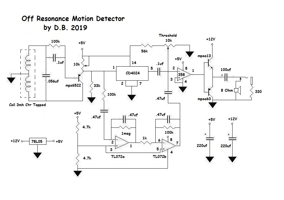

    Howdy folks! Just wanted to share a project that I have been working on for a few weeks. A redesign of the old White's TR Series 2. The original was difficult to set up for optimum performance, had a terrible thermal drift problem and no discrimination. The good features were automatic ground balance and decent depth for yards and parks. At any rate, it's a fun, cheap and simple detector and it works.
    The change I made is a simple filter system to eliminate drift and made tuning very easy.
    See the link below:
    https://youtu.be/2dF09YP3E4o
    The coils are easy to build - 3uH shielded -about 100 turns on a 5 3/8" form, center tapped at 50 turns, 30 AWG . It should run right around 12k Hz. I used a USB-2 cable for the coil below. It works like the original. You can build larger coils too for more depth and coverage.
    For setup ? Adjust the 10K pot on the MPS6522 emitter for a 3v PP sinewave in Pin 1 of the CD4024.
    Thanks to Smitty II for helping with the board layout. Any interest just PM me.

      3uH or 3mH?
        I'm thinking 3mH, seems more reasonable.

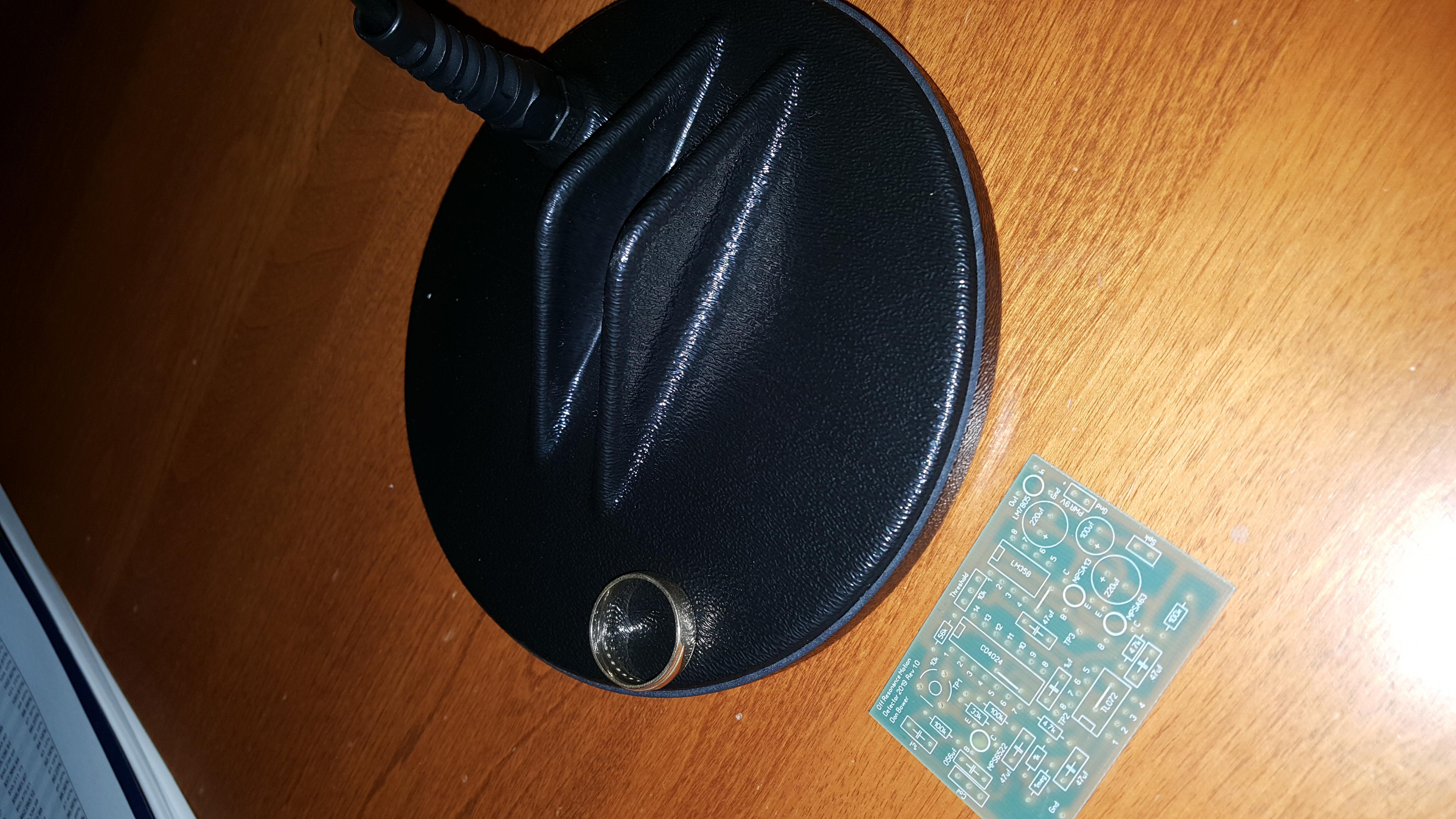

        I recently tried to copy another ancient coinmaster 2D, but etching process went horribly wrong.
        If anyone's interested, I can post the layout file.

            There was a thread with some more photos of the board somewhere on forum. Here is the sprint layout along with schematic and photo. Should belong in other thread if I could only find it.

                just a start, maybe ech of us can add some parts, my eyes falling asleep soon
                pcb.zip
                  Soo few components, worth to try... Any equivalent for the transistors and ic?
                  What about center tap coil, never built one before.

                      By adding turns to a coil, you cannot simply multiply. It's not a linear relationship. I can tell you that 100T with a centertap on a 5 3/8" form will give you something close to 3mH.
                      Sometimes I take a turn or two off to get close to 12kHz. Also, if you are off a bit it probably won't matter that much. I built a few coils that were + or - 1000 Hz and it worked just fine.
                      About the centertap.. Just use a USB2 cable and use the shield lead wire to ground your centertap and coil shield.. Pretty simple.
                      Also. I can post up a complete parts list. Parts are readily available but I would not start substituting parts as some are critical.
                      For example.. The TL082 will not work in place of a TL072.. at least I could not get it to work. The MPS6522 is a high gain transistor and it's good to stick with it.
                      Same goes for the LM358. It has to work right at 0V and other op amps may not work at all. Other than that, its easy to build and use.

                        Agree. It is better to calculate it using some of online air core inductor calculator. par example:
                        https://m0ukd.com/calculators/air-co...or-calculator/
                        For 17cm coil body you get 80 turns for 3mH, so center taped at 40th turn:
