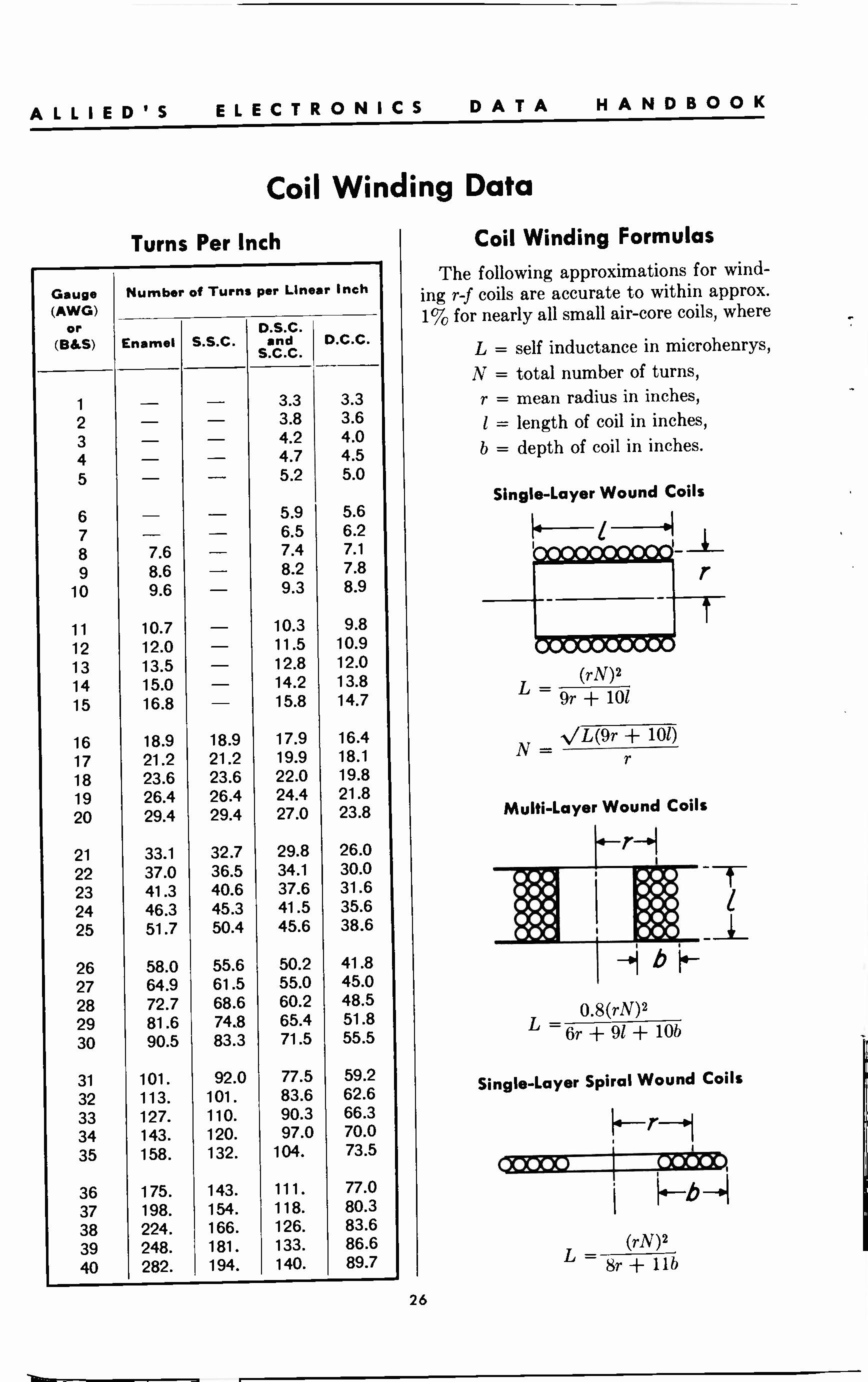

      Turns per inch table with different gauges and VERY ACCURATE FORMULAS for coil winding. Maybe not applicable to larger air core coils, but could give some reasonable results especially for flat spiral in use with pulse detector. The turns per inch table looks interesting, if only I can figure out a good use for it.
        Enjoy

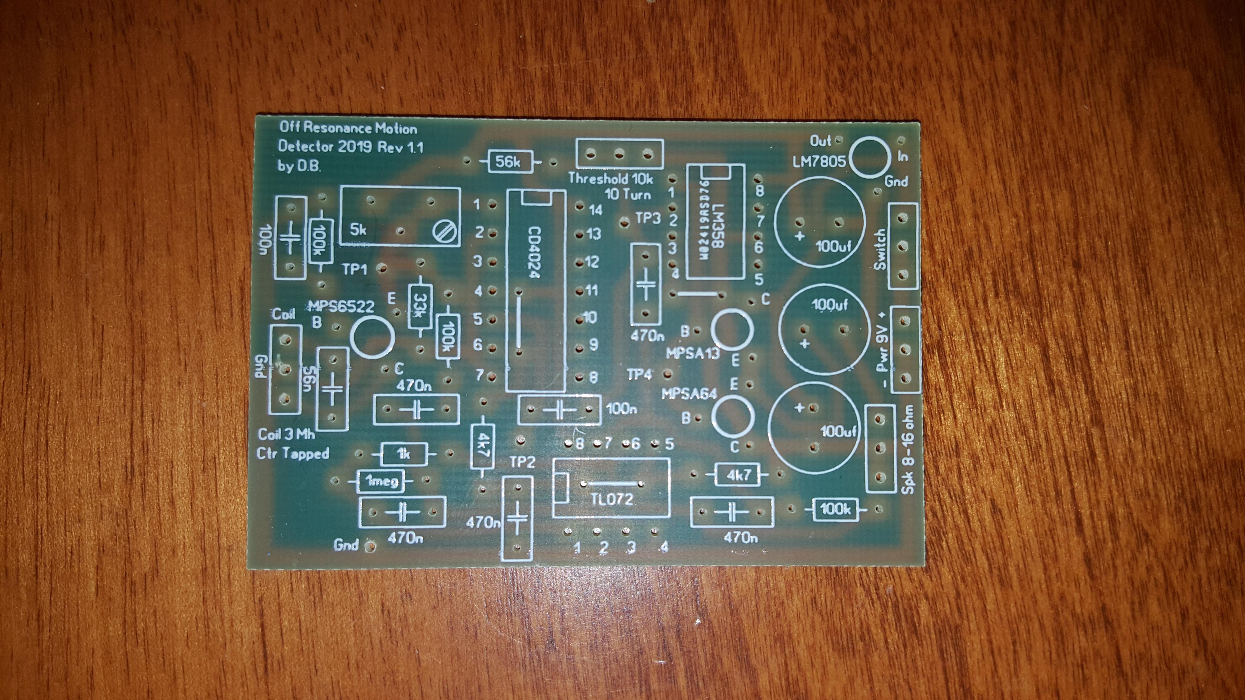

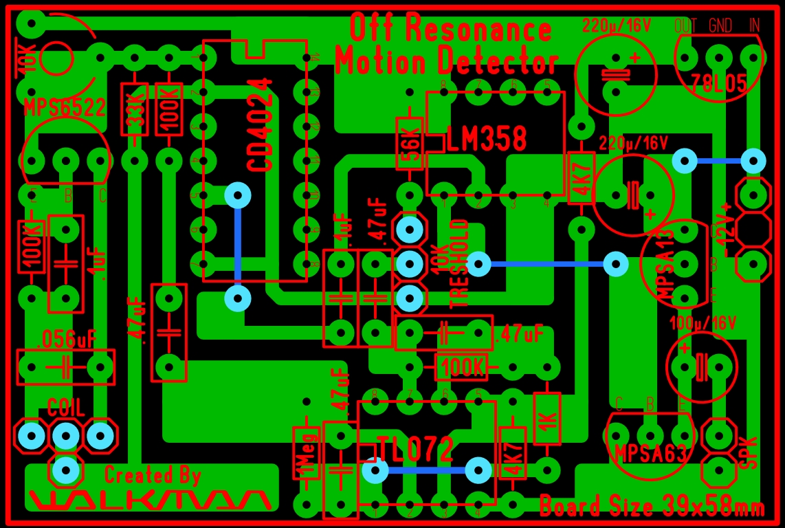

            I had another member make me a few but don't have the .lay files. If you PM SmittyII he might be able to. Some of you guys are a real wiz at laying these out.
              hello master. I want to make this device. pcb sprint layout or pdf format drawing. Can you give it to me?

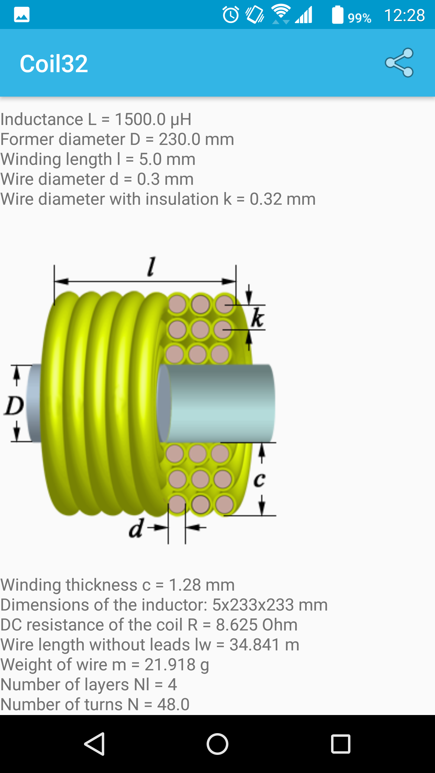

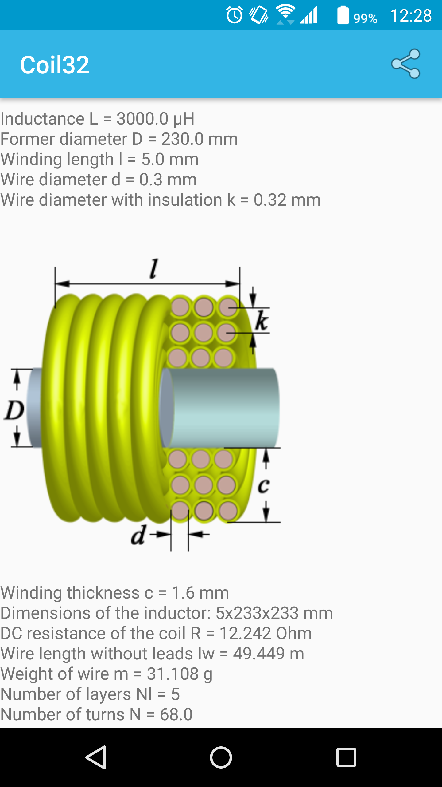

                My plan with 230mm template
                turn Click image for larger version
                center tap Click image for larger version
                lay file adaptation from walkman - please check first

                  Hi ripsdevala
                  Center tap should be at half of total number of turns and not at separate calculated number of turns for half inductance.
                  In your case (68 total turns for 3mH) this mean at 34th turn and not at 48th turn.
                    Hi ripsdevala
                    Oh i see, thanks for the correction

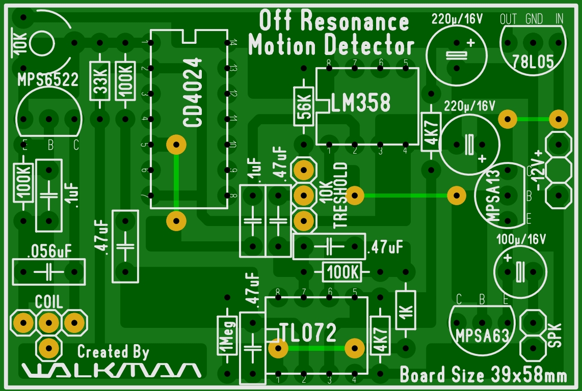

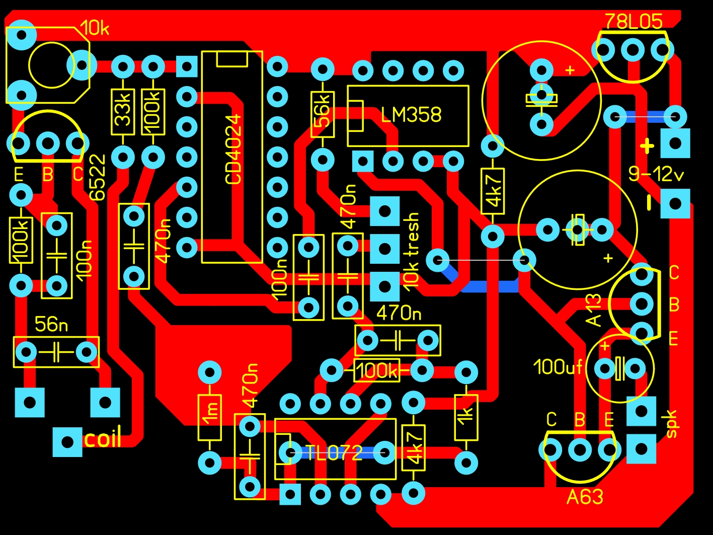

                          Here is my attempt, haven't made it yet. Just finished drawing. It was fun as always.
                          BC327/40 is always good choice, since it is usually having hFE larger than 450, in case one can not obtain 6522.
                          BC547/557 pair will do just fine with proper piezo. Also with 64 ohms and higher impedance speakers.
                            Hi Ivconic
                            There should be a connection between the wiper of R8 (Threshold) and pin 6 of U3b.

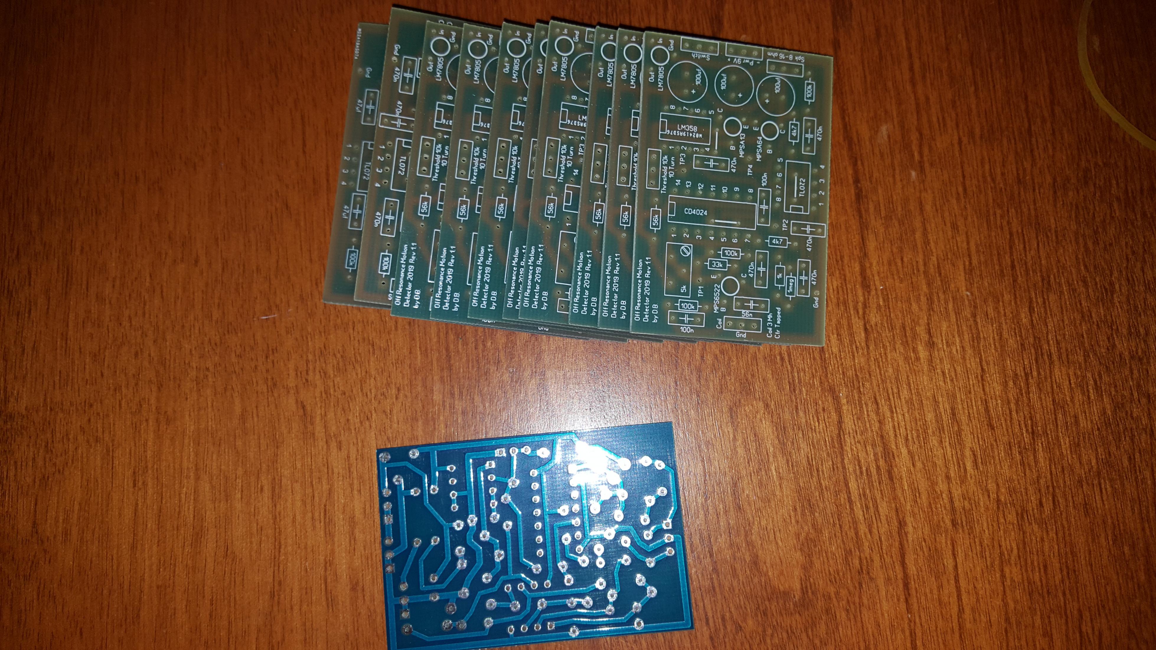

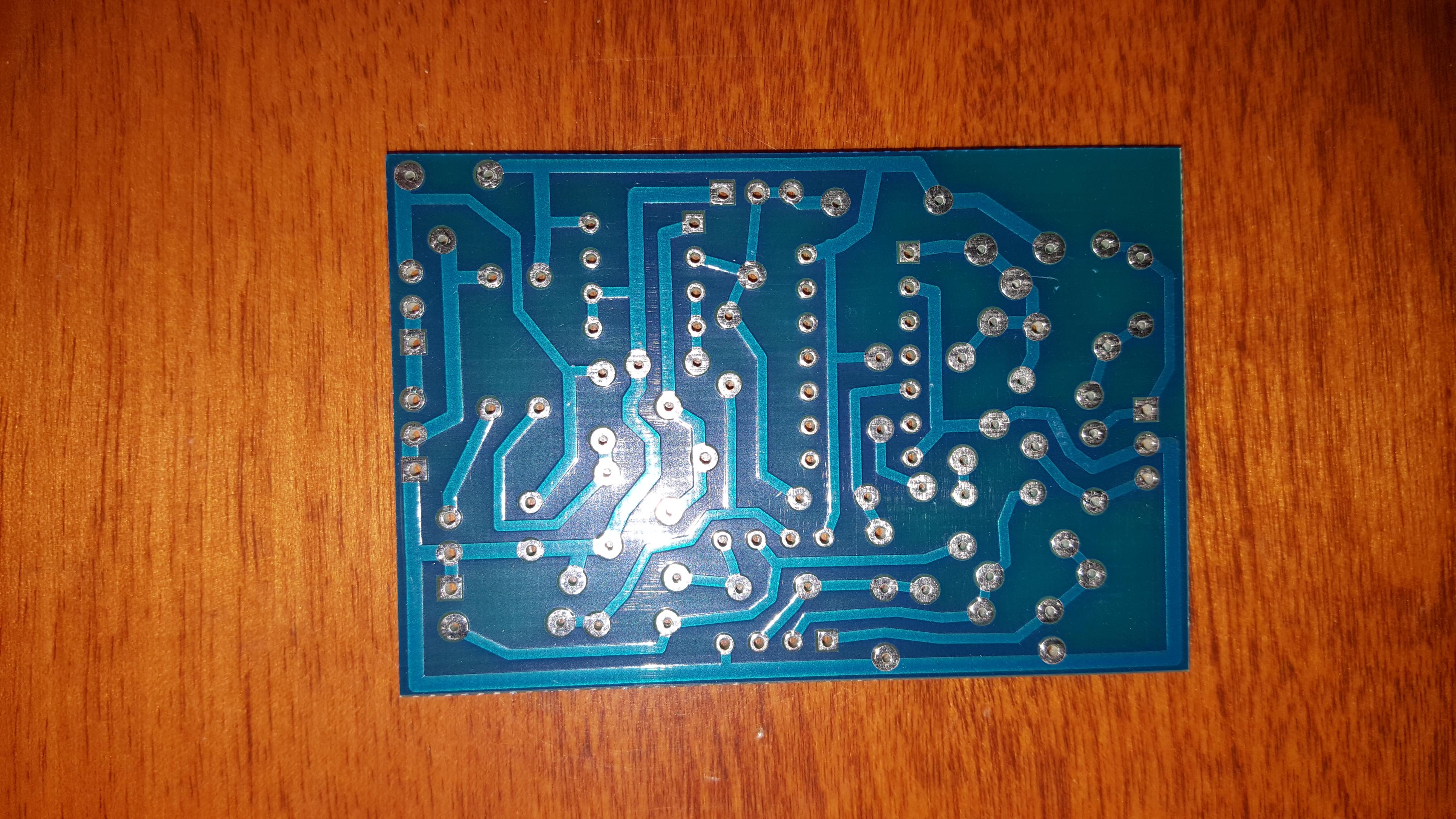

                              I had this circuit on a breadboard for over a month before Smitty made me a few PCBs. I tried the virtual ground idea
                              and it worked. I did not see any advantage though. One thing about this circuit that I really like, just like the original
                              is that the audio is very nuanced. A good set of headphones really brings it alive. You cannot tell much from the video that
                              I posted though.
                              I also tried coils ranging from 6 - 10". You can gain a little depth and more coverage at the expense of pinpointing.
                              For parks and yards the 6" is a good choice.
                              Don..
                                Corrected!
