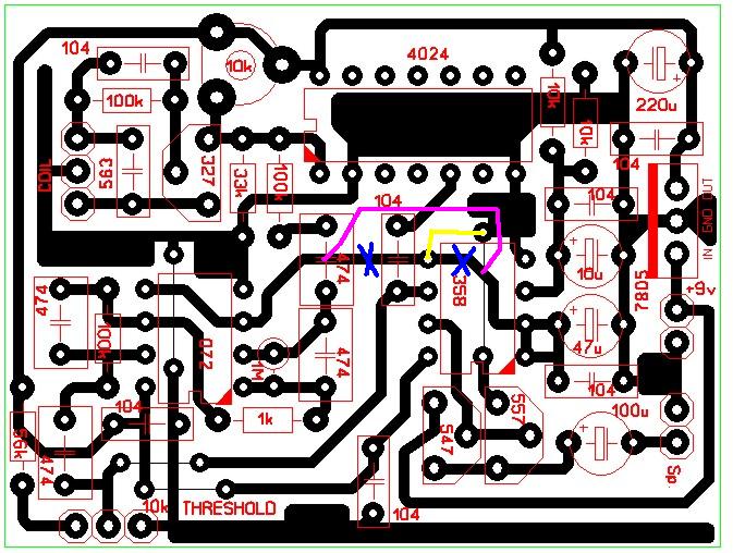

                            BUGGER!
                            I spent 3 hours trying to make it work... UNTIL i spotted stupid mistake that i made on my pcb draw!
                            Since i changed original schematic and used second part of LM358 for virtual ground; i wrongly connected 5. pin of LM358 to virtual ground INSTEAD to "minus" rail.
                            So it will remain silent no matter what you try.
                            I am attaching here the marked error and corrected Sprint Layout file. For those who maybe already made it according to my pcb; you only need to cut track on two places and reconnect properly.
                            For those who yet intend to make it; attached Sprint Layout file is now quite correct, tested and checked!
                            Yes Don was right, BC327/40 will not do. Yet; BC560 will do just fine. Because i couldn't obtain MPS in local shops. So i tried some similar types. BC560 is closest from what i tried.
                            10k trimmer to adjust 3vpp at 1. pin of 4024 is somewhat critical (due not noted transistor on place) to adjust . I managed to find narrow spot where it starts to oscillate and works quite alright. So be patient and slow when turning the trimmer.
                            At the audio output i put BC516&BC517. Alright!
                            Now is fine. Alive and kicking. Have some potentials. I only need to make better coil.
                            Here is the error and how to correct it:
                            And here is the corrected pcb design:
