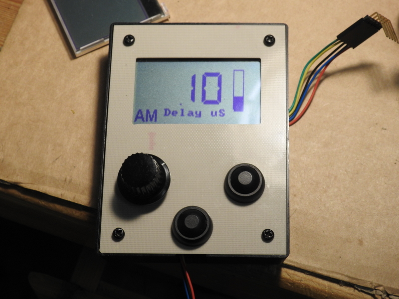

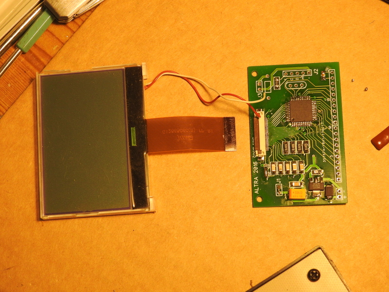

                    I've been using these cog displays made by Newhaven display. This model can be used in bright sun light. I use in the parallel mode for speed, but these also can be serial spi. Draw back is the connector and 9 capacitors. I got some generic pcbs made for a pic18f45k80 that drives the display, monitors an optical encoder, push buttons and sends variables to the main pcb using the uart.
                    attached photos of pcb and one in actual use
                    Newhaven NHD-C12865AR-FSW-GBW 128x65 graphic LCD STN + positive. This transflective LCD operates at 3.3V supply voltage and is visible with ambient light or backlight.
