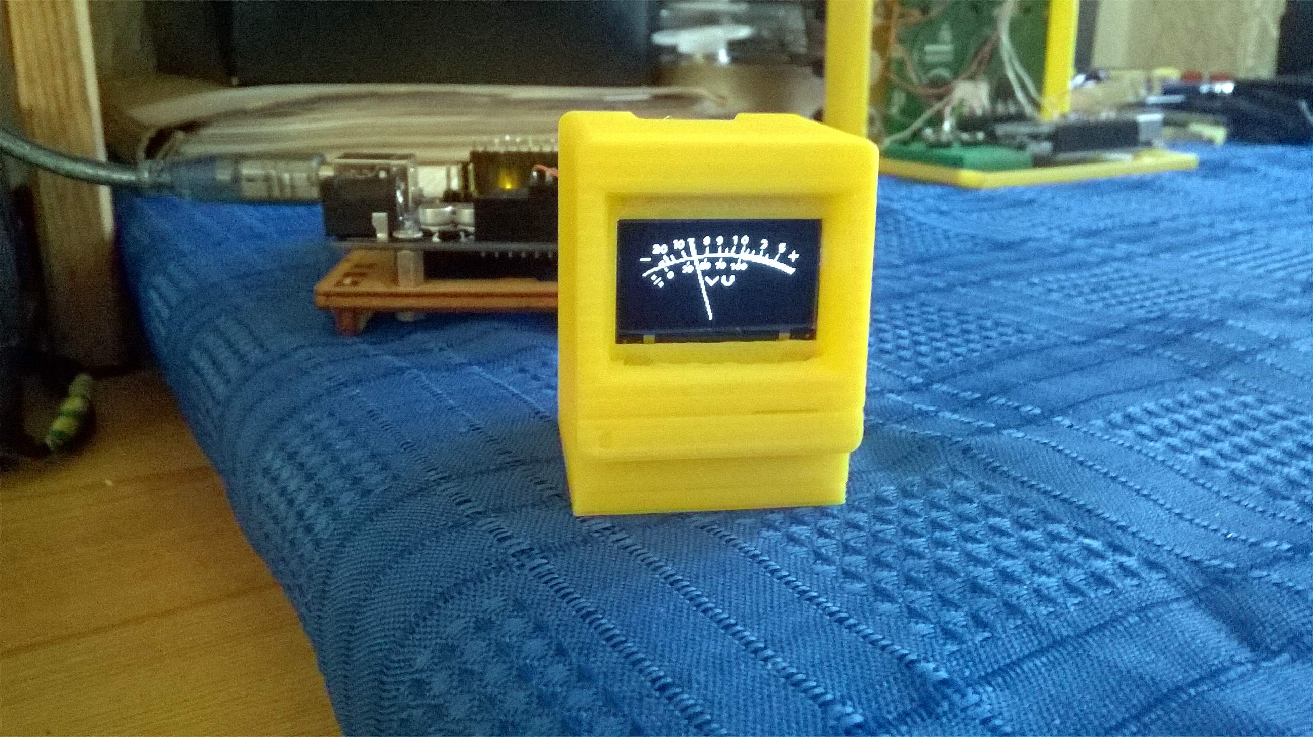

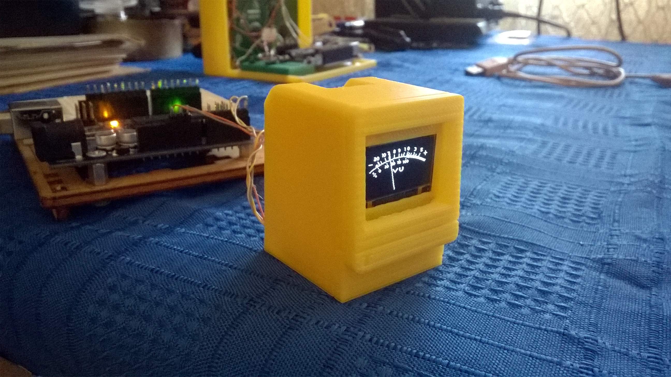

                          3-wire(d) 0.96" OLED in Apple Macintosh micro case:

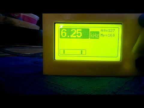

                          3-wire(d) GLCD 128x64, precise square signal generator with some unfinished graphical elements:
                            Only 3 wires at both examples.
                            How many wires were at some custom COGs we seen so far?
                            Anything what COG can do; GLCD can do better, not to mention what OLED can do!

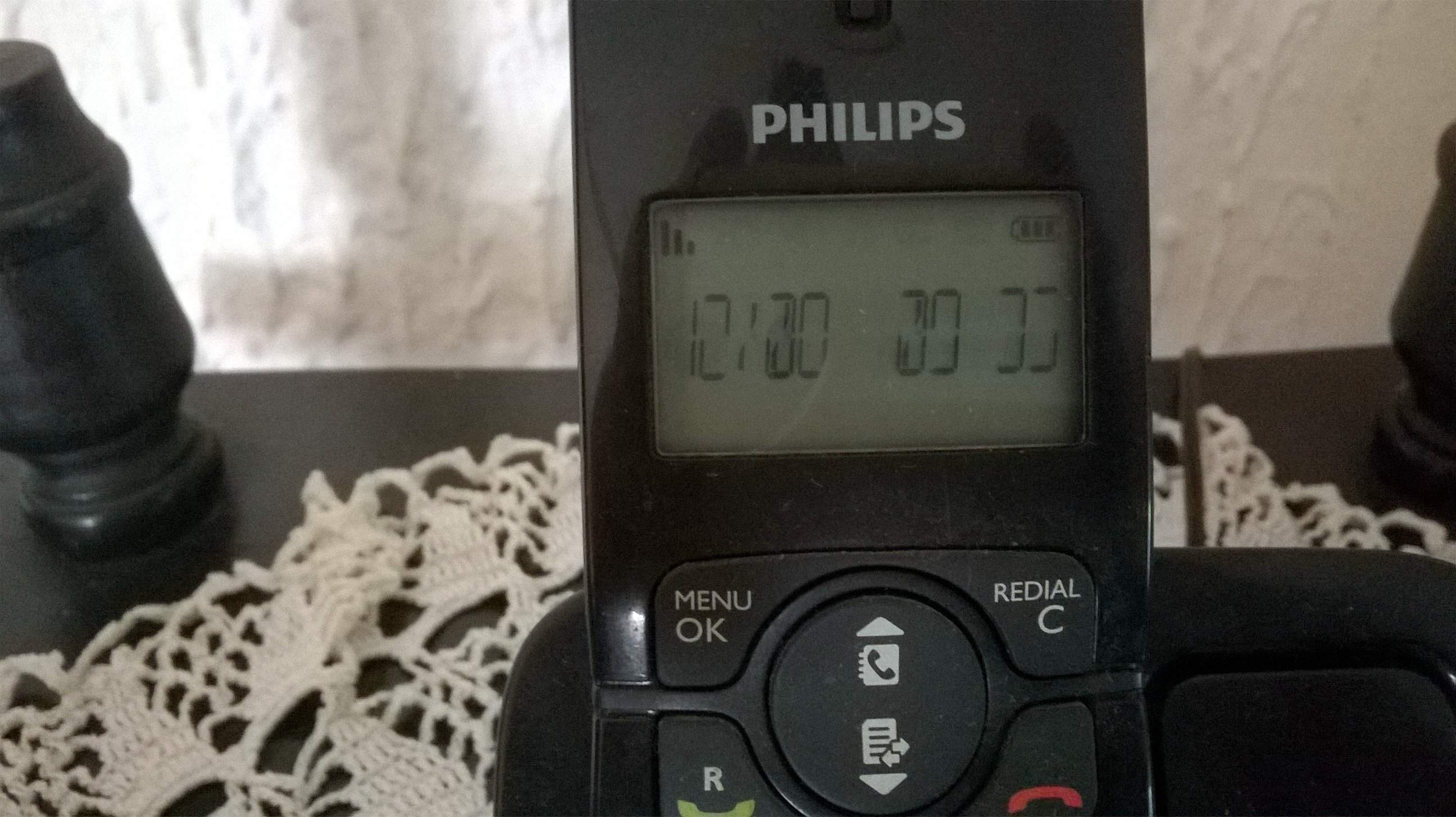

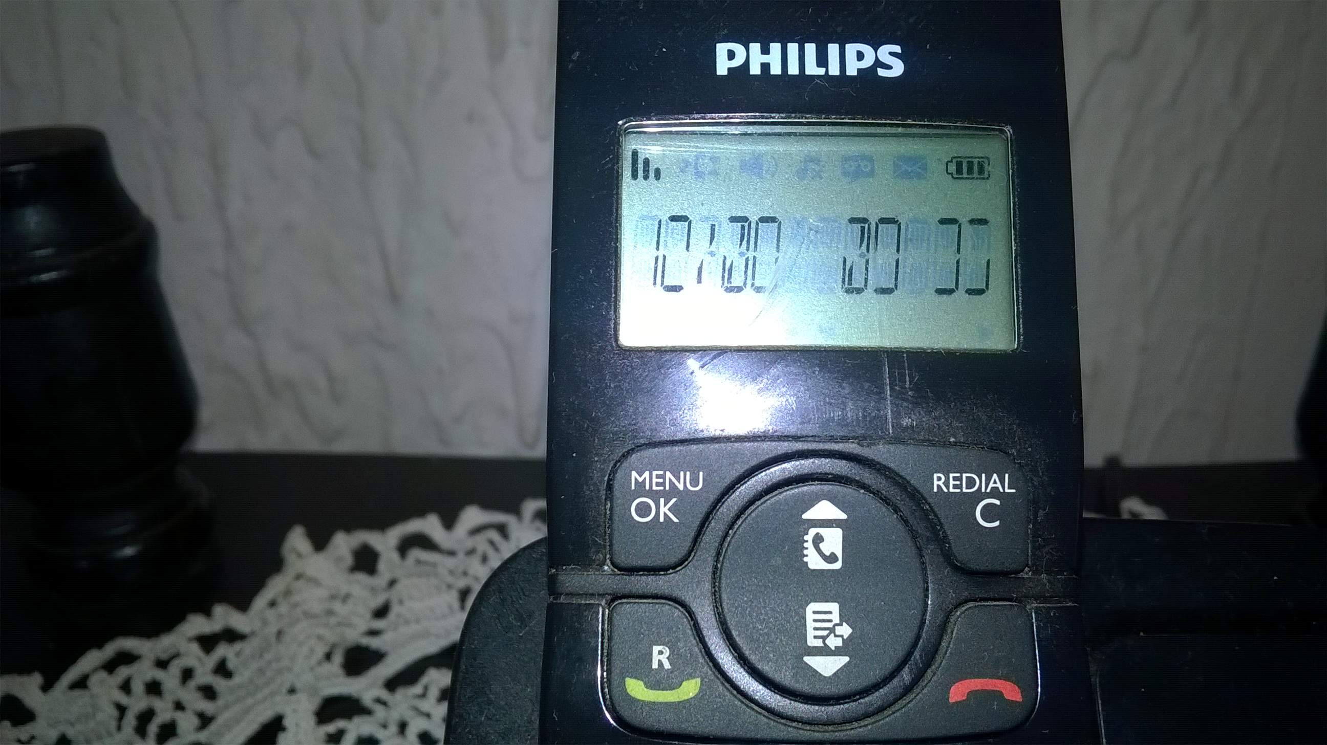

                            This is so typical to COGs (missing dead elements and ghosts):
