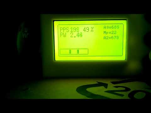

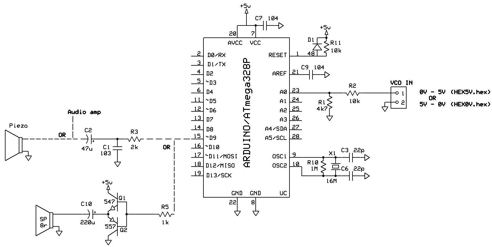

    This could be used as nice audio vco for various projects, of course; suitable for PI detectors.
    There are two versions of hex that i prepared; 0v to 5v at the input and 5v to 0v at the input.
    Most of the diy PI's we have here on forum will be matched with second; the 5v to 0v at the input version.
    At the output there is pretty linear 1 to 400Hz audio (on video is up to 300Hz). Can be filtered and amplified on many ways, i am offering only few simplest.
    I picked the range 1Hz to 400Hz because it do the job for me. But i could go up to 8Mhz range. Of course; wider the range = worse the linearity.
    Code is cleaned from LCD stuff, it is only what's shown on schematic.

    What you see on video is working version, with 1-300Hz range and 49% duty cycle.
    HEX files are modified; 1-400Hz range and 50% duty cycle.
    Also what you can hear on video is piezo output version. Which is bit rougher.
    8r speaker version is of higher quality of course. Very pleasant tone.

        Hello ivconic! I repeat your scheme. Question --- which fuses to expose? Thanks!
              Usually i don't mind the fuses, since i use Arduino platform to write the code.
              So fuses are default and Atmega works with standard bootloader.
              Also works the same without bootloader.
              However; your question makes sense.
              Lately i buy Atmegas from various sources and i noticed that those are coming with different fuse configuration!??
              So i examined those differences.
              This works for me:
              L 0xFF
              H 0xDE
              E 0xFD
              LB 0xFF

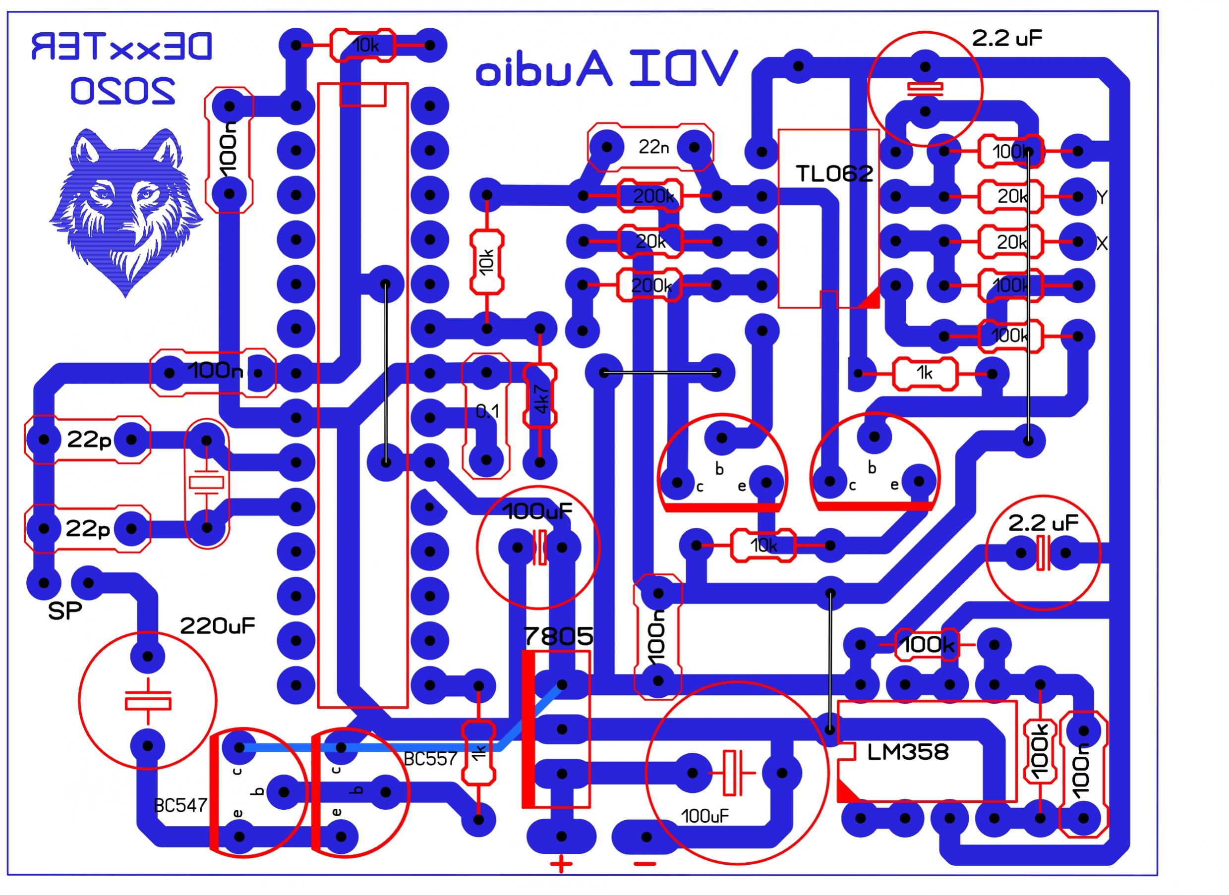

                What software you are using to draw pcb?
                Looks nice and interesting.
                  Thanks for the answer! I'll put it as you wrote. This is Sprint Layout, just the color scheme has been changed ...

                    Resistors and capacitors are of the shape and style i don't have in my Sprint Layout.
                    Is that custom library?
                    Where can be downloaded?
                      Makros.rarHere
