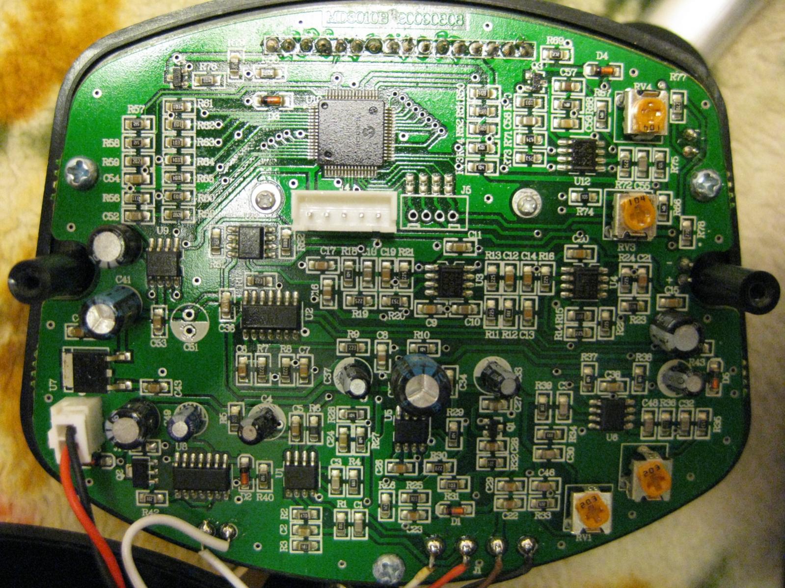

    It would seem the discrimination feature is a big hoax. It can knock out iron, but that's it. Only ferrous/non ferrous discrimination.
    All the other on screen features that allow user to eliminate targets going up the scale seems to be a hoax!!!
    Yet the PCB is full of chips as if to suggest that it is a good circuit???? Maybe it is good to play around with to see if it can be made to work correctly.

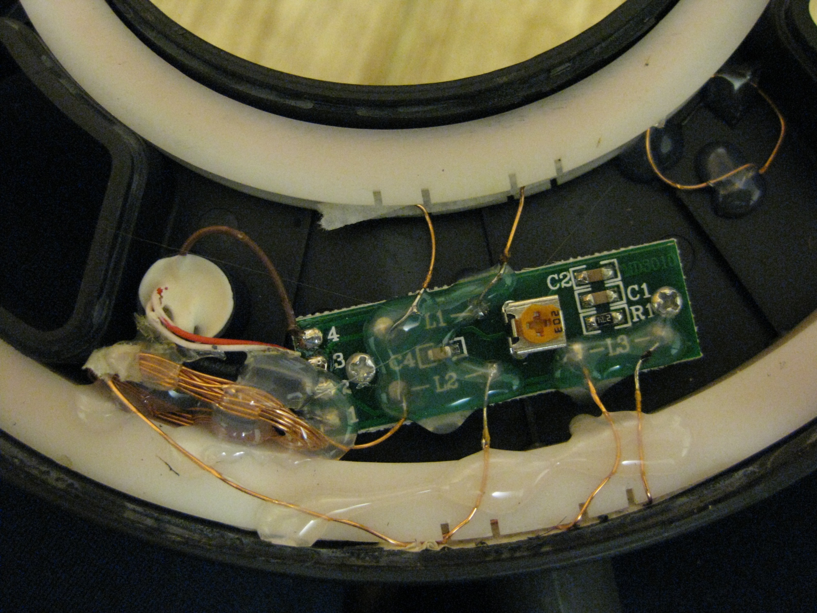

    The coil appears to be unshielded!!! Lord almighty.
      I notice a distinct lack of decent quality stable capacitors, like mylar/polyester film types, it's all ceramic. Maybe that's why it's junk, it's a copy of another circuit, but they haven't copied the ( probably matched / selected ) capacitor type. So its performance doesn't match whatever its copied off.
        There are film capacitors and ceramic c0g type which look exactly the same way as the regular smd cheap capacitors but offer same performance as film through hole type. No way you can tell by looking at photos but based on the price i agree on the low quality ones. Theres is absolutely no way this device be decently usable on the field. If i have to ship this the cost of the shipping alone will be the cost of device. I guess chinese have figured out a way to mass produce these at maybe 25-30$ a piece and produce milions of units. Expect to see a flood of posts on how to impove and fix these toys. Anyway on the positve side you can play with electronics and if you see the magic smoke you dont loose too much.

            FIRST THING YOU CAN TRY TO ADJUST THE TRIMMER POT IN THE COIL.

            What is the coil shield? Can it be corrected?

              One thing I have noticed from watching the test videos of the MD3010, is that is has an extremely SLOW response to a target. The target is way past the coil before it beeps, there appears to be a serious latency problem. If the two 14 pin DIP chips could be identified, then we could make some assumptions of the circuit topology. Anyone know the link to the schematic?
              The long delay and slow response might be caused by the micro, and poorly designed software, or by a ridiculously unbalanced, or bad coil. If you ask me, the coil looks very suspicious. The analogue part of the circuit and the hardware looks to be pretty decent, lots of opamps. So you would infer multiple channels, which would coincide with the notch features. The complexity of the analog circuitry does jive with the purported features, SO WHERE IS THE FATAL FLAW? MICRO? SOFTWARE? COIL?
              The analog part of the circuit might be a copy of some other well known brand.
              It is also strange nobody has investigated further. Doing some technical analysis of what's happening with this detector. Surely somebody out there has put a scope to this circuit. Suppose all it needs is a proper coil? How would you know?

                Un dip 14 pines 14016bg y el otro 1401 *, el * puede ser 3.

                              now pics archived. board and coil. thats all guys. i do not feel a hope that topickiller gives me pics
                              and part list. trivial cause - a beginner is not able to open the cover of enclosure and to do something.
                                Interesting that the coil has the TX on the inner winding, and the RX / Bucking coils on the large outer winding.
                                I guess the little loop on the TX with a solder joint is where the number of turns has been fine-tuned by joining a single turn extra in series.
