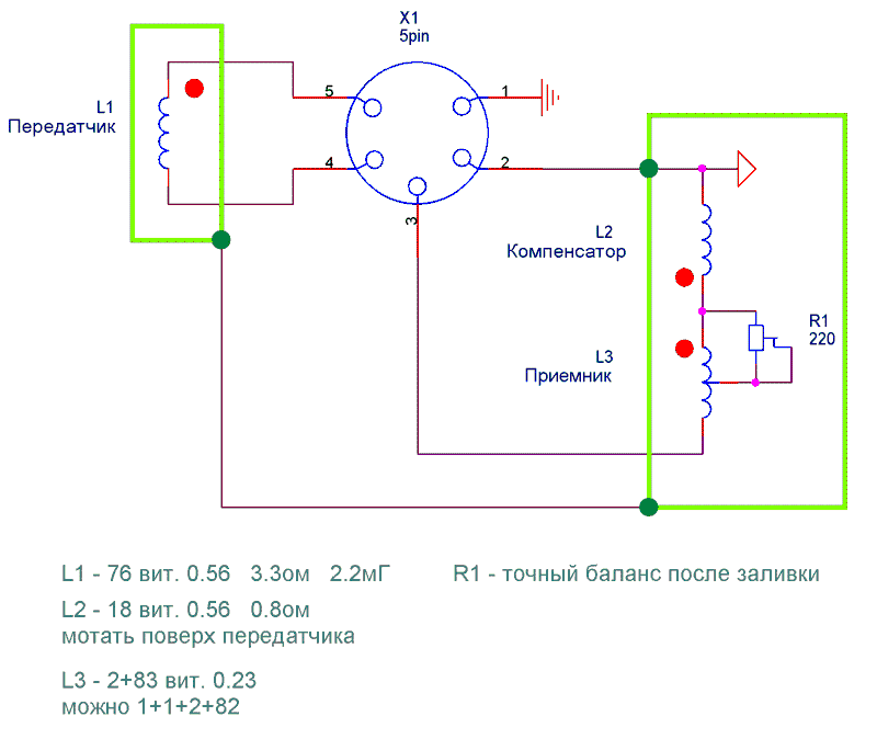

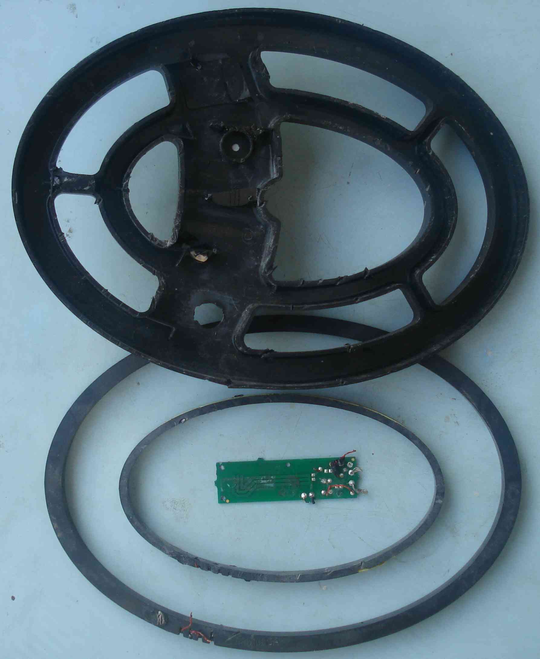

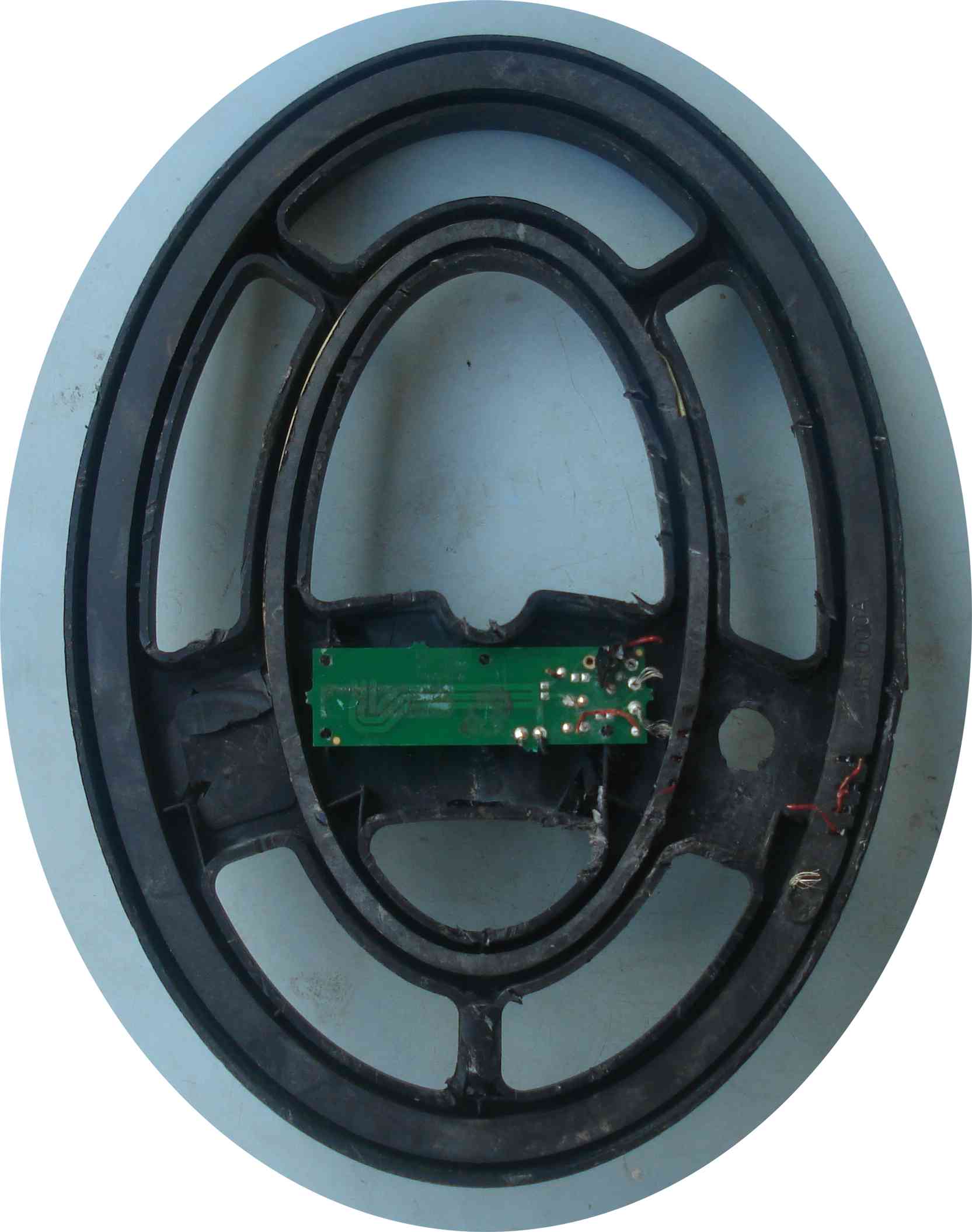

      Interesting that the coil has the TX on the inner winding, and the RX / Bucking coils on the large outer winding.
      I guess the little loop on the TX with a solder joint is where the number of turns has been fine-tuned by joining a single turn extra in series.
      i guess all standart but RX bucking coil done inside of TX. some russians do that way.
        That coil looks a mess. L2 is hilarious. I don't think these guys were working with an optimal coil design. It would be interesting to see if a more conventional coil topology (a DD type search loop, for example) would solve some of the issues with the slow response and discrimination problems. I find it very strange that nobody has tried to replace the coil as a first step to try to solve the issues with this detector. That would be my first plan- try a standard DD coil.
        The circuit on the pcb looks to be quite sophisticated for just a toy. Yes it has the performance of a toy, but the circuit may be quite good.
        The problem might be in the stupid coil.

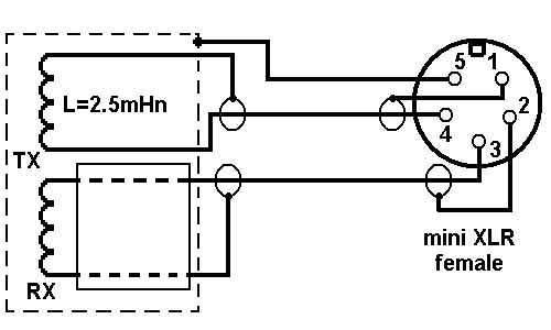

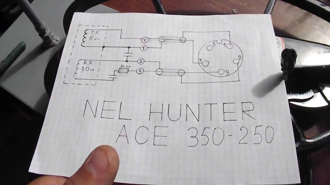

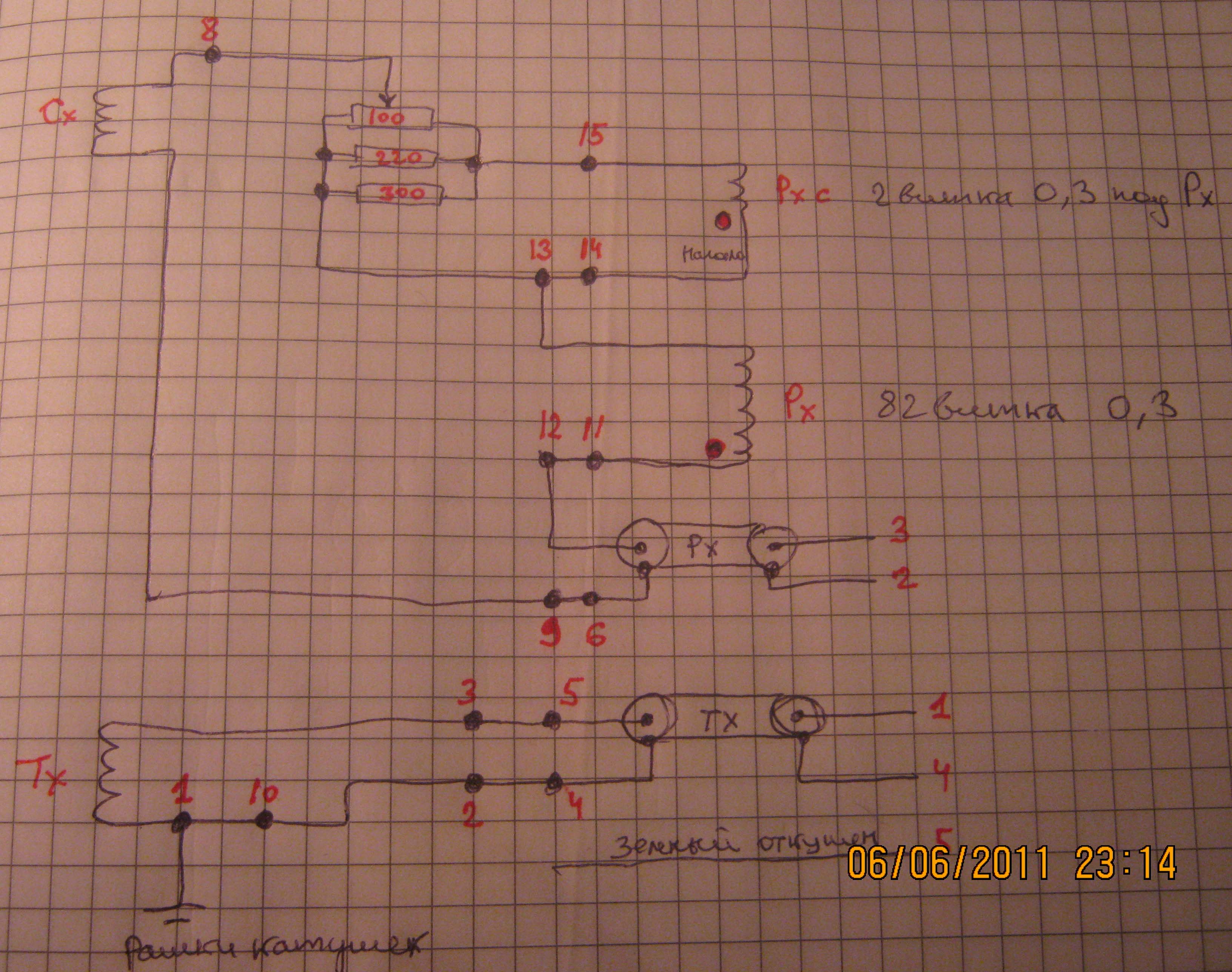

                  First, you must determine the Tx operating frequency, and the Tx coil inductance/resistance on the stock coil.
                  Then determine the Rx tuned resonance(if any), and the Rx inductance/resistance.
                  If possible you must scope the Tx and Rx at its quiescent state (no target), to see what you see.
                  Based on this information and data collected, together with reverse engineer of the scheme of the front end, you can determine if the stock coil is doing its job properly or not, and if the front end of this detector is a feasable circuit.
                  You can build a DD coil to fit the front end of this detector for better performance if you think that is possible.
                  Seeing a bundle of wire (L2) just flapping in the breeze on the stock coil, with Rx and Bucking coil on the outside and Tx on the inside, gives me pause.
                  I think the response can be made a lot sharper with a DD coil or a standard concentric. But who knows??, maybe I'll get one just to tinker with for the christmas blues. It may just push me over the top!!!!

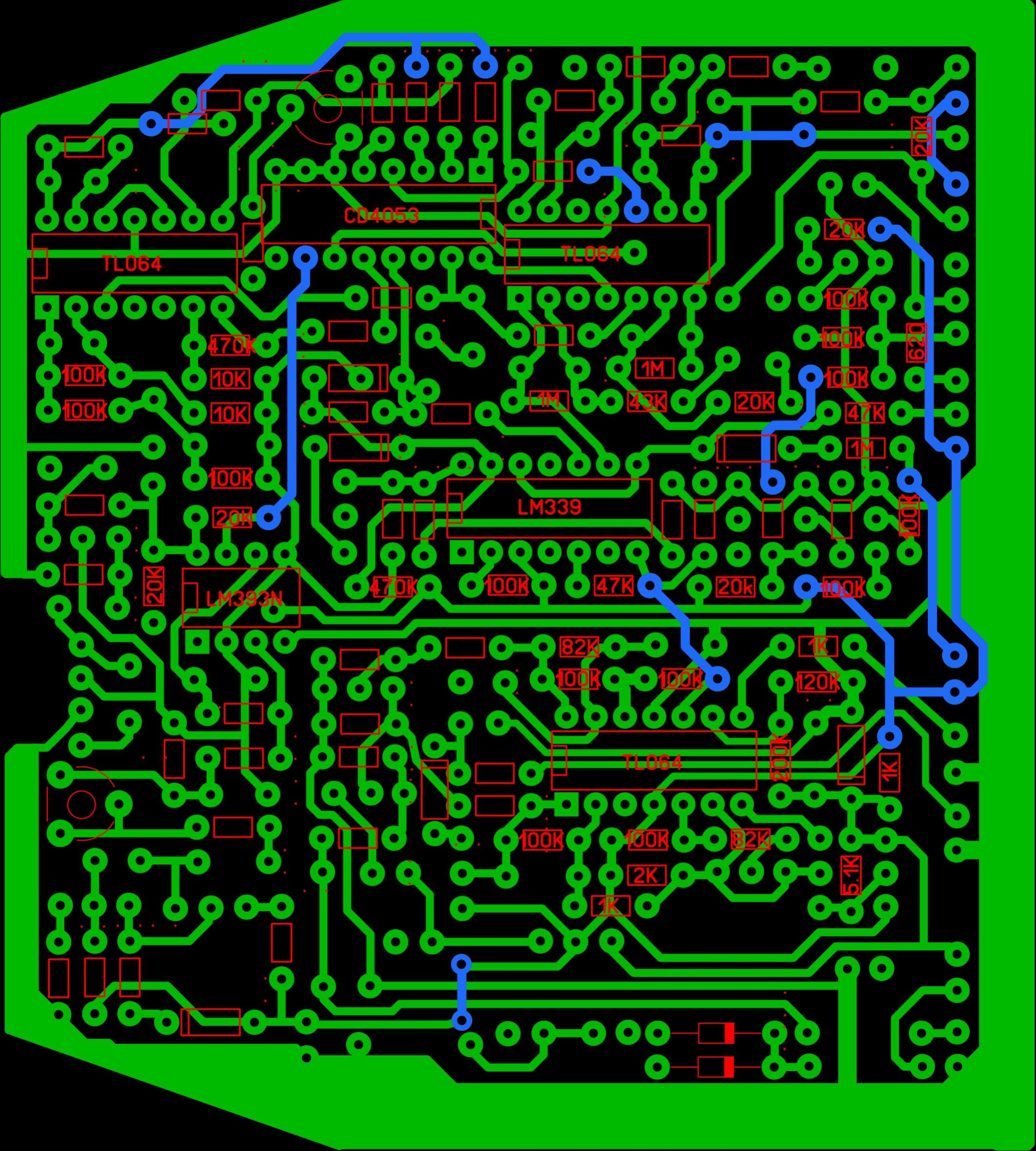

                            Oh, I tried but nobody help me. I draw complete PCB of GC-1023, with all componenets. Only missing few top side track I could not resolve from the photographs.

                              If the problem with the MD-3010ii is with the software, then there is nothing really that can be done about that.
                              Perhaps the micro can be cut out of the circuit altogether, and make the thing totally analog.
                              I still maintain that the pcb looks pretty complex for such a poorly performing circuit.
