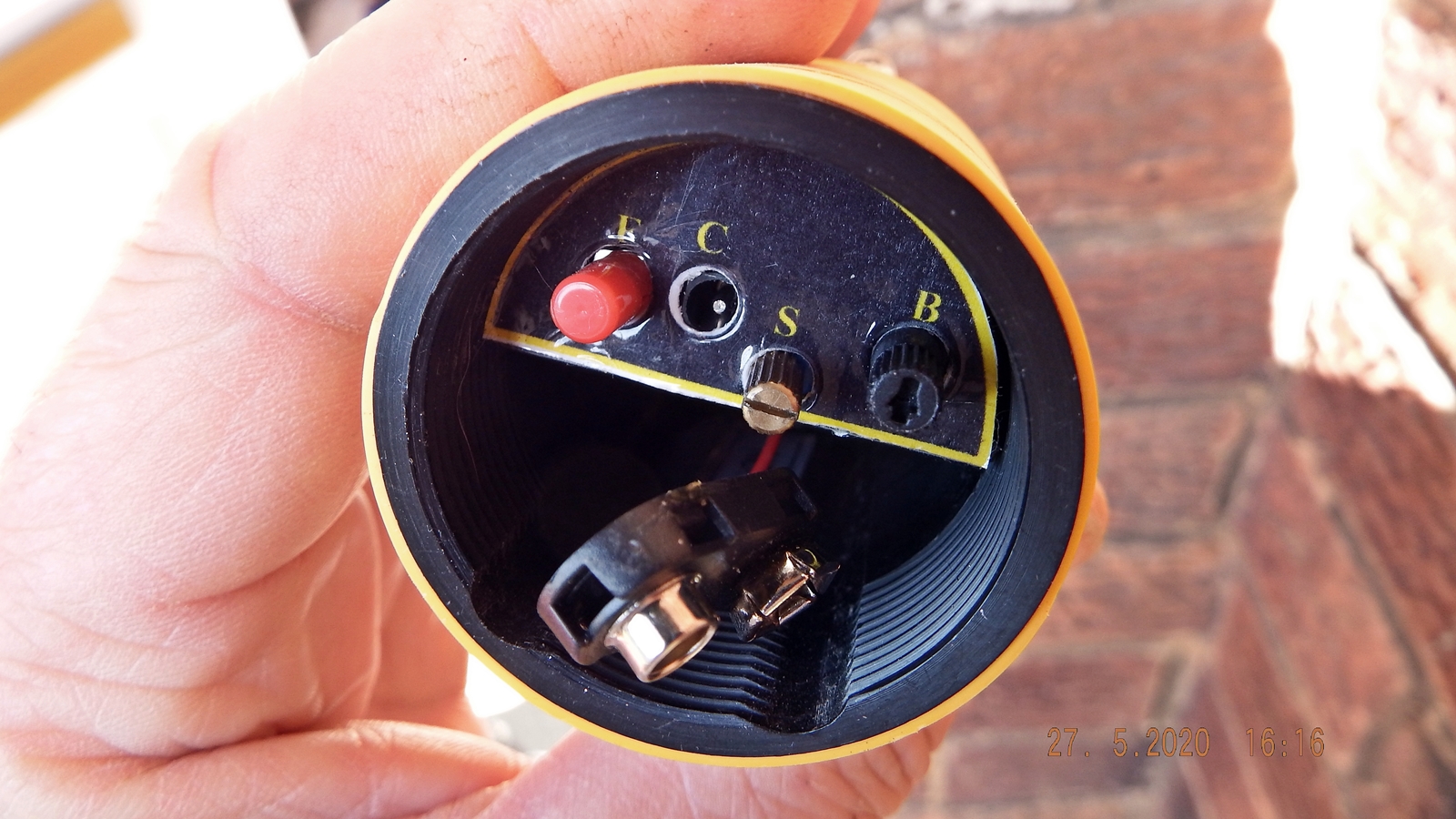

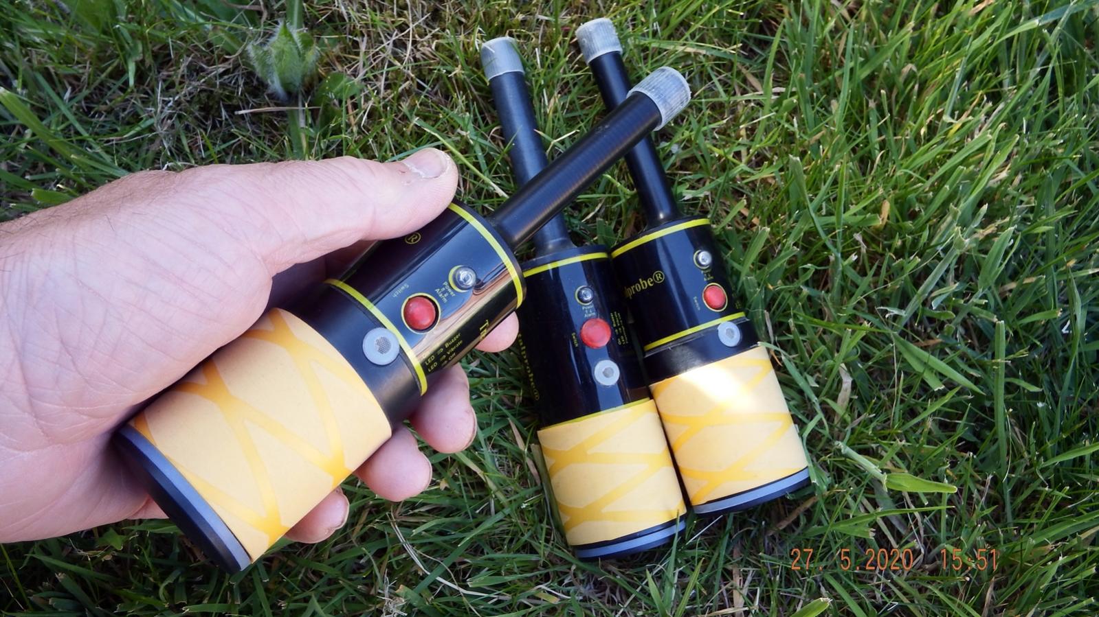

                      Bought the pointer on the 23 May delivered today to the UK from Bulgaria all safe and sound. Thought it was kit i had to build but built already which is great. Great bit of kit, works great, now to put a casing around it to. I was wondering if the casing of an old garrett type pinpointer, may be a Chinese cheap knock off would be suitable, anyone know the internal sizes. The board diameter of the new hobby pin pointer is 27mm wide and 64mm long plus the battery to fit behind.
                        i just bought one last night for myself. hopefully i can fit it in one of these crap pinpionters that i have. or like you say. one of them cheap Chinese GP pointers.

                            On the PCB put a dob of hot glue on the battery wires to take the strain
