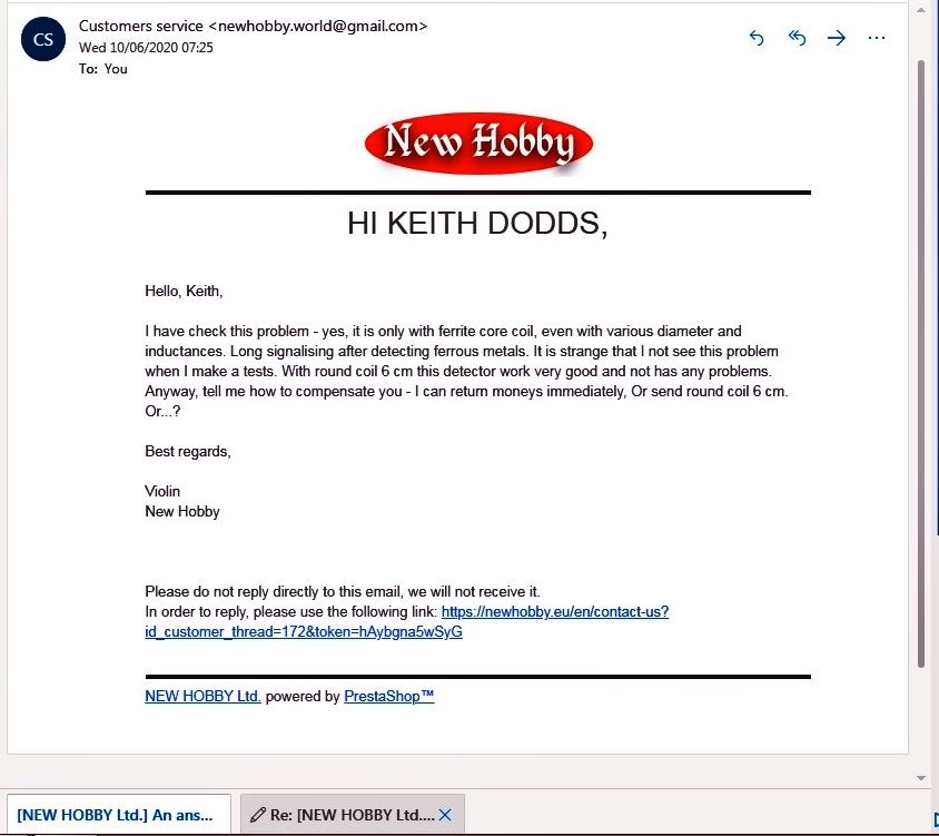

    i got my Discriminator Pinpointer PCB in the post today. can i ask you. does yours allow you to switch yours off.? the one i received. if you press the button it makes the beep/bloop noise but it does not mater how many times you press it, it is still switched on. if you leave it to stand for a few minutes it gives you a beeping warning that it is left on and not in use. also sometimes the blue light just stays on plus bleeping for no reason till you press the button to stop it. i am pretty sure it is not meant to be doing this. just thought i would ask you about this with you buying the same thing.

        what about the random flashing and bleeping. does yours do that as well. just making sure in-case mine is faulty in that way.
          I found this but if you are in an area surrounded by metal draws and cabinets or near large metal objects it is erratic but away on its own its ok. i found when i was testing it on my bed it reacted to the springs in the matteress.
            as soon as i plug the battery in to mine, it just starts beeping like mad with the blue light flash as well, until you press the button. well that was a waste of $29.00

                          i sent a message to the sell about the problem with the pinpoint. i got a reply back today.....
                              I sent New hobby a email and said i had the same problem as Keith777. They replied and said they will send out a 60mm round coil which works much better. Today i received the coil with in a week from Bulgaria all the way to the UK. in my opinion a good service no problems, fully recommended for anyone dealing with New Hobby, will buy again good little device, now to build a casing for it.
