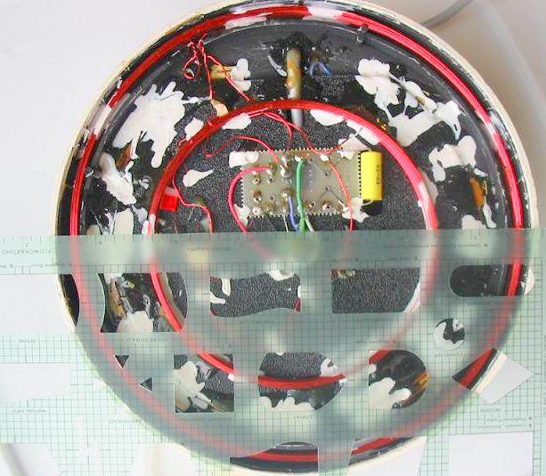

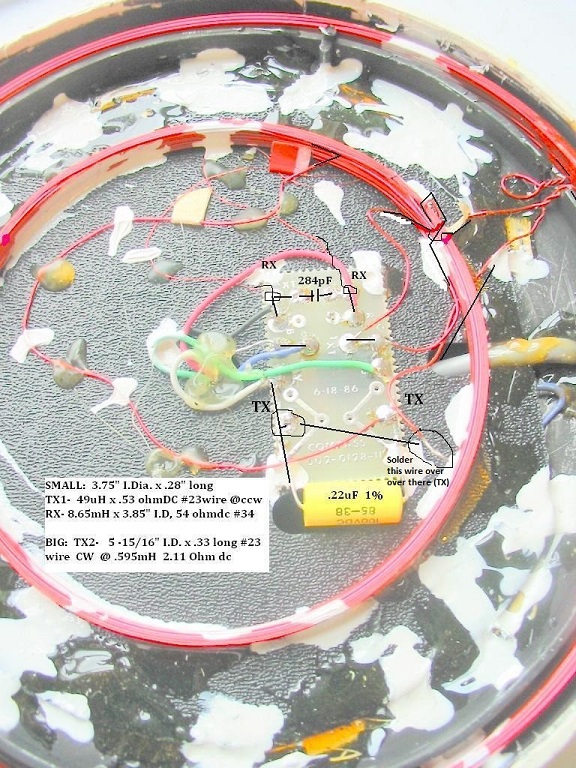

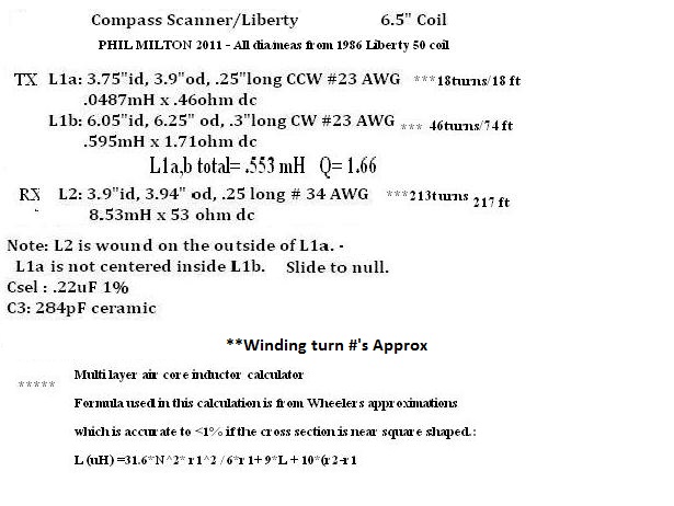

      I found the coil data, very detailed information about the coil and also some pics.
      So it is feasible to build the circuit. I also have the TX and phase shift circuit working good in ltspice.
      Maybe I'll continue on a bit with further simulation of the preamp and filters. Try to work out any bugs in the schematic.
        The manual says it's a 13.77kHz detector, and if I work out the resonance of the coil based on the information provided by the coil data specs shown above, it's bang on.
        O.595mH with 220nF capacitor works out at 13.8kHz.
        So that verifies that it's the correct coil data.

              The coil photos look interesting, the ratio of the RX coil diameter to the tx coil diameter just shows that a RX coil could be of any diameter, provided that it is nulled out by sufficient turns for the feedback coil.
