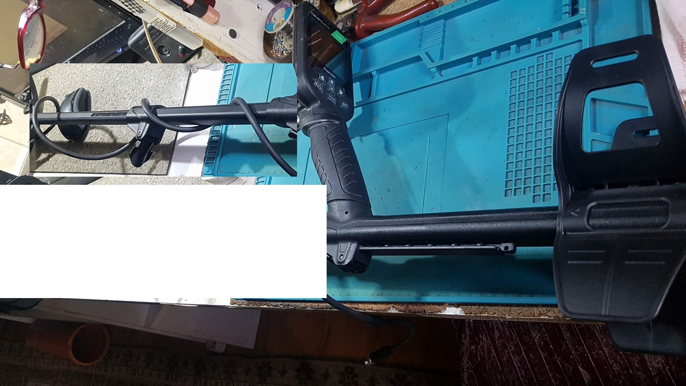

    The quality of the plastic, the feeling in the hand as if it is very "soft" and as if it "sticks" to the hand.
    And at the same time very rigid, strong and resistant.
    It is not a round stem, but has a "design" with several angles, preventing rotation on the axis. everything fits perfectly.
    Superior design.
    The only thing that spoils the whole picture is the vertical box of the machine with high connectors.
    If they had made an "S" design in that part of the handle, everything would have been even better.​
    When I say "best ever"; first of all, I have an image in my head of removing the detector box and use the rest entirely with another detector mounted under the elbow part.
      I "butchered" the image and moved the lower part of the stem to the right place, where it would be appropriate.
      And then it remains only to make the box horizontal.

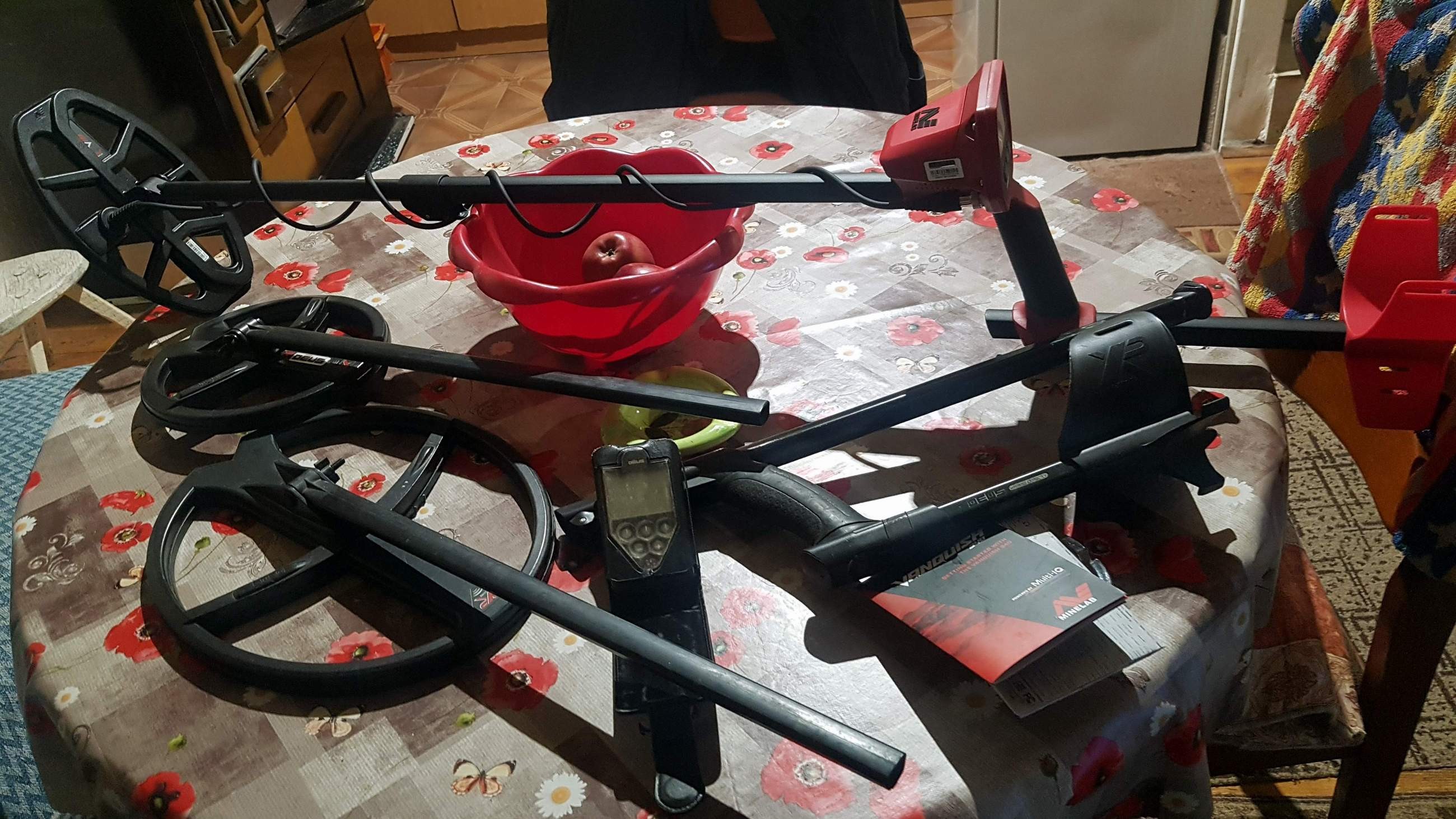

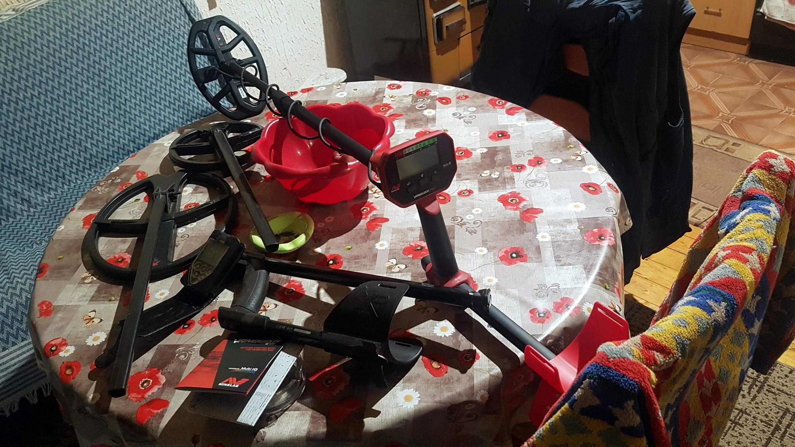

          Simplex has gone and Vanquish has come and it seems to me; it will stay with me for a very long time! Like Deus! Double trouble!
          I unboxed it a while ago and did some preliminary masking tests in the room...fantastic! Exactly what I was hoping for!
          With a small note; if the coil moves more slowly over a masked target; "error" in sound and VDI practically does not exist!
          I will say this freely; in this aspect it is clearly better than Deus1.
          If the weather is good tomorrow, if there will be no rain; I am going with it to a real field where the problem of target masking is very present.

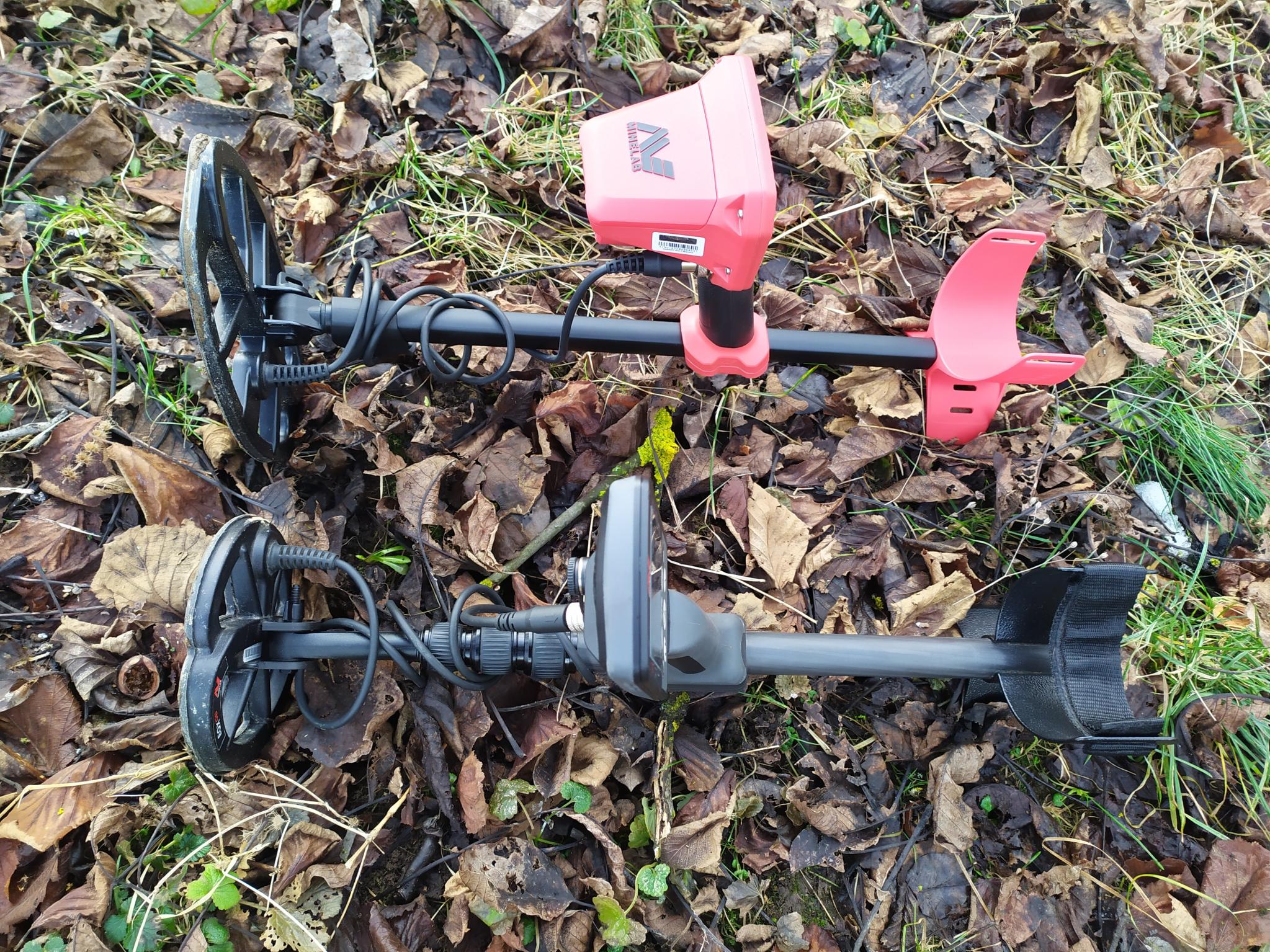

                            This is a field I have been visiting for about 30 years. Although it is not easily noticed in the video; it is a very steep hill, covered with forest, the ascent is very tiring, ankles hurt easily.
                            At the very top there was a smaller fort that was probably demolished in some way and all the material was thrown in all directions down the hill.
                            It is also not easy to notice in the video that the surface is not just soil.
                            There is already a layer of over 1m of earth mixed with the material from that tower, a lot of crushed ceramics as well as too many "hotrock" stones.
                            All this was covered by dry leaves and new grass. It is one of the most difficult terrains (both for detector and human) that I have in the area.
                            Suffice it to say, I haven't found anything there with Deus in the last couple of years. I've been searching all day and I can't find a single coin.
                            Deus behaves extremely "neurotic" there, it constantly produce chatters that are so frequent and strong that no useful signal can be discerned between them.
                            The worst possible conditions and terrain that has long been "desolated" and for several years no one wants to come there anymore.
                            Ideal for a real test of a new detector.
                            And this is where the Vanquish performed very well. Pretty calm. There were almost no false signals.

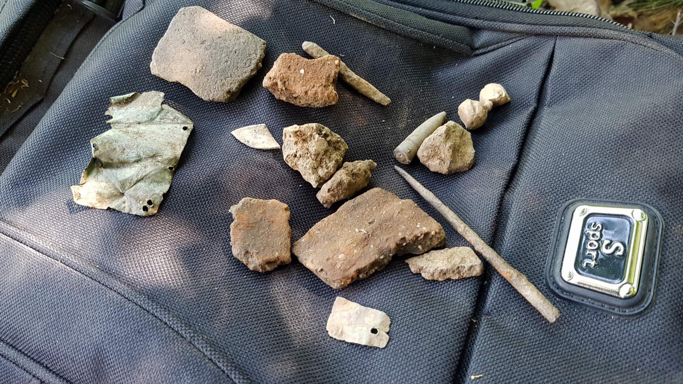

                            I wasn't very happy there today. Barely three rotten coins. And a dozen worthless metals.
                            At the very beginning of the recording, the ML340 detected the worst possible finding; slag, something that is too much present on that field.
                            What is slag? Waste, which is created due to melting and excessive temperature exposed to metal, stone, wood... usual from such ancient buildings.
                            Or it is a product of some purposeful metal melting. So the debris simply spilled down the hill.
                            The difference between slag and ordinary rusty iron is BIG in the eyes of the detector!
                            Because slag produces a signal similar to non-ferrous metal when it gets under the middle of the coil.
                            I discovered a good method to identify slag with the ML340.
                            I set the "Disc" to "All Metal" (no notch) and move the coil a little wider left and right. And you can clearly hear the lowest tone from the sides and the high tone only in the middle.
                            Slag is a very deceptive target for Deus as well. And even worse for weaker detector models.
                            And all the rest of the unwanted signals, especially "hotrock" stones have a low tone response and the differences are only visible by the VDI number which goes more or less in the minus.
