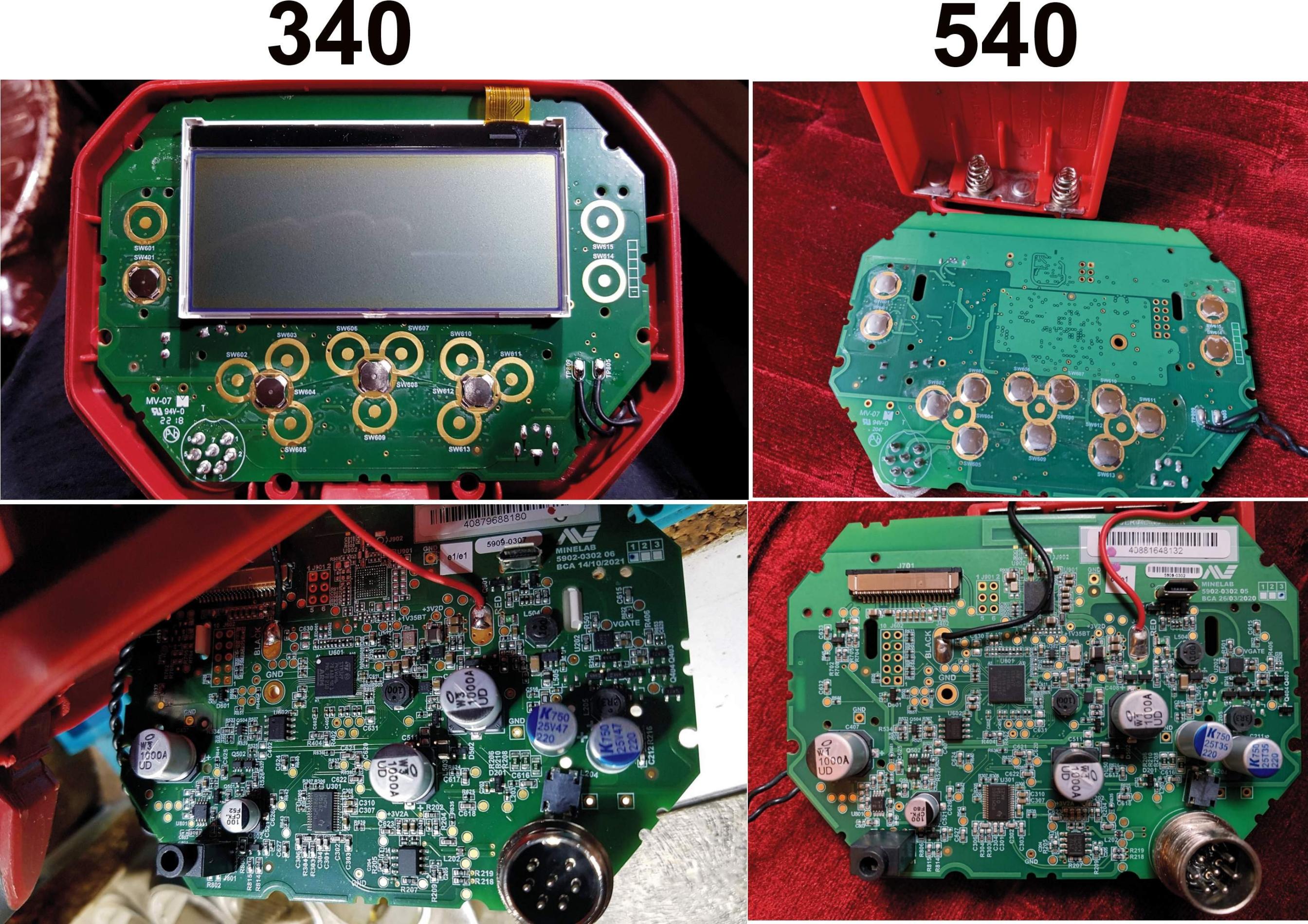

          Minelab does not deviate from its old habit of using the same pcb for the whole series of models.
          340 and 540, 100% identical pcb, the 340 does not have a "radio chip" and probably the upgrade to the 540 model is disabled.
          Everything else seems identical to me.

          I didn't even try to update/upgrade because the USB is deeply "hidden" in the box, but in advance I don't think it would even work.
          They are not stupid in ML.
          They probably adjusted some subtle little thing to make it impossible.
          Or is the STM chip such that it has an encrypted part of the flash in which the type, ID and permissions are stored...

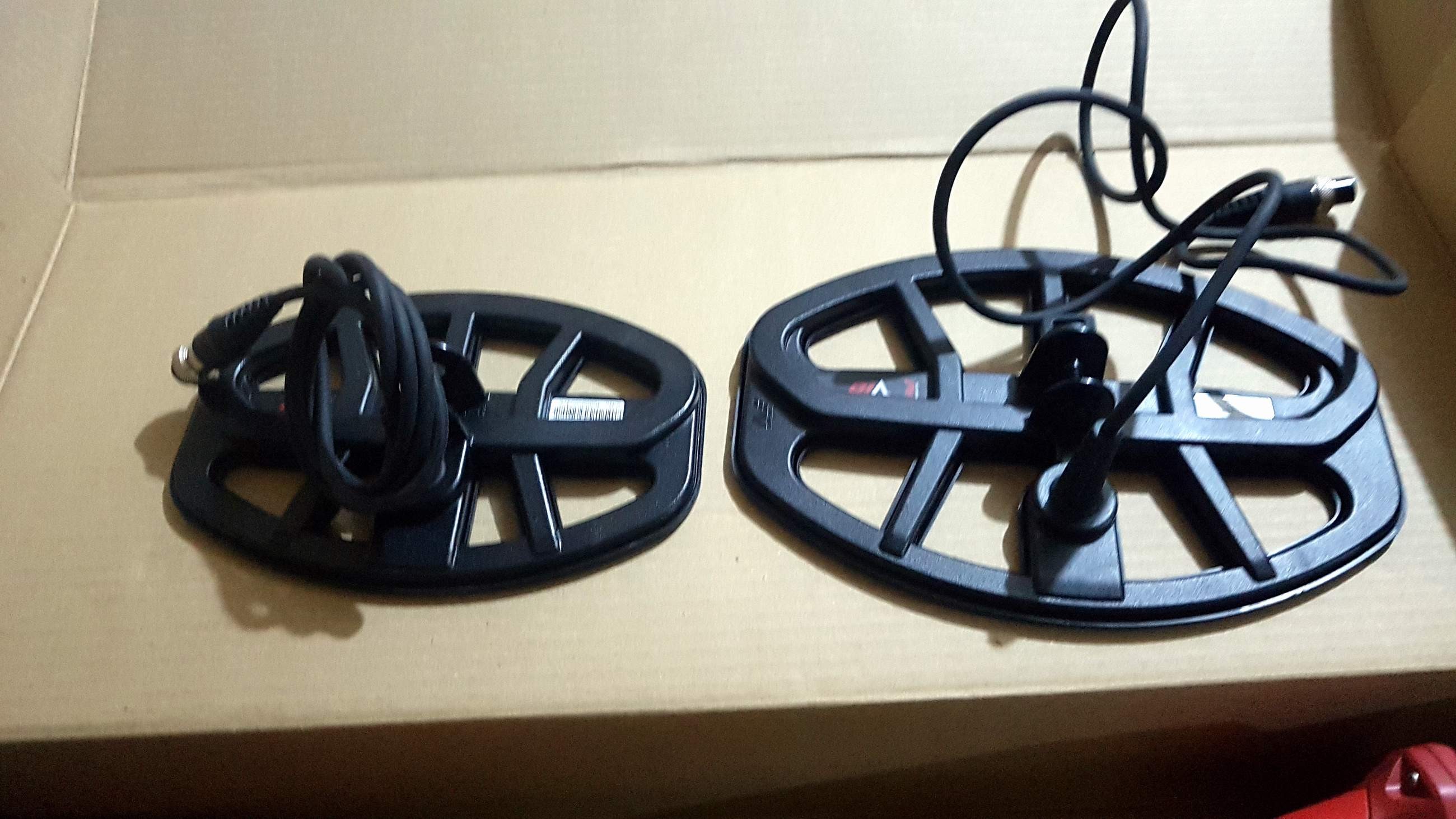

                    Got smaller coil too:
