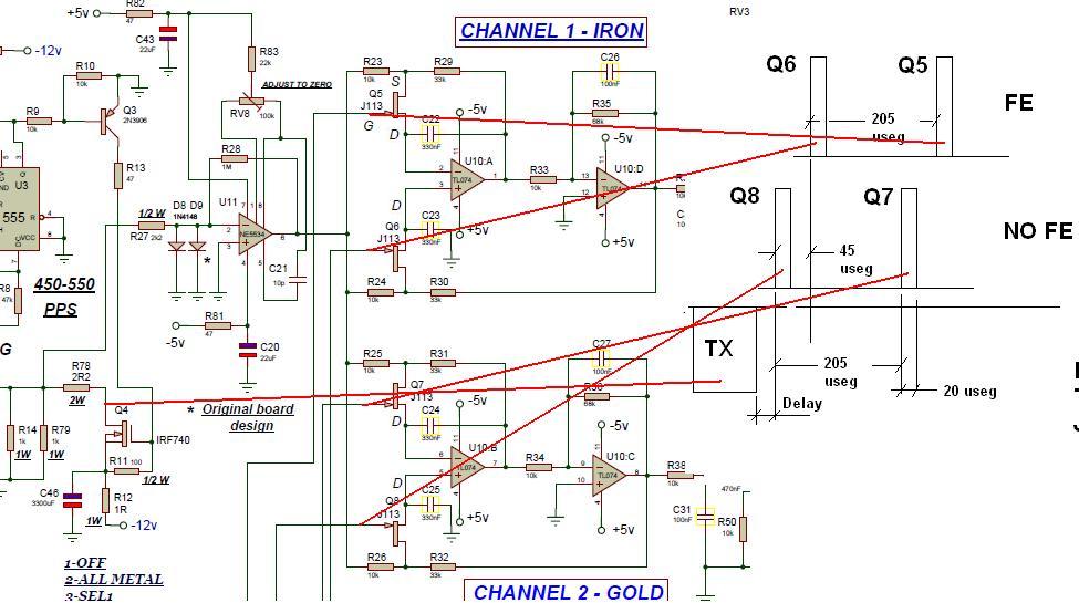

    U10: B and U10: C are part of the integrator, their operation was discussed in a forum.
      Thanks Jose, took a look at the link you provided. What I don't get I think are these 4538's. And what kind of switch is SW1-C?
        The 4538's are CD14538. They provide the the pulses to switch the jfets.

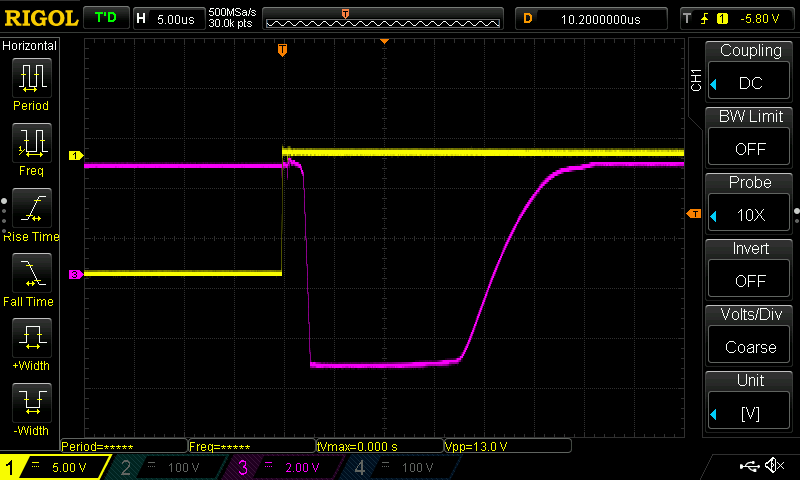

            What sequence are the jfets switched in relation to the clock pulse?

              Attached are the time sequences, taken from my built GS4.
              The separation between channels of the GS4 is 45 uSeg.
              The SW1-C switch widens the separation between channels, and modifies the GB settings and the responses to different objectives, what I can remember is that it had the mission of eliminating the soil, but continuing to detect certain types of coins that exist in it, UK, I can't really give more details, because I don't use it.
              In my opinion, you can build the GS4 without the iron channel, in this case, it would not have GB, but a sensitive detector, which can operate with a minimum delay of 15 uSeg.Click image for larger version

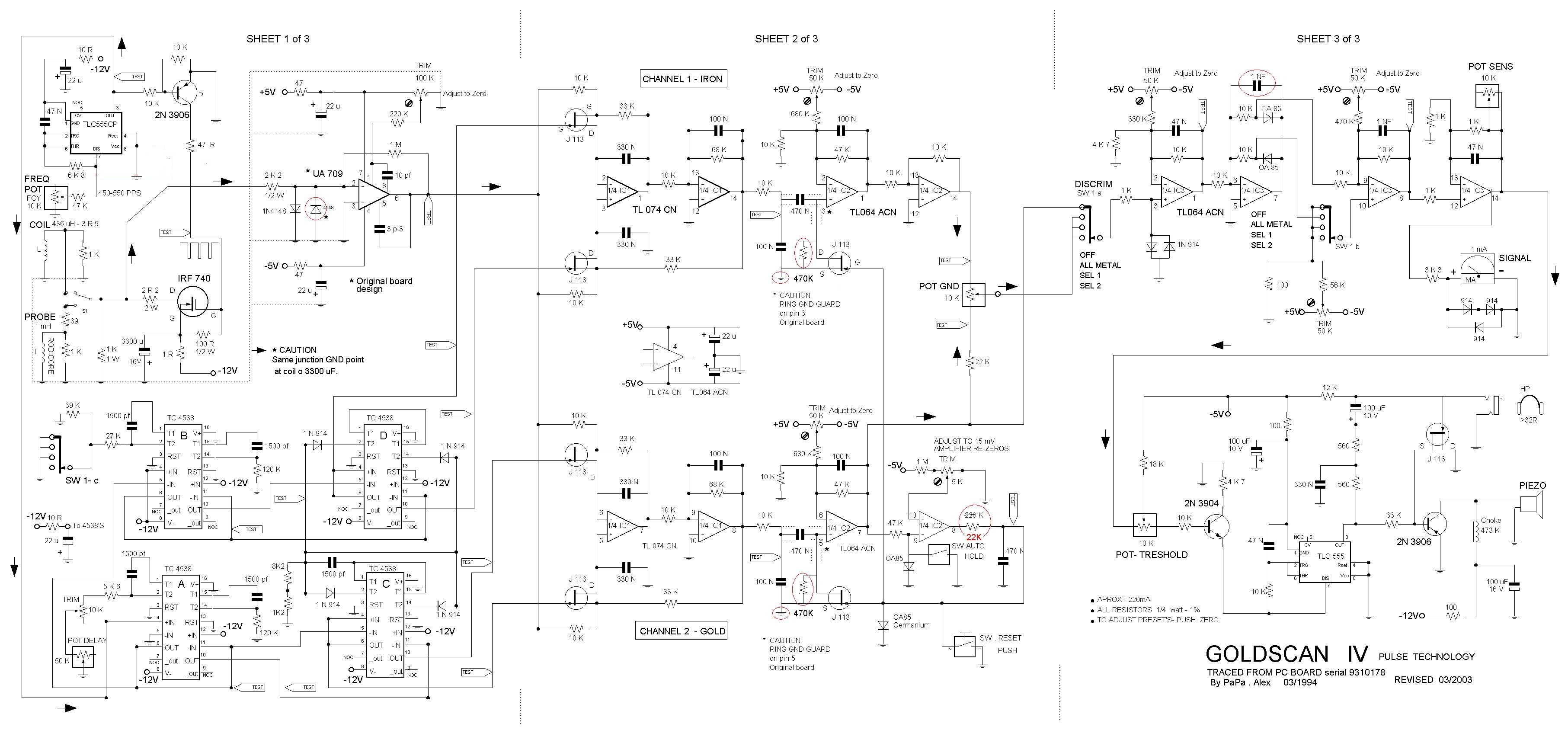

                Thanks for the info. I'm trying to build the timing circuit, but with no success at the moment, need to recheck the wiring. My dad has a Deepstar which was built for him by Eric many moons ago, nice depth, great machine anyhow he let me take a look inside and it has only two 4538's. He also has a Surfscan another of Erics an that one has no mosfet and again has good depth, not quite as deep as the Deepstar but not far off.
                You say you built the GS4, what schematic did you build it from?? I'm looking at a circuit reversed by Alex, and I've noticed the pre-amp/op-amp is not the same as the original board and is missing a cap. I'm in the process of redrawing the circuit in Altium, I need a working machine to test since I have some ideas of my own.

                      I built the GS4 with this attached schematic, as far as I know, it has no errors, the front end was modified by better integrated circuits, there are several possibilities, the 5534 would be a good option.
                      In red it indicates, the mods, that worked well, as far as I can understand.

                        Hi Jose, ah yes I found that diagram, in fact I have several versions of it. I also have photos from here of the front and rear sides of the board. Now, assuming those photos are of the original board, then both diodes connecting to pin 2 of the 709 are incorrect as shown on the circuit diagram you linked to. From the photos both anodes actually connect to pin two, and this is shown in later versions of the circuit diagram. These diodes have been bothering me because I read an article by Mark Stuart which is floating around the net and he describes the purpose of diodes in a similar configuration to these in GS4 and he says:
                        Diodes D1 and D2 clip part of the
                        coil voltage passed via R2 and so limit the voltage
                        swing which is passed to the amplifier IC3 to one
                        volt. The diodes are of different types because D2 has to handle
                        only 50mA during the time that TR1 is turned on, whilst D1
                        must handle 3A peaks from the coil as TR1 is turned off. This
                        clipping only affects voltages from the coil above one volt, it
                        leaves the low level area of interest completely intact.
                        He says it doesn't effect the signal. I'm no authority on this so don't know the significance of these diodes being incorrectly placed. Maybe Eric would cast some light on this??

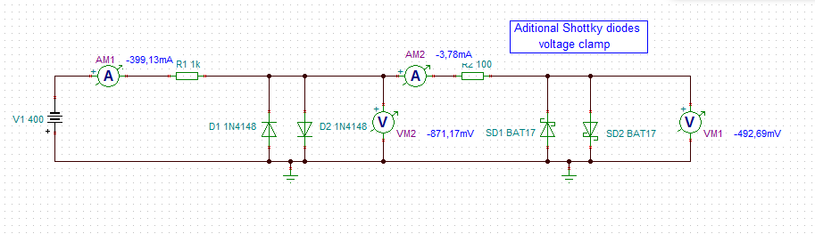

                          Hi Paul!
                          For absolute safety i use double stage clamp with traditional 1n4148 + second stage with Shottky Bat15 diodes. Bat15 has a low forward voltage 0.25V at 10 mA. This simple solution also helps to reduce op-amp recovery time, a little bit.
Name:	Double stage diode clamp.png
                          *In second stage 100 Ohm SMD resistor may act as fuse if one 1n4148 will open.

                            Hello Paul.
                            Somewhere in the forum this topic of diodes is discussed, but I don't remember where.
                            What I remember is that in the original GS4, the diodes are installed in the same direction and that happened by mistake according to Eric, but fortunately the arrangement did not affect the proper functioning of the equipment, because it suppressed the return pulse.
                            In my homemade build of the GS4, the diodes were installed as shown in the diagram uploaded before, and I did not have any problems.

                              Jose, ah I see, yes that explains it. I have them diodes installed as per the diagram, but will be reversing the one diode today. Well actually I may leave it for now and change it when I've tested the circuit to see if there are any performance issues.
                              I'm very happy today because I have finally got the timing circuit to work after finding a fault. So I can now make progress.
