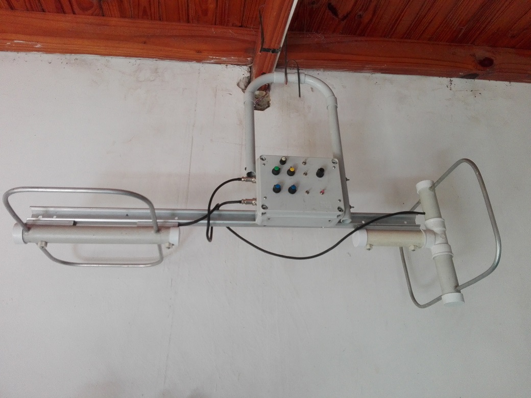

                            My TF900 project
                            The selector key was replaced by individual lever keys.
                            The reset button was adapted to an optocoupler, because the cables introduced a lot of noise.
                            It seems to work well in the backyard of my house.
                            It is sensitive, but if the gain is increased too much, it becomes mechanically unstable.
                            No field tests have been conducted yet.
                            I hope to carry out more tests in the next few days.
                              nice project.
                              the cable to reset knob is shielded one. also aluminum housing is connected to ground and by same way shielded.
                              thank you.
                                Perhaps because the box is made of plastic, and does not have any shielding such as graphite. The handle of the support is longer and the cables are longer.
