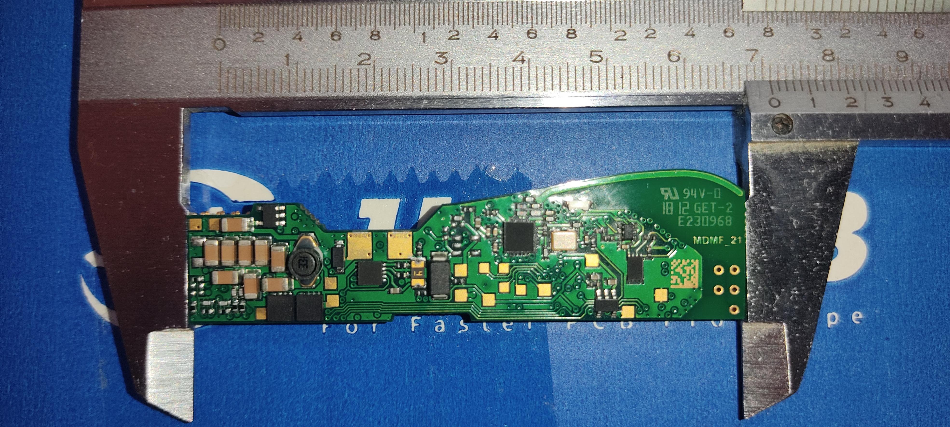

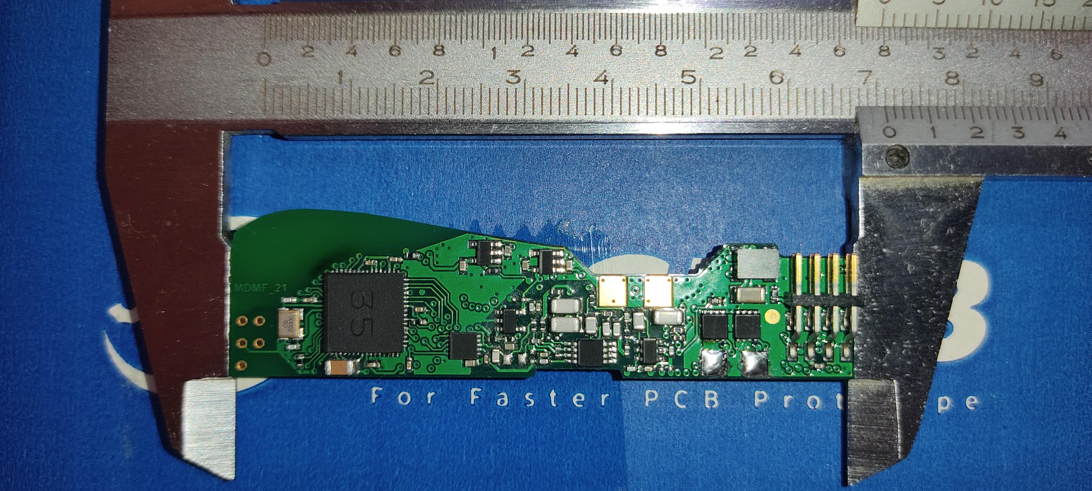

      Today I bought a coil X35 for testing and measurement so I'm attaching some photos for now. I will add detailed information and photos about the measurements today or tomorrow. If anyone has any questions about the measurements then me.

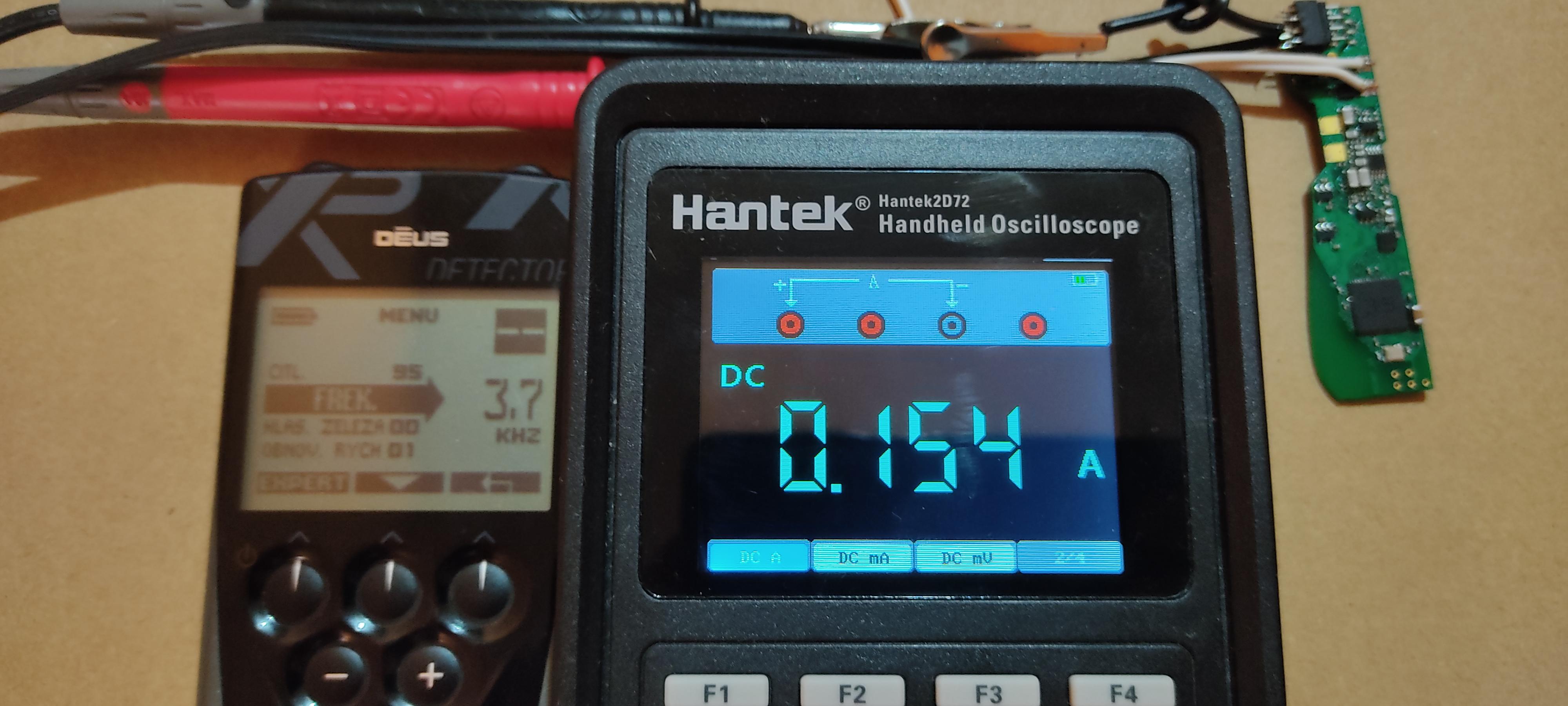

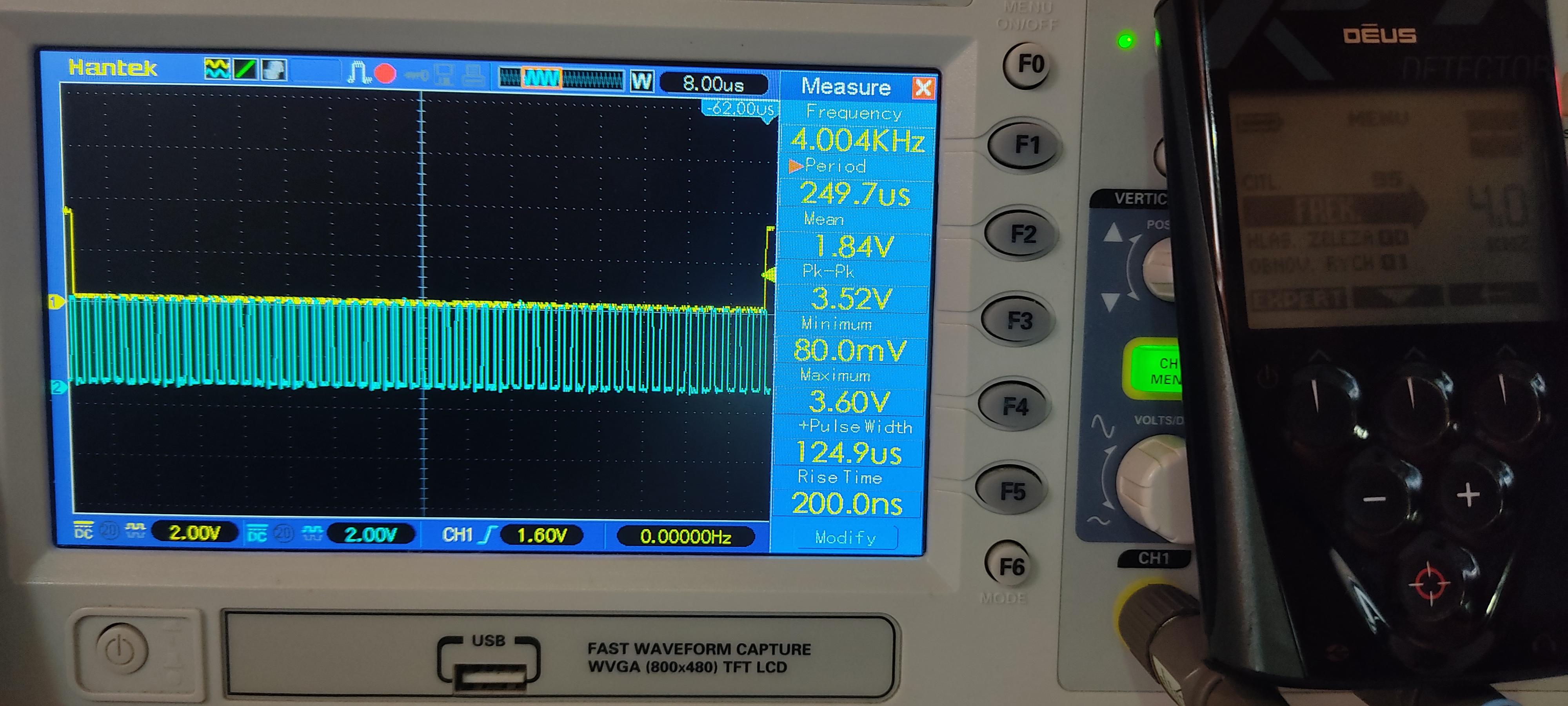

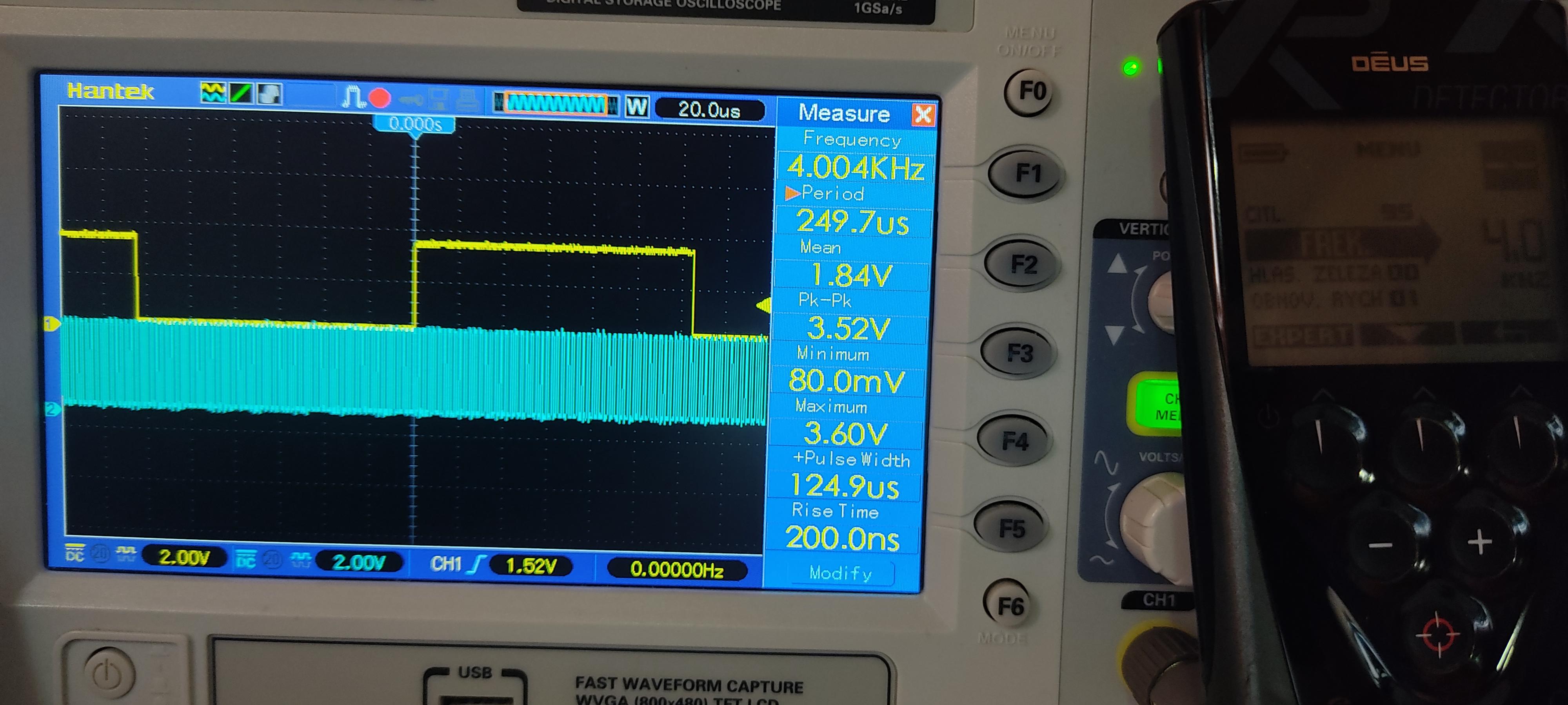

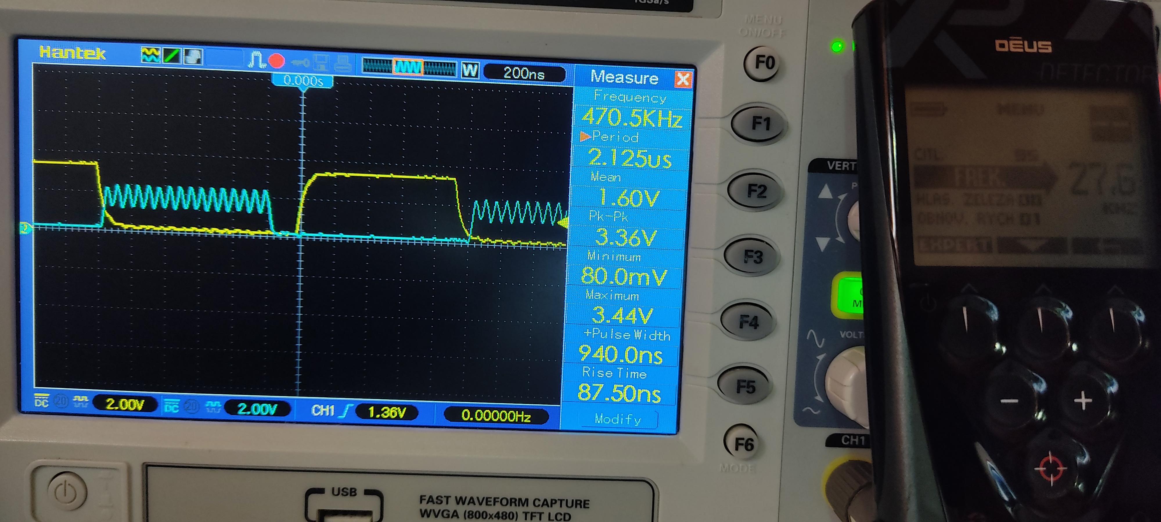

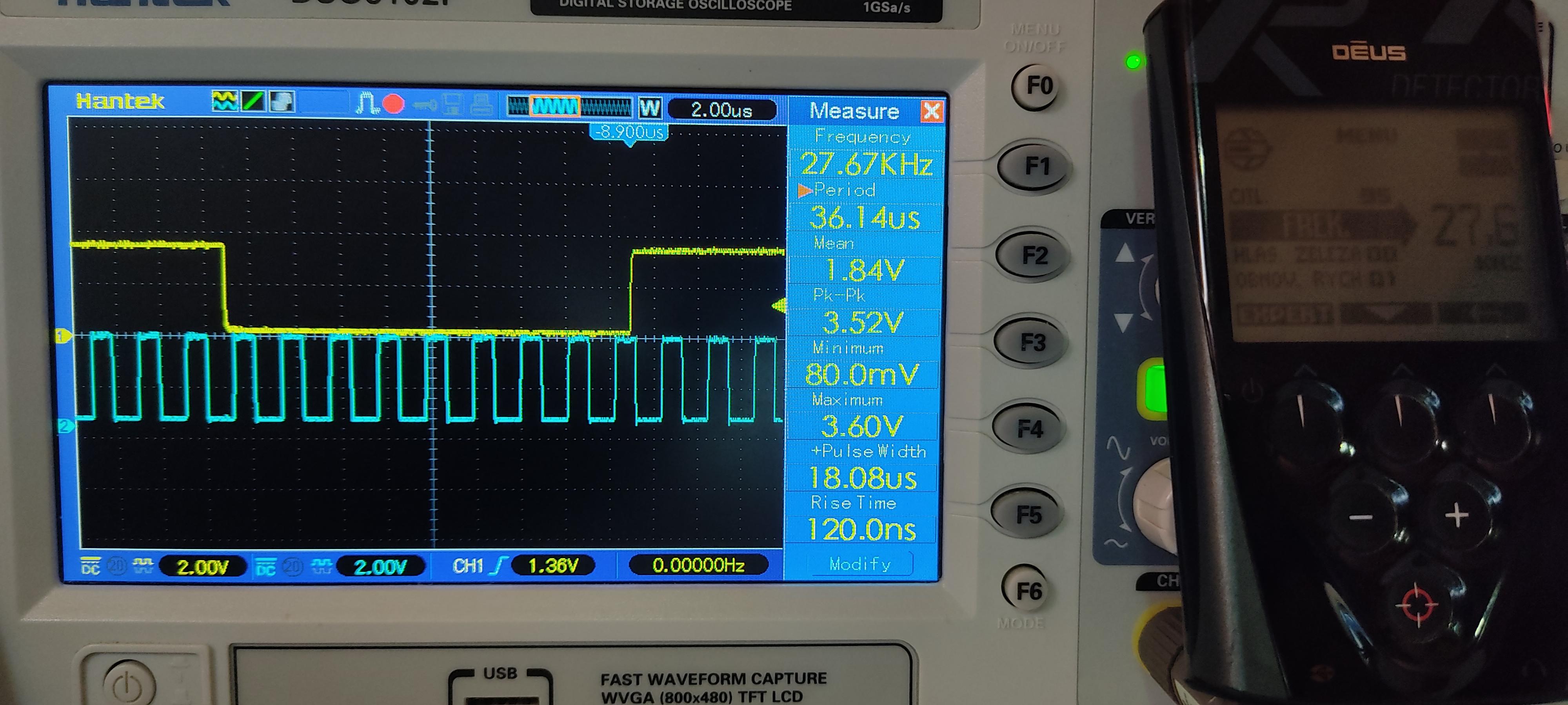

      • #93

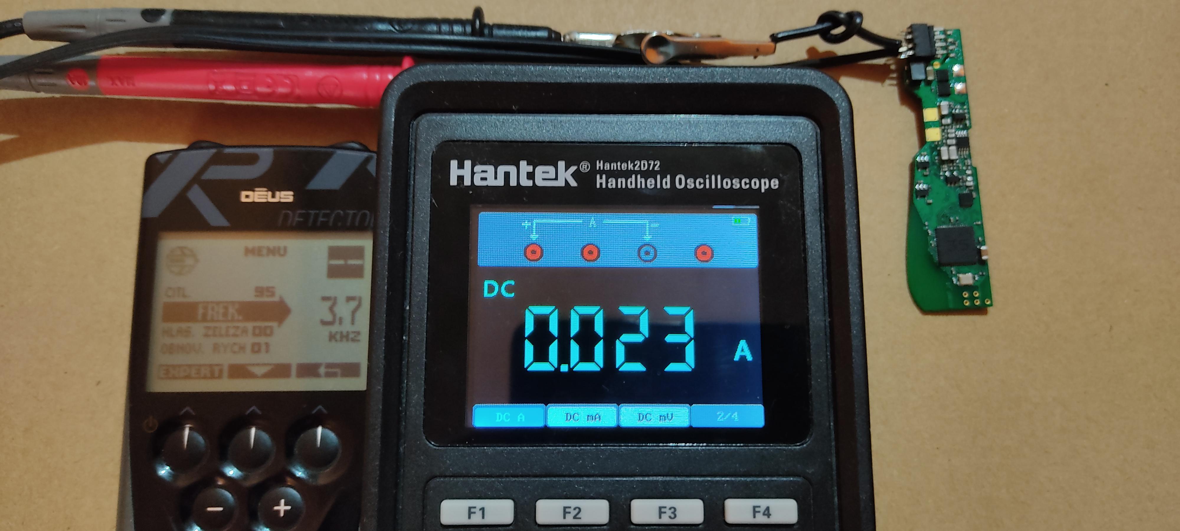

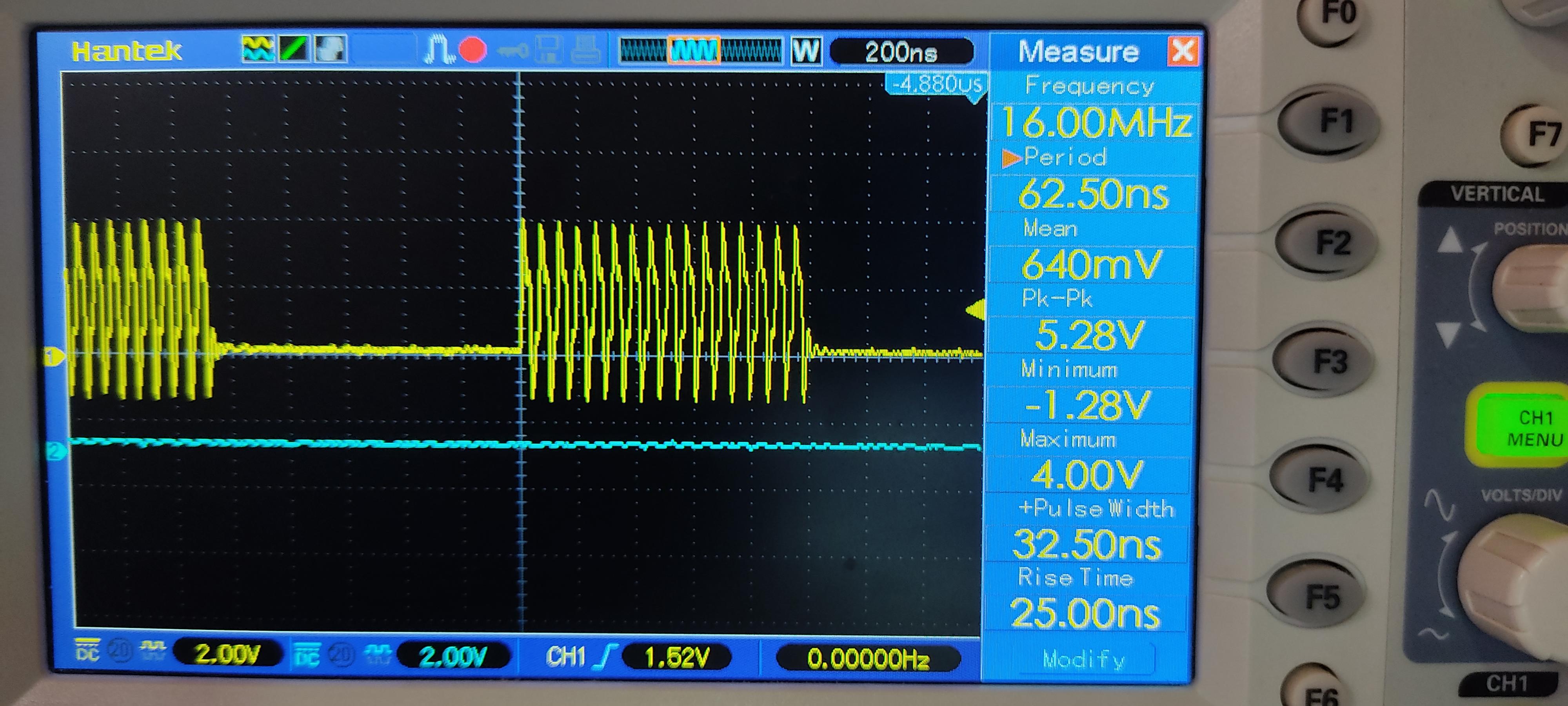

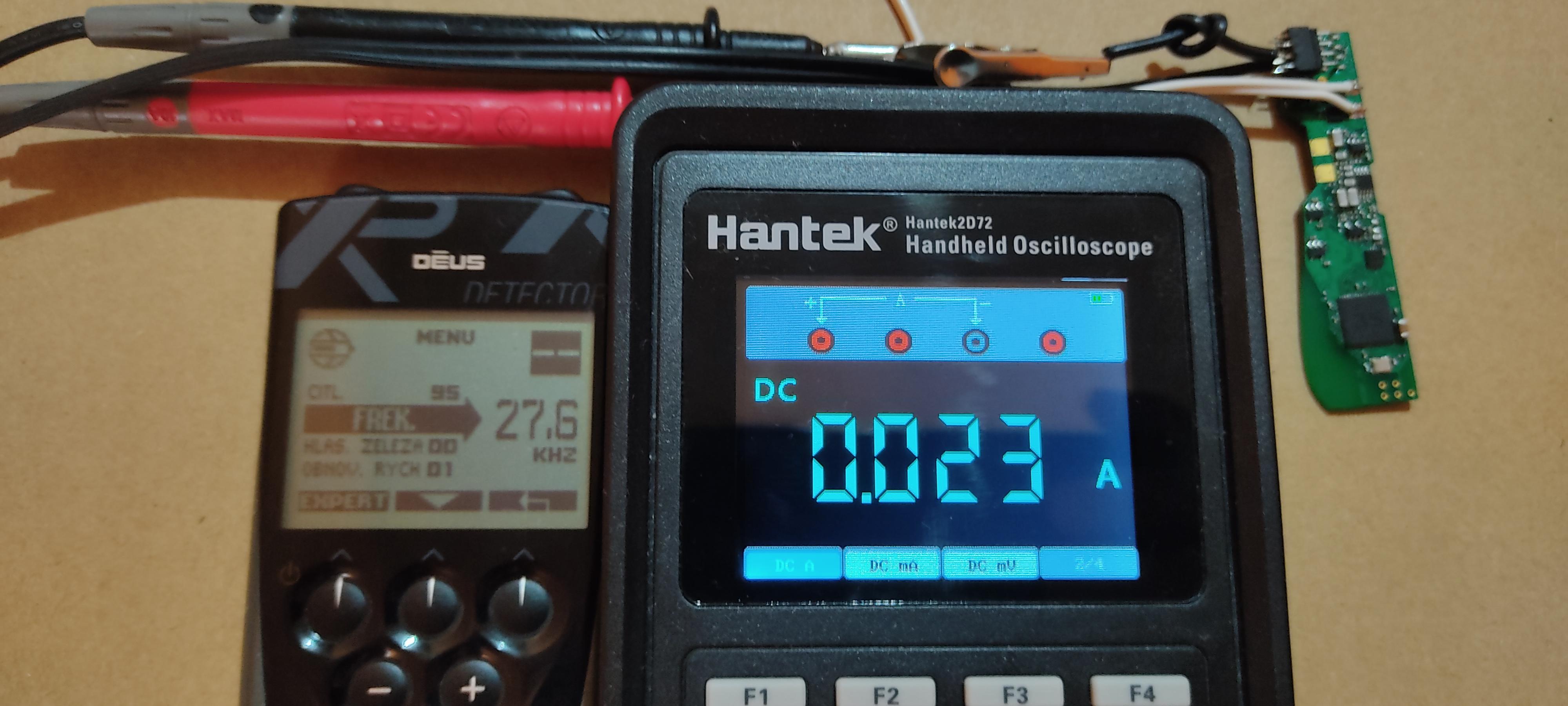

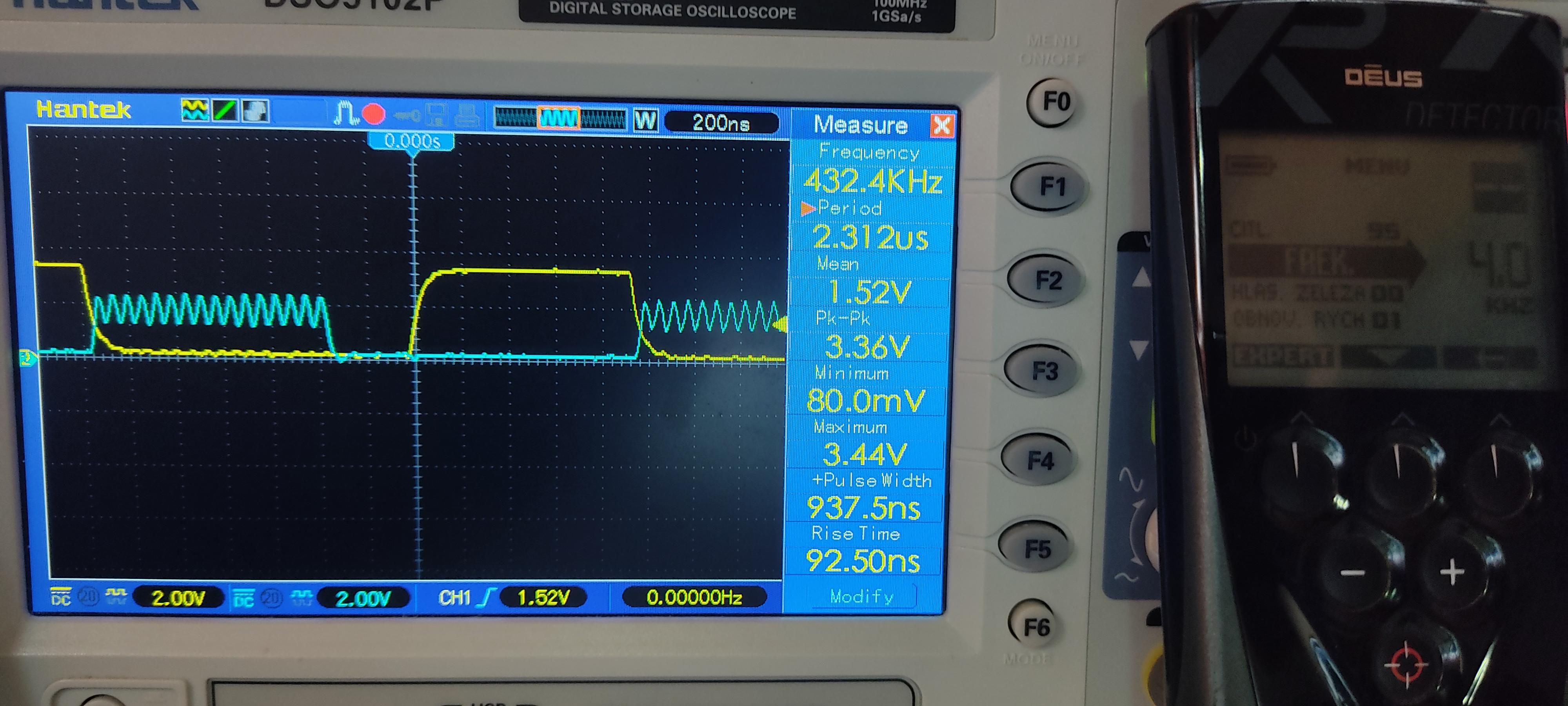

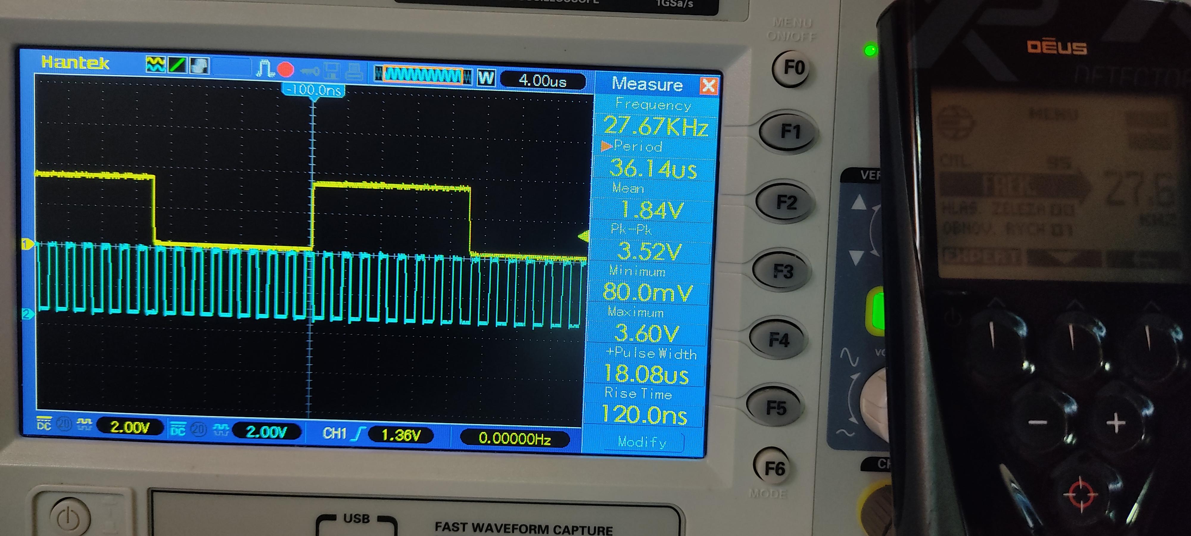

        Hi
        So here are the results of my measurements, I measured the TX signals ADC_CNV and SPI_CLOCK at 4kHz frequencies in BOOST mode and at a maximum frequency of 27.6kHz. I also measured the current taken from the battery with the TX coil connected at 4kHz BOOST and 27.6kHz. Furthermore, a measurement was made with the TX coil disconnected in order to calculate what current the TX coil itself draws at minimum and maximum power. The SPI data is 16 bit so it is a 16 bit ADC and not as it was in the old coils that used the Differentia 18 bit ADC AD7691, X35 coils probably use a 16 bit Pseudo Differential AD7988-5 whose data match the measurement values.

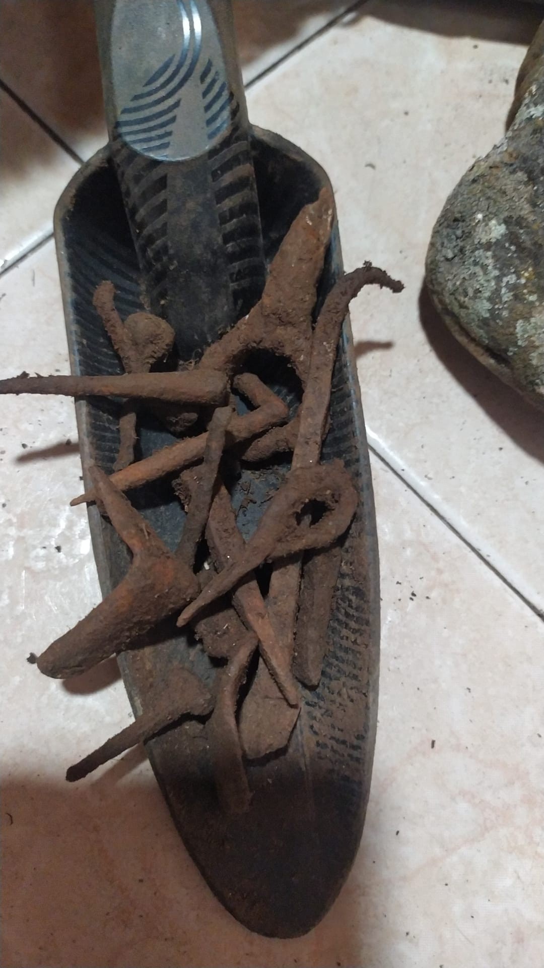

                        А banal situation - an average settlement from the Roman Empire, but the pollution with rusty wires (there were vineyards about 30 -50 years ago) is terrible. The XP DEUS II was operated with an 11" D28 FMF. Тhe garage detector is a 20 cm concentric coplanar - diameter of transmission coil about 18.5 cm. Тhe dimensions and narrow scanning field of the concentric coil are the reason for the significantly greater efficiency of the garage detector . The operator of XP DEUS II works mainly in multi-frequency mode, he tried all kinds of tricks, but ... still we have to take into account that the field configuration of the DD coil does not allow work in extremely polluted settlements ... Congratulations Skippy

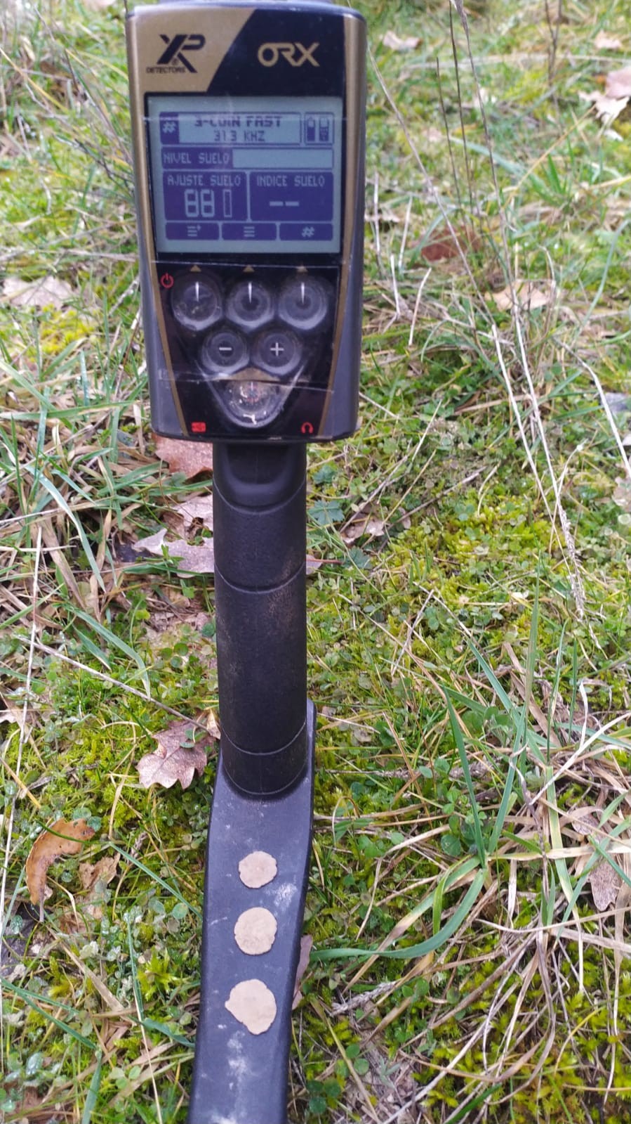

                            • Skippy, I crossed a similar terrain for checking with an ORX with a 9" hf coil at 31.3khz in the coin Fast program.. which was due to the stability of the detector on this terrain on the factory GB-88 / could rock/... I unmasked 3 small hamereds of which 2 from the previously detected area by other detectors, ...,,but ORX did not detect any other small, medium or large Roman coins...
                              ...Another thing is also the number of detected and dug up iron as a good signal...which I didn't dig up before with other detectors...
                              Yes, a higher frequency can improve the unmasking of targets between iron... But it may not apply to all targets in general...
                              But I still take the use of high frequency as a good bonus... and I see the future in it... in the field of unmasking...​

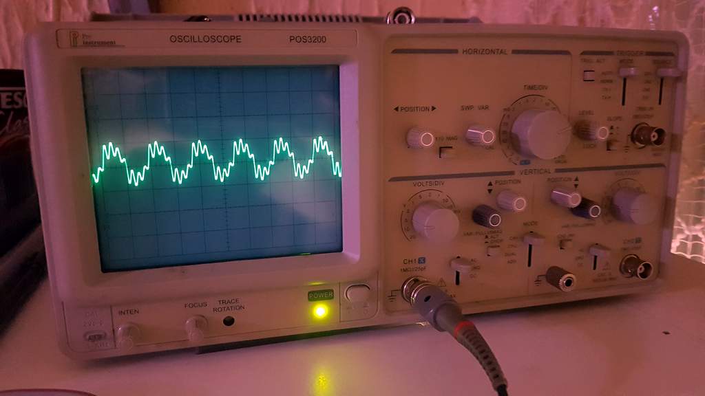

                              • The waveform looks like an sum of square waves in T1:T2=1:3
