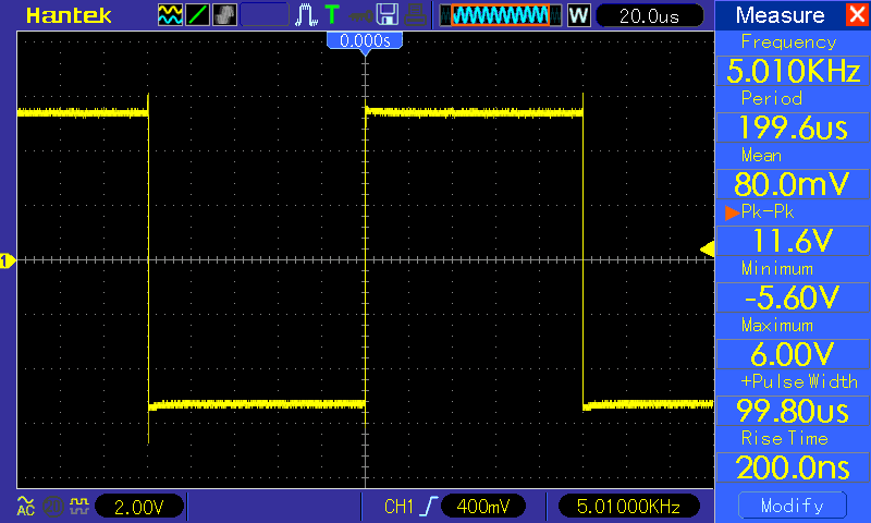

    I will start with some basic measurements. It works with two 9 volt batteries connected in series with a diode to prevent inverted voltage. The power supply regulates the voltage to 10.40 volts and I think that all the IC's (there is a lot) are single supply types. About power consumption I have found information on another site it says 19mA idle and 21 mA at detection, not yet measured on my unit.
    The oscillator is driven by a crystal, it runs at 60kHz divided by 12 so it oscillates the coil at 5kHz square wave with 10.80 volts peak to peak approx. It has strong harmonics at 15kHz and 25kHz.

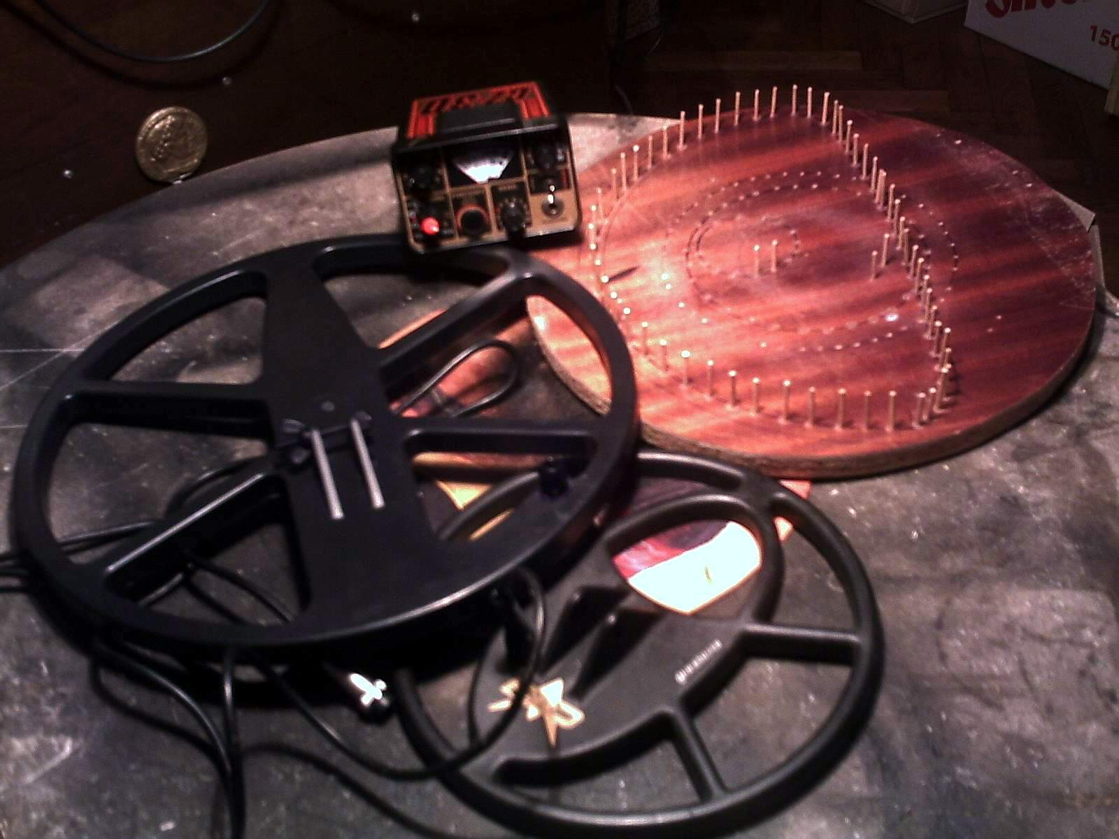

    As for coil making, i was surprised to see that CZ3D is very tolerant upon diy coils. It was very easy to make a coil for it.
    I made 39cm DD coil and balanced it so easy.. much easier than coils for numerous Tesoros that i made so far... i could not believe!
    Or maybe it was just a strike of luck, once in 20 years.. can't tell for sure.
    Original coils are made with very hard to obtain litz wires. Don't bother. I made it with single wire and it worked just fine, excellent.
    Don't ask me about number of turns, i forgot, right now i am searching through my database on the disks and i can't find it.
    But i remember that i followed
    to achieve only genuine inductances.

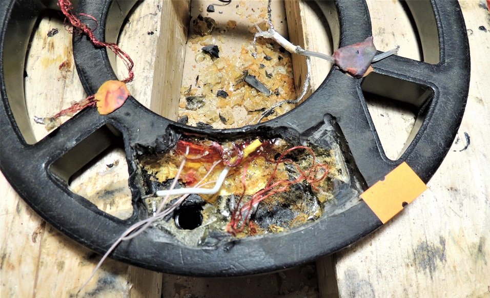

        Found this pic, it shows the original coil "opened up"

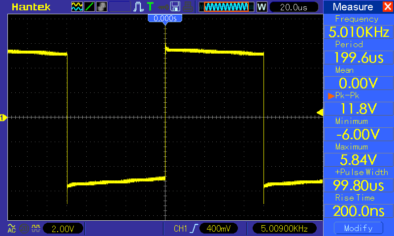

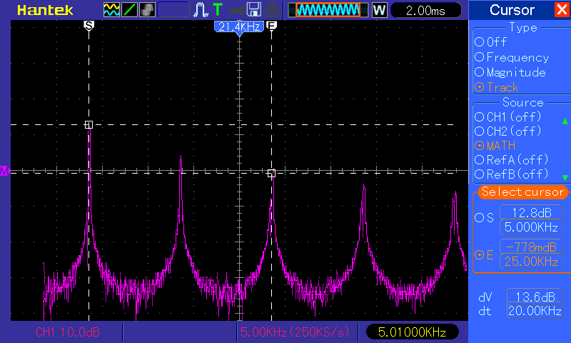

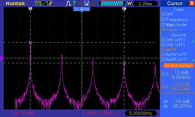

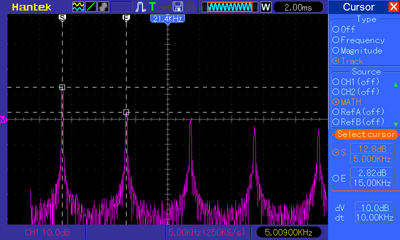

          Some new oscilloscope screenshots.
          First the oscillator unloaded than with coil and lastly the spectrum mode measurements .

                    Old machine does not mean its out of order . Nice pure analog signals and harmonics, no software that can go nuts.
                    I also think that 2 frequencies are enough, as you can see on the attachment the second harmonic is much weaker than the fundamental so the third is even weaker.

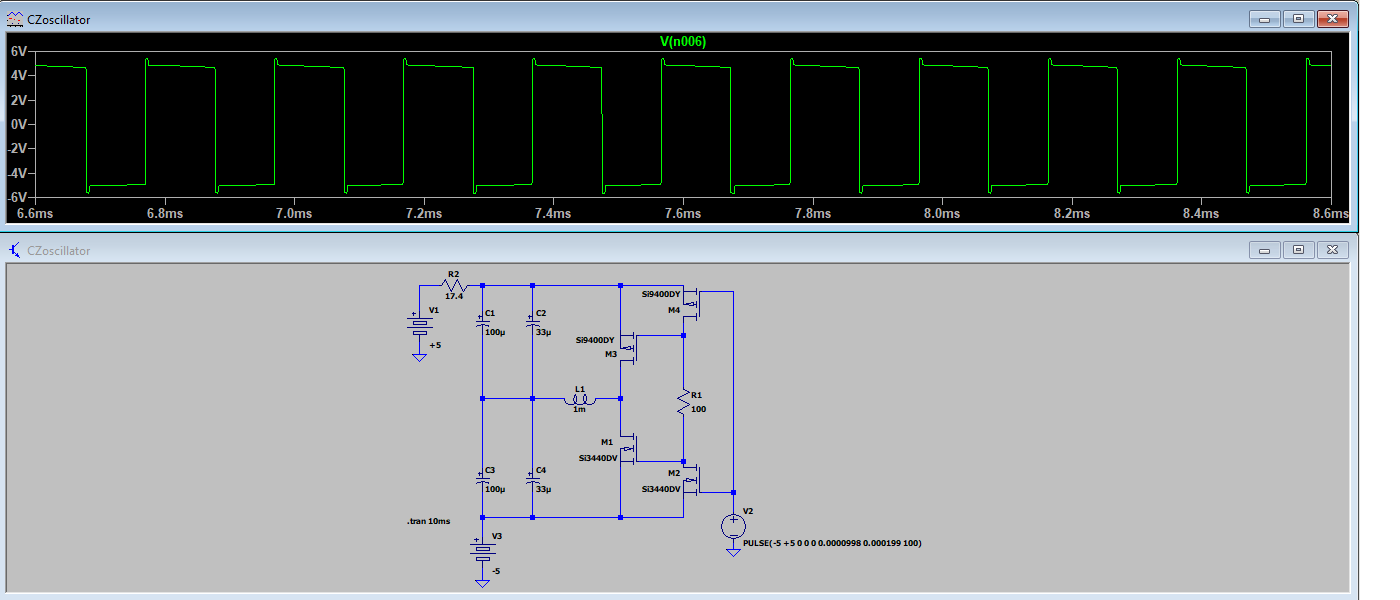

                    Here is the LTspice model for the square wave oscillator of the CZ, I hope it's accurate enough, picture first.
                    CZoscillatorASC.rar

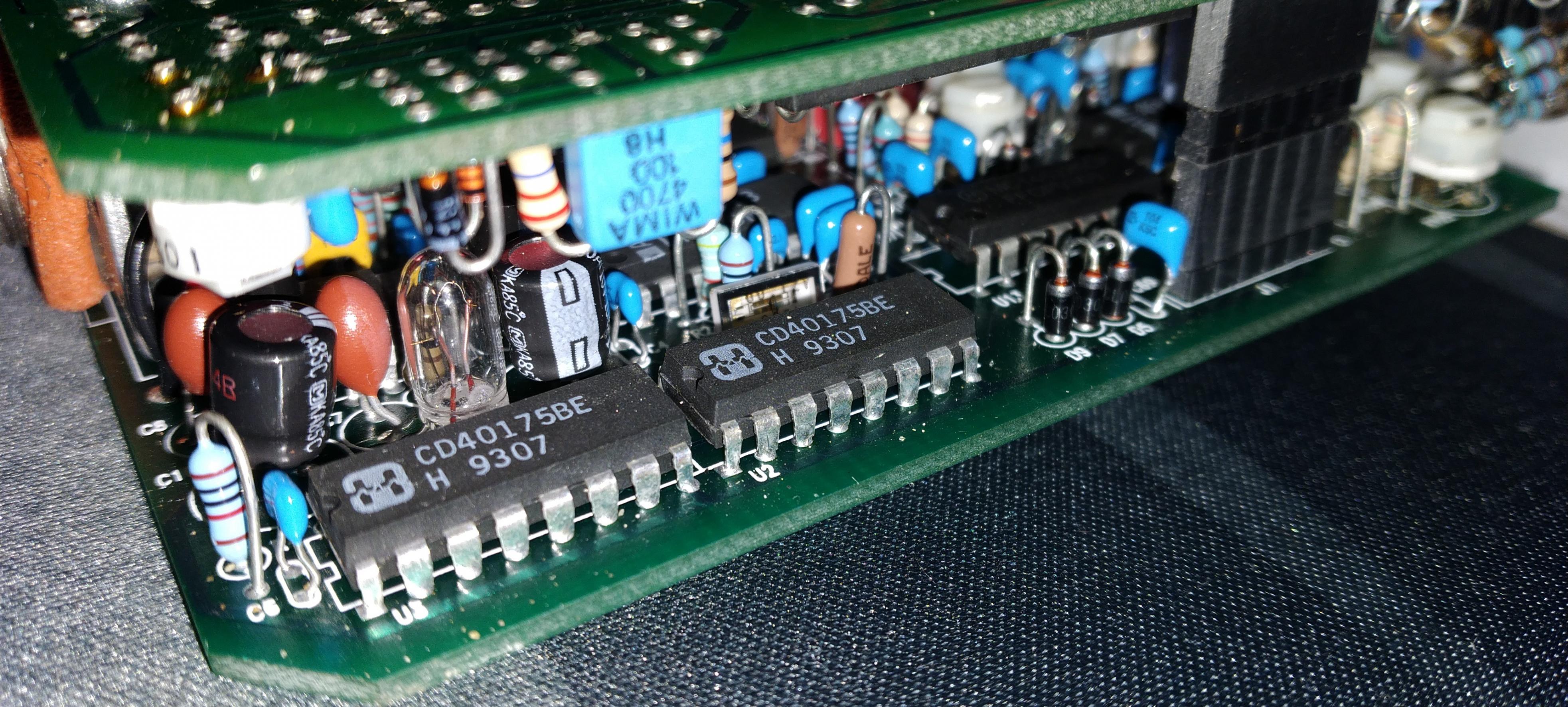

                      Almost forgot there is one more "exotic" component of the oscillator part, it is the little light bulb with a specific resistance of 17.3 ohms.
                      Here is a photo of the oscillator on the pcb. The little bulb on the left and the crystal on the right side.
                        we had discucced that the bulb (does a work of the) is the baretter. yours.
                        big thank again for the detailed manual and schematics to the guy sent me that on email for the archive. your help is fantastic.
                          Yes, the bulb is sort of current stabilizer.
                            It's a current limiter in case someone puts a dead short on the TX pins.
                              In 1265, 1266... probably other models too; it has different role.
                              Is it the same type of bulb after all?
                              Anyway it is interesting solution.
                              What other type of bulbs can be used too?
                              Once i opened large speaker system and saw small 12v bulb put on crossover in series with the speaker.
