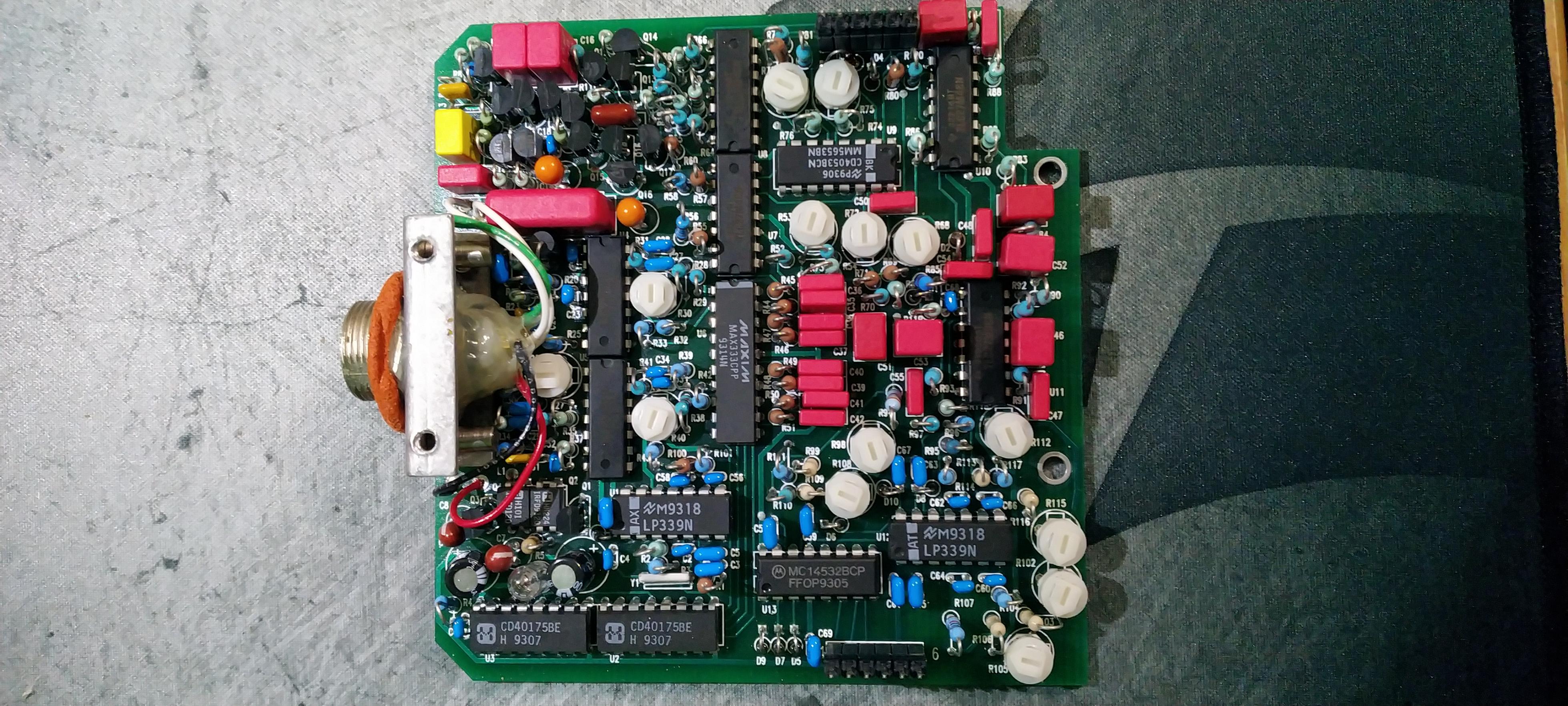

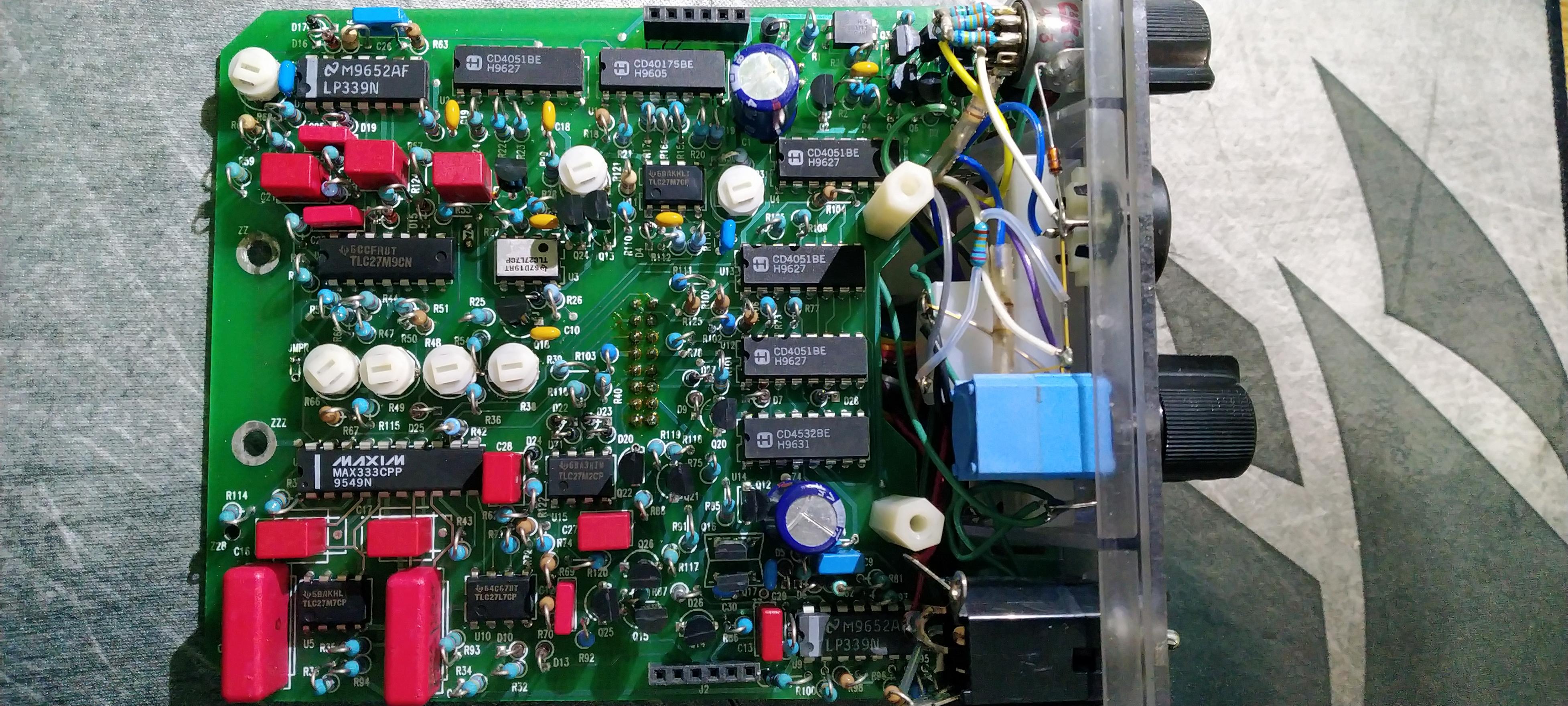

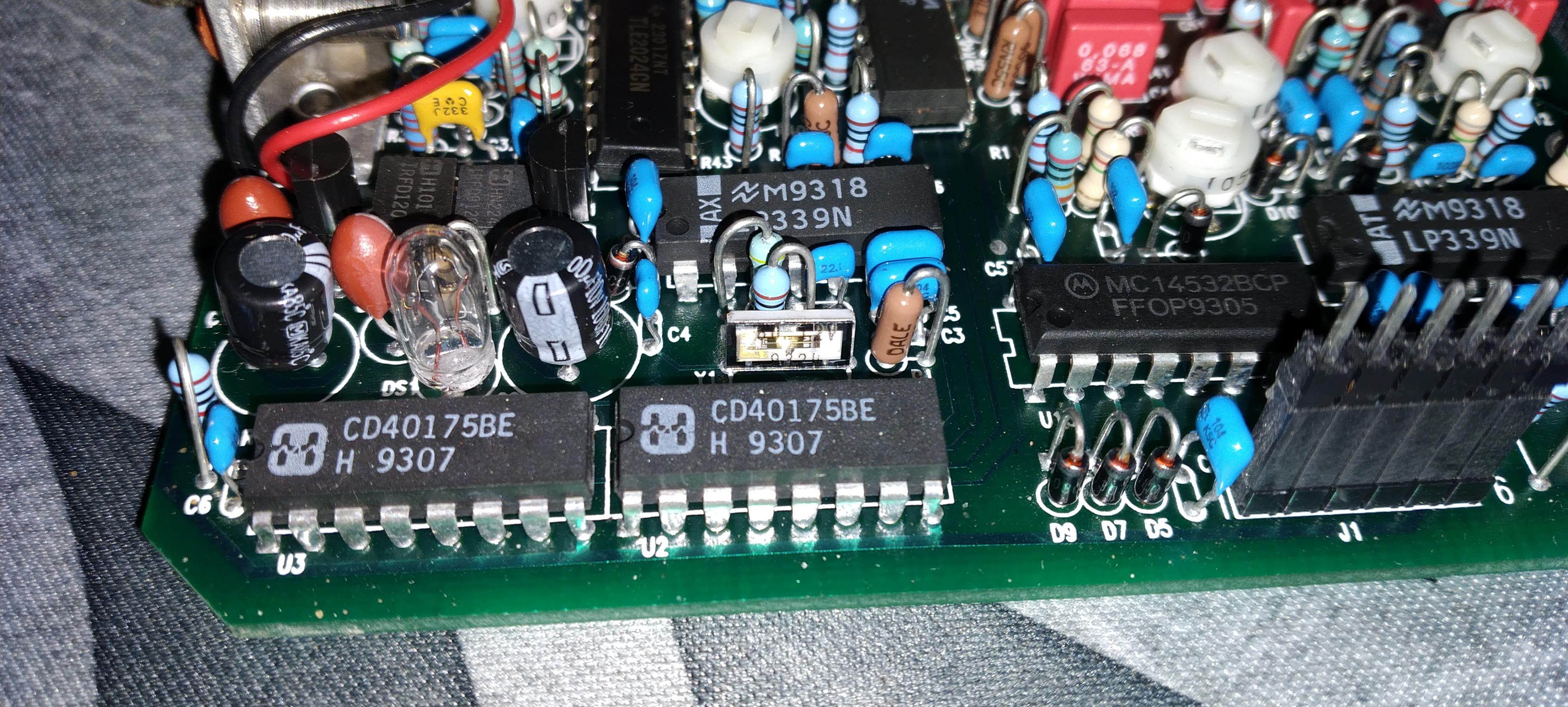

      Hello friends

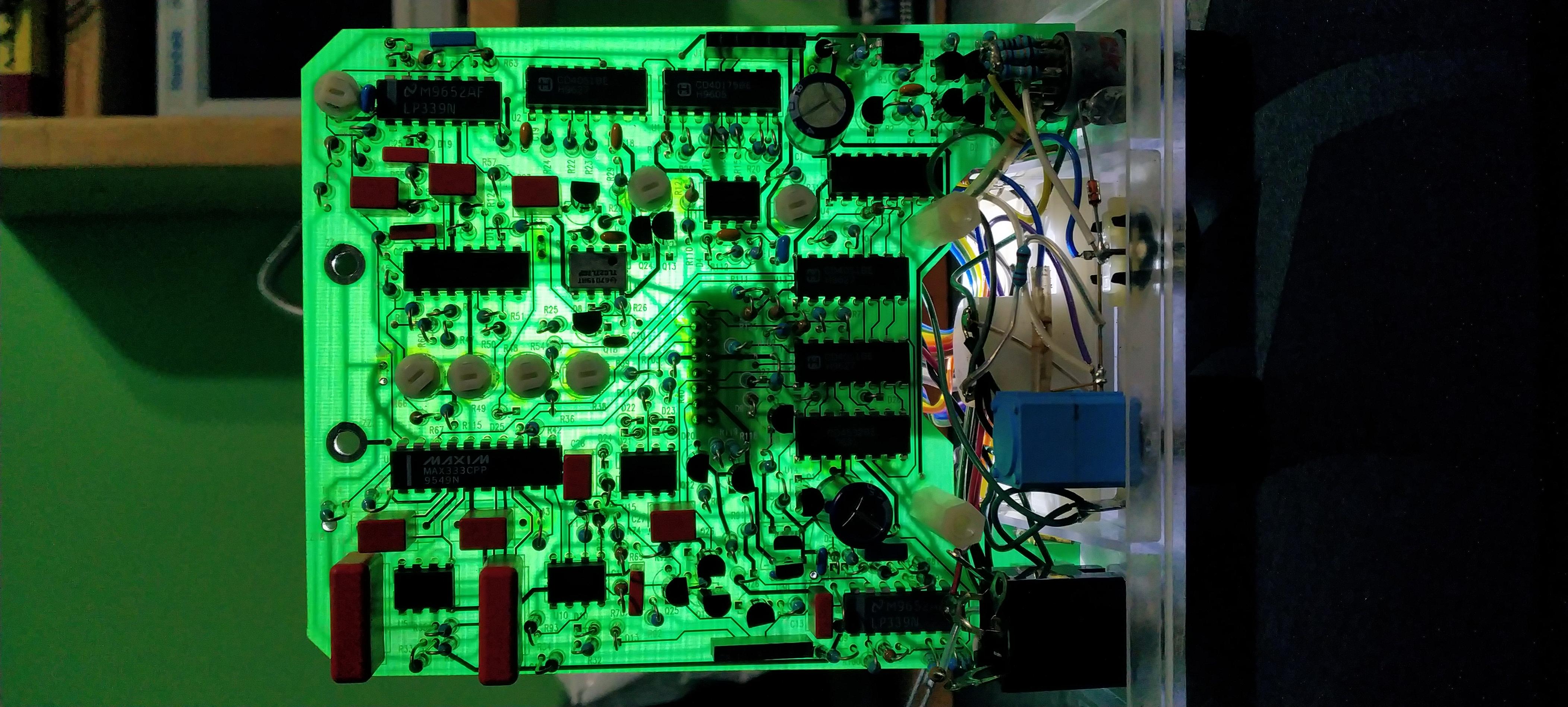

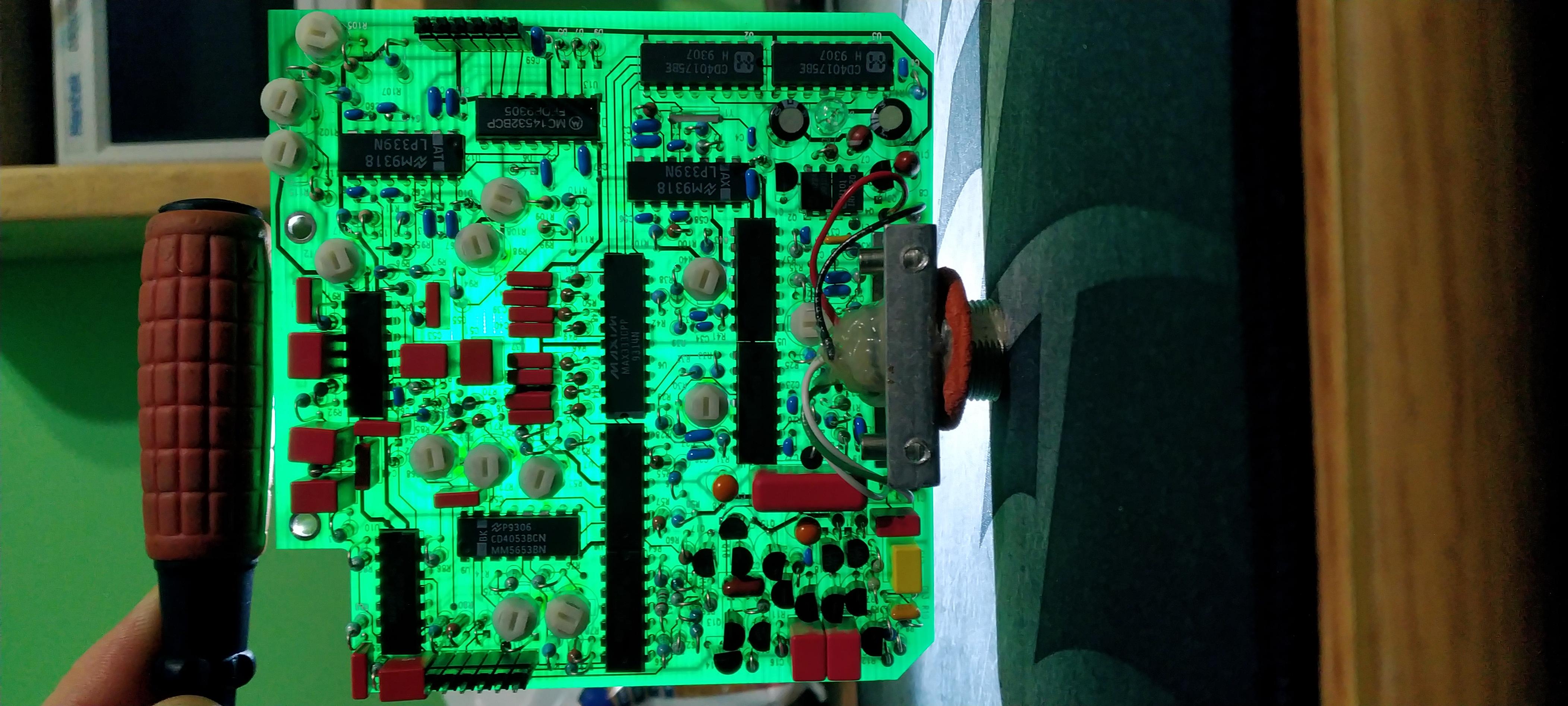

      The little bulb does not seem to light up when the TX is on. Interesting, i thought that it emmits a faint light. It seems that all the IC's are low power variants.
      Some more pcb photos

        Excellent photos!

                Riss could you please share your work? I posted these pcb photos so people can see a standard position of the trimmer potentiometers. Did not measured any of them yet with a scope. Im mainly interested in the "Normal" mode, the "Salt" mode is not my priority.
                First I have to make some better coils for it. A fellow hobby detectorist and electrician told me that the TX coil should be multicore as the original and also with less parasitic capacitance. Maybe a better TX would make some difference and my CZ5 would work as it should. Trying to document as much as I can. Will post some more scope screenshots also, that tells the most

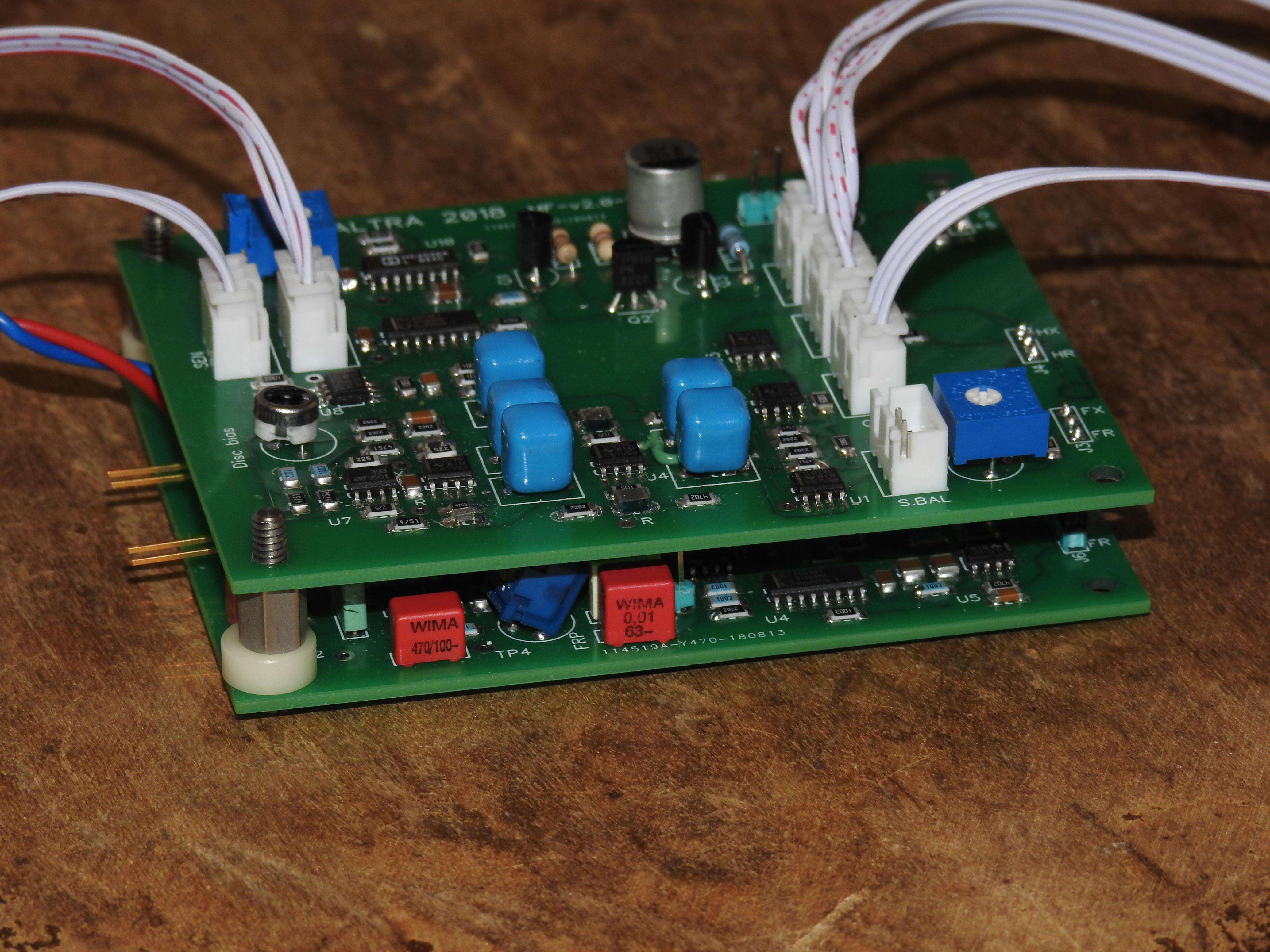

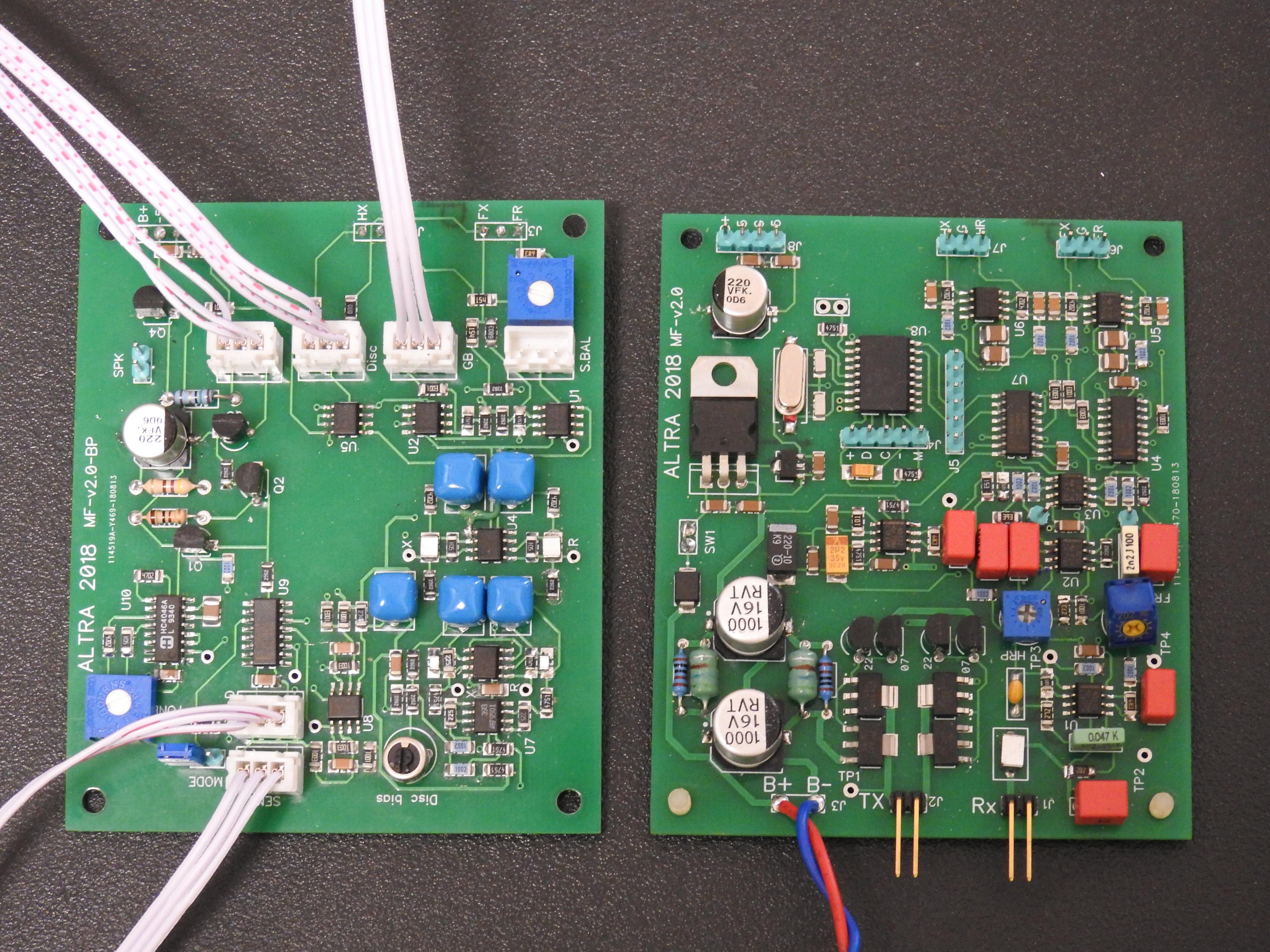

                            This was my attempt at multi-frequency. I lost interest when the Equinox was introduced and later the Vanquish. But now may revisit the project after a long rest.
                            It worked pretty good, but was weak on the low conductors. The gain in the harmonic channel needs to be increased to equalize the gain between high and low conductors.
                            I used the CZ timing as a model, 5khz & 15khz generated by a cheap pic18f1220. It uses a full bridge tx driver to gain the extra coil current. The tx driver is straight from the ML Sovereign. The the rest of the circuit is standard analog. It ignores salt water and has manual ground balance.

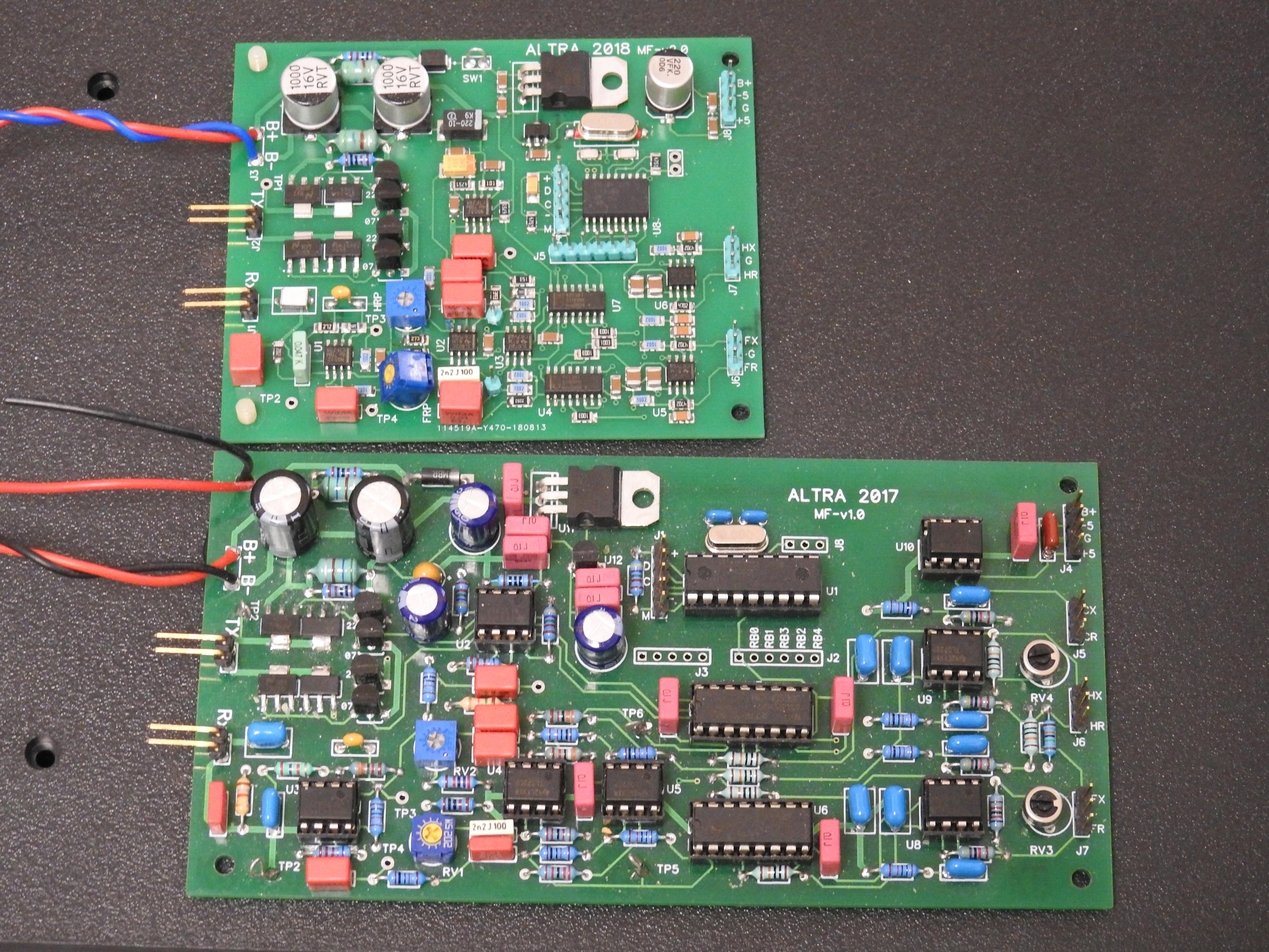

                                Neat work and nice drawn schematic, easy to follow.
                                Two questions:
                                1) Why U7 at TX? I understand the role and what it is doing, yet i don't understand why is not used some more simple inverter solution? Cmos.. or two small mosfets... or similar?
                                2) U12? PIC is supplied with 15v than? Why? Since TX is supplied with 10v.
