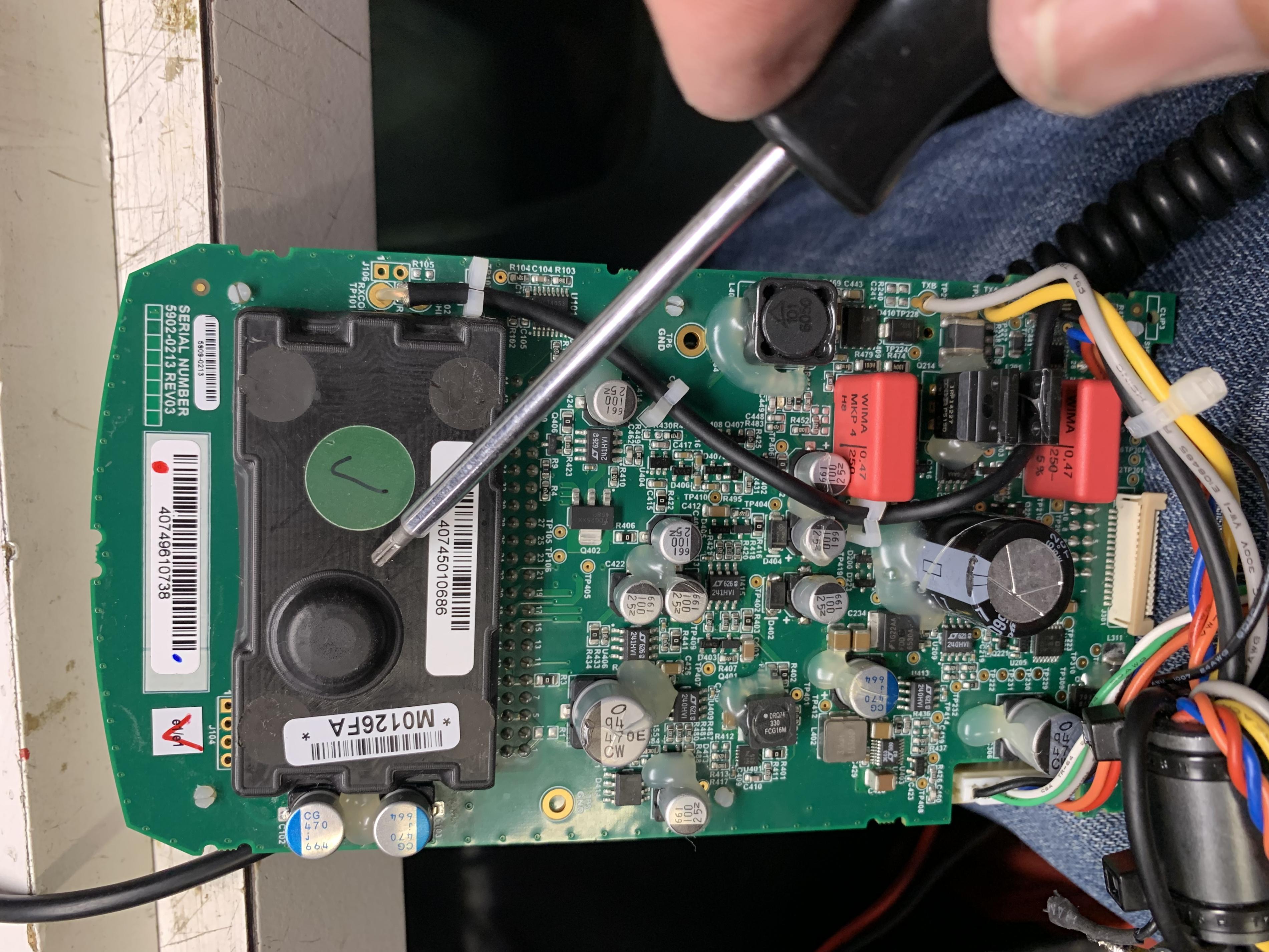

    I have a GPZ-7000 that has very low sensitivity. It got worse over time to the point now a nickel is sensed only up to 3?. Anyone have any insight into this detector circuit or voltages that I can check to try and pin this down? It is not a bad coil.
    The GPZ has a sealed module in the receiver front-end, it is unlikely that you can debug it.
      Yeah I saw that thing but I was thinking it was a TX module. Minelab says the two boards must be replaced in pairs - they are $4600 to replace. They said they tried to update the firmware and something got hot. That doesn’t sound right to me… I haven’t tried yet. Seems to function ok. Anyone taken TX current waveforms? I could compare to at least validate TX.

        Well I looked at it tonight and you are right - it is an RX module - and it gets hot just being powered.

            I can’t get the MEK products here. Maybe there are professional shops that do it? Also some of the compounds get rubbery with heat and can be pried off. I’m going to take my time investigating as I likely only have one shot at it.
              Post some pictures of the module. I've had some success with removing epoxy potted pcb by boiling in water.
                Photo of module. It has several solder pin connections to the host board but I don’t expect any problems getting it free of it.

                    Photo of module. It has several solder pin connections to the host board but I don?t expect any problems getting it free of it.
                    Black mass; is it epoxy after all?
                    Is it soft or hard, poke it with needle or knife and see.
                    Assuming it is hard and it is epoxy of the toughest kind...
                    I am afraid the methylene chloride is the only solution...

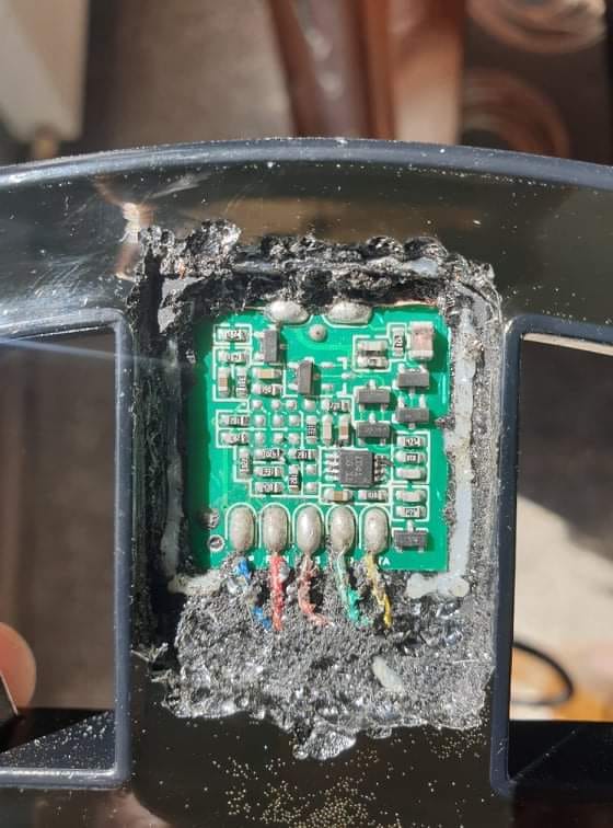

                      I’ve discovered there are quite a few companies that repair potted PCM automotive modules. I have to talk to them to see what their capabilities are. You are right, this looks like tough stuff to dissolve.
                        I took off a lot with the smd component blower that module is a very small problem compared to the things I remove..Just one example removes the resin on the minelab vanquish 540 coil..Click image for larger version

                          Wow, very impressive! Got any YouTube videos of doing this work? So use a temp controlled heat gun and a dental pick and work slow? What temp did you work with best. Will the boiling in water method work with this material? Are you foxmd? Not many on the planet that have these skills.
                          Another method I’ve discovered is sort of a micro sand blaster approach. He could focus on just the component area that’s getting hot…
                            If Minelab did it the way I would do it, then the module is an MCM with die-level chips and printed thin-film resistors. If you manage to dissolve and remove the epoxy you are still sure to destroy the module. I would look everywhere else before doing this. Especially look at the TX and see if it's running full strength. Problem is, any troubleshooting is poking in the dark without another machine to compare with.
                              Yeah you are right! We have an X-ray system at work to check BGA soldering. I plan to use it to verify there is a replaceable component where the heat is radiating from. Even if I succeed with this I may not be able to determine what the part is after removing the epoxy… How to check the tx? Would a current probe check be sufficient or would there be another way?
