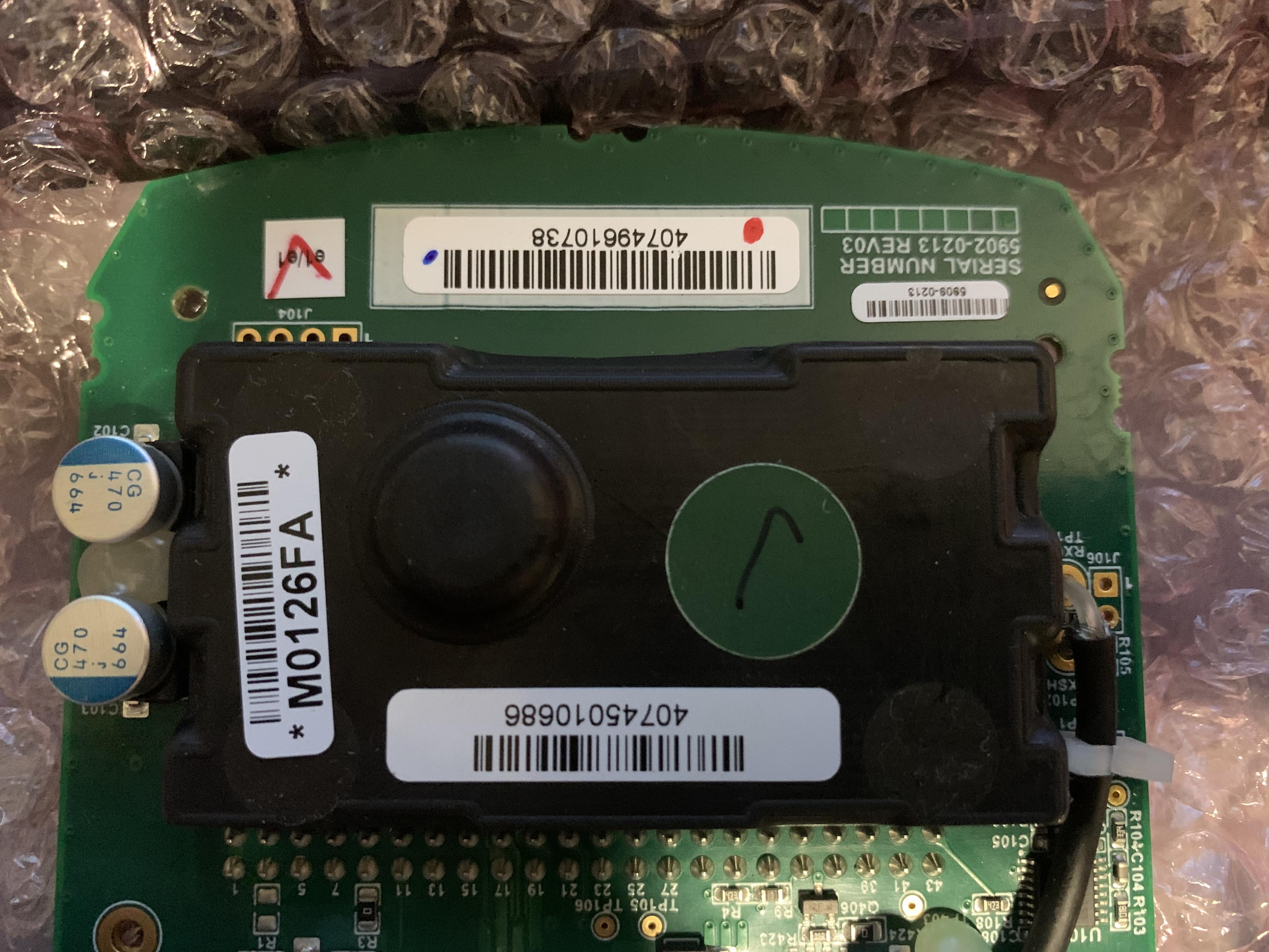

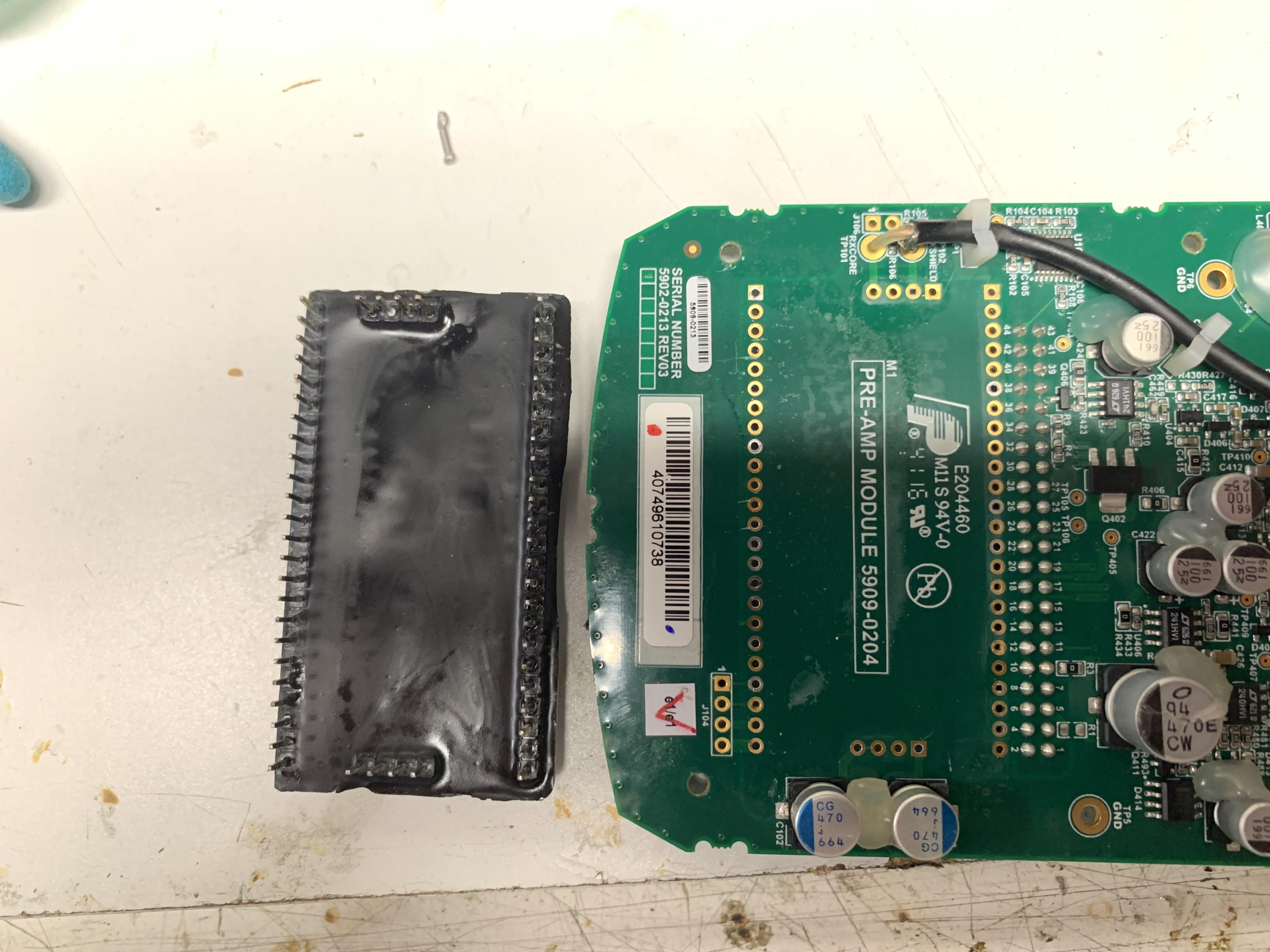

                The biggest problem of the whole story is if minelab put inside rx discrete component which when the coil is turned on sends digital data to the processor do the rest as I wrote in a private message!According to the description that the sensitivity is low, I would rather suspect an op amp in that resin-filled module!Possibly the problem does not lie in the module as Carl said it would be best if you had another complete pcb to try...

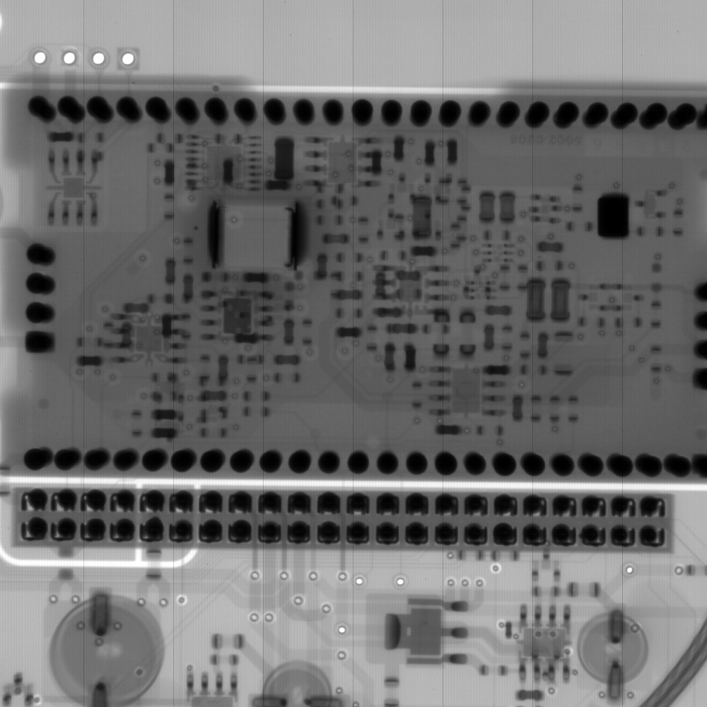

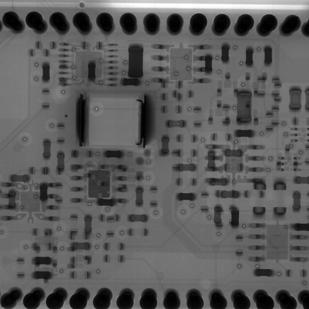

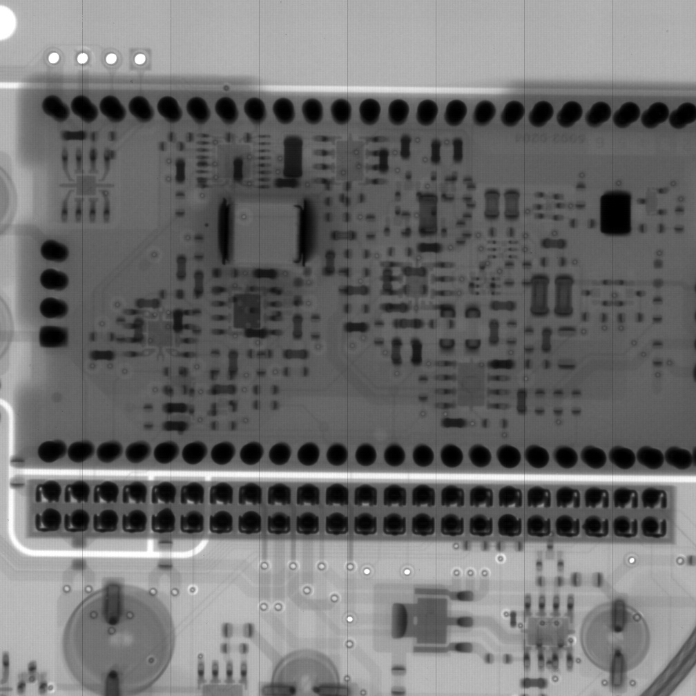

                  Xray Photo of GPZ black module

ID:	363143Here is a photo of the black module from my GPZ board. It gets hot to the right of the raised circular thing.
                  I took it to work and got xray photos of it too. Maybe you guys can make out key components....
                  Just find the bad one! :-)
                    Good x-ray pics! I'm a little surprised, it looks like plain old SMT parts, something that would not be difficult to reverse-engineer. For the purpose of solving your problem it doesn't help, though.

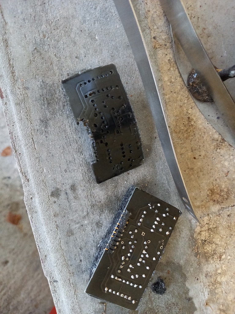

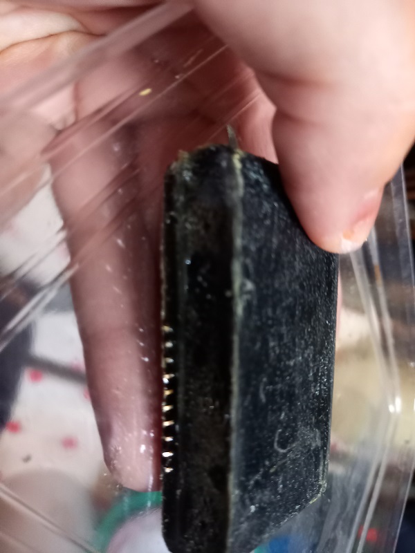

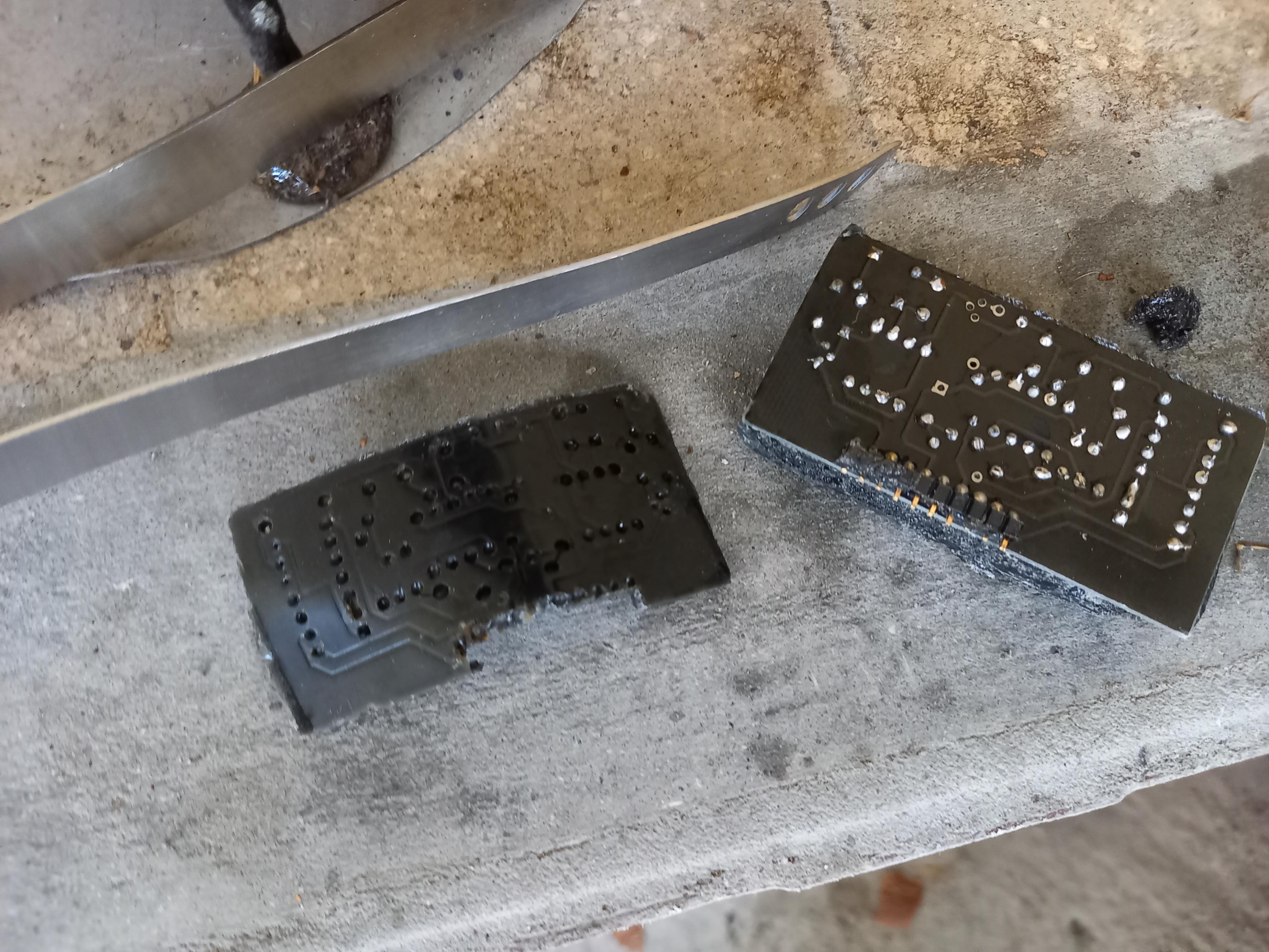

                      Cut a small piece of the black stuff and throw it in a boiling water. If it's not heat resistant in less than 30 seconds it will start getting soft. If it does throw the damn thing and boil it. Take it out quick and smush it with a soft tool, not sharp so no component gets damaged. If you are in luck a whole side will be detatch itself from the board so actually free the permiter first and hope the rest will come off.
                        This is the video I was inspired by to boil the board I had covered in epoxy. https://www.youtube.com/watch?v=OiPe...nnel=Create%21
                        and here is the board which I've successfully decapped.
ID:	363144 Click image for larger version
ID:	363145 Click image for larger version
                          Looks like I should remove the module from the PCB first to determine if the black we see is a housing or not.
                            Does the epoxy stay soft after it cools down?
                              No it returns back to what it was so you need to boil it again. I needed 3-4 passes on mine but it was very thick layer.

                                Success with removal. Tip: use of low temp solder kit (SMDKIT-1) helped!
