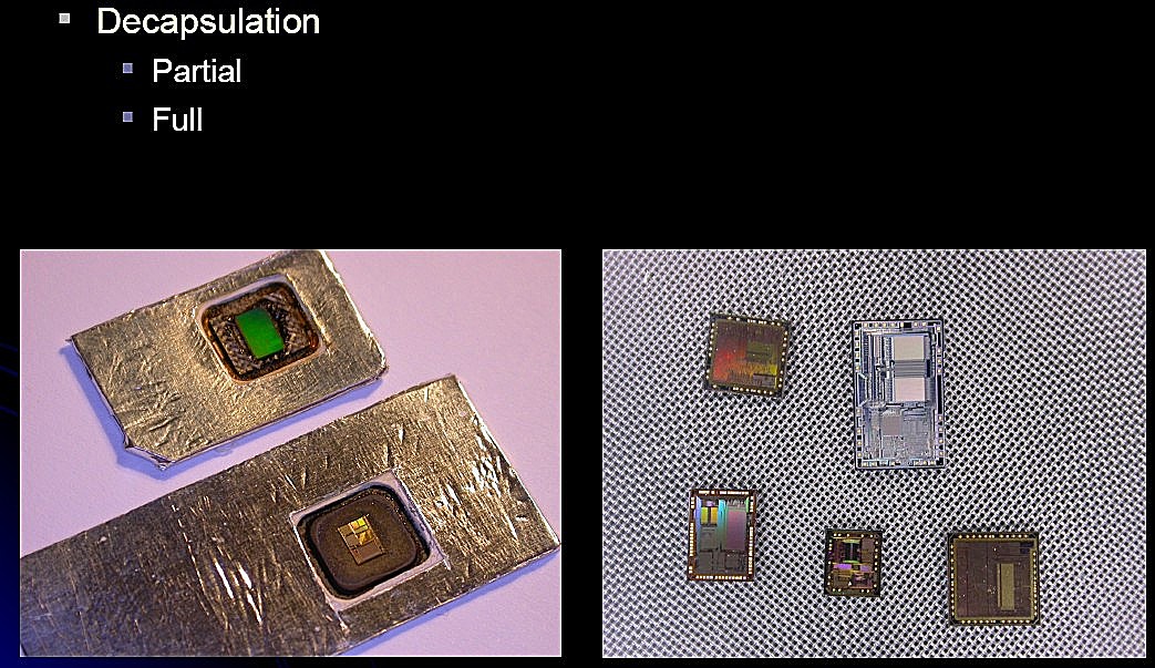

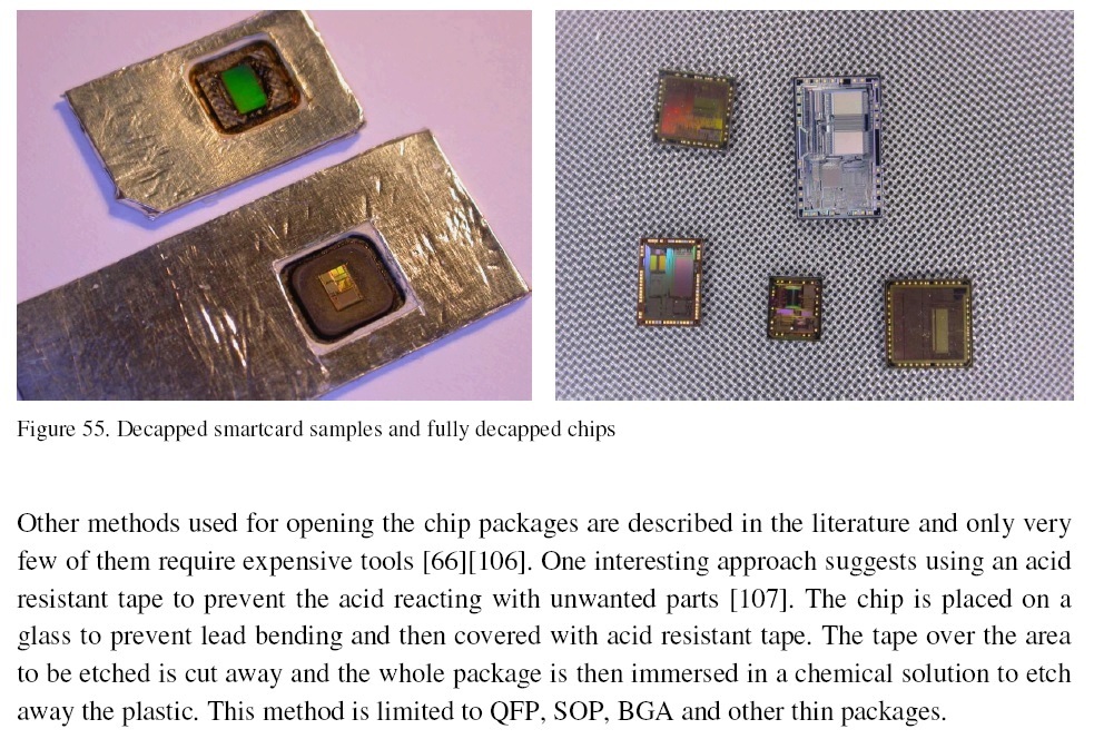

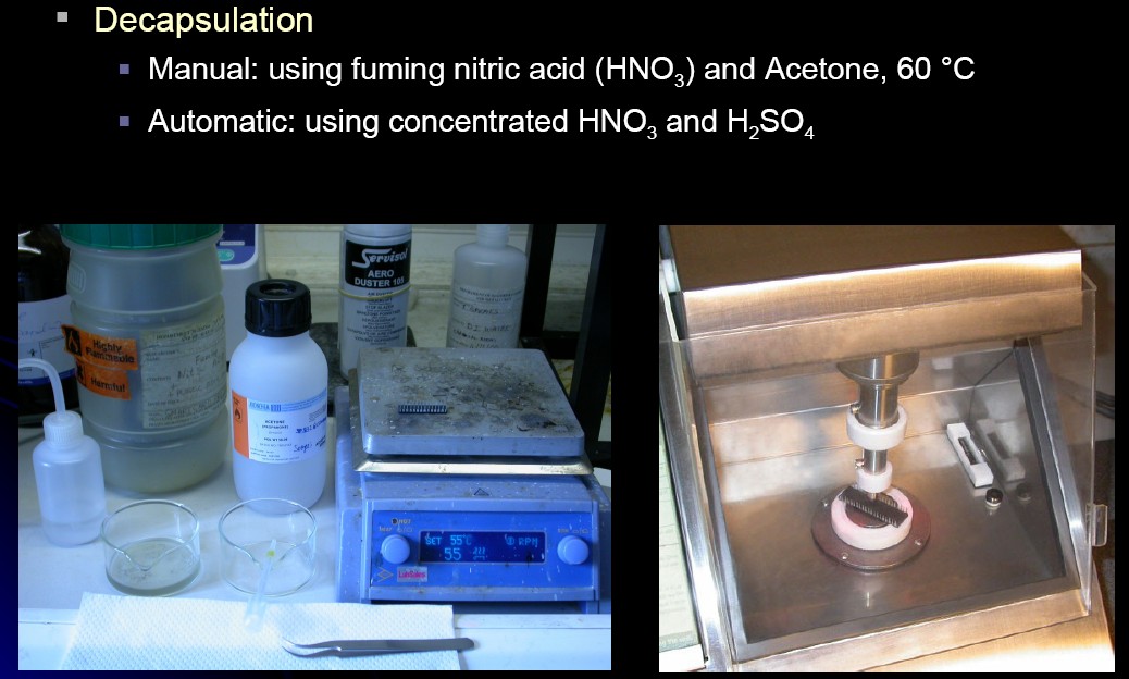

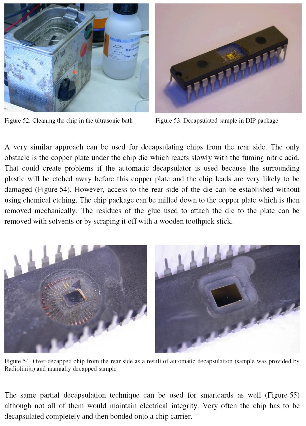

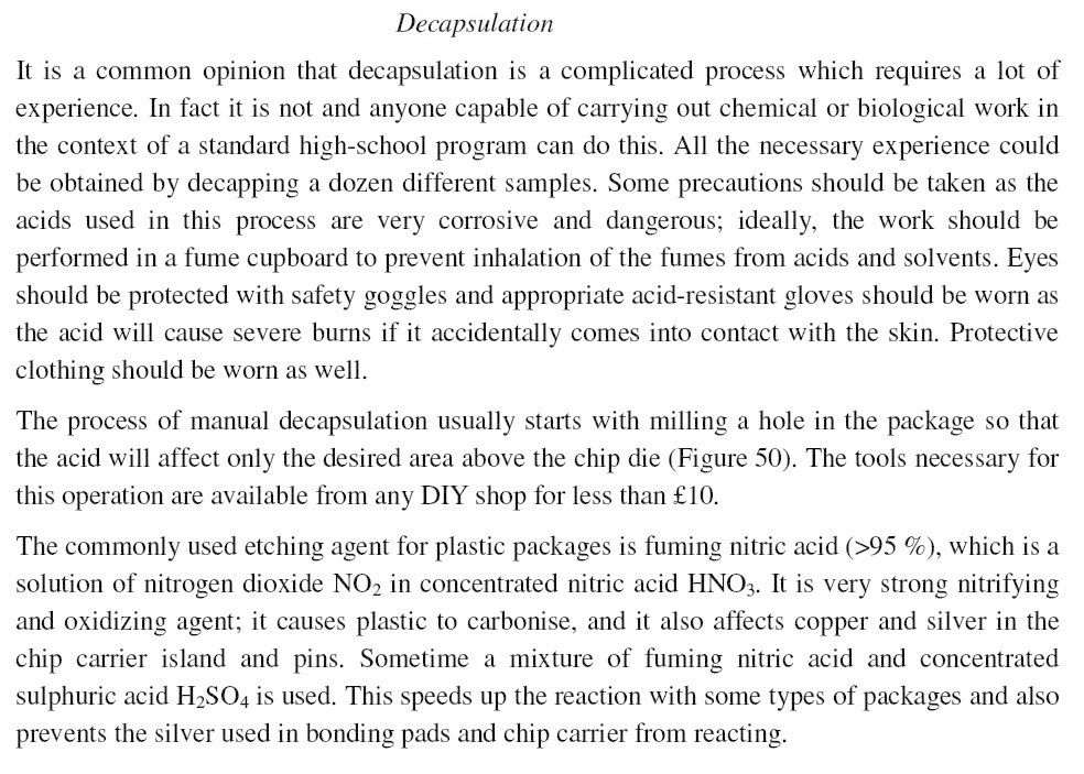

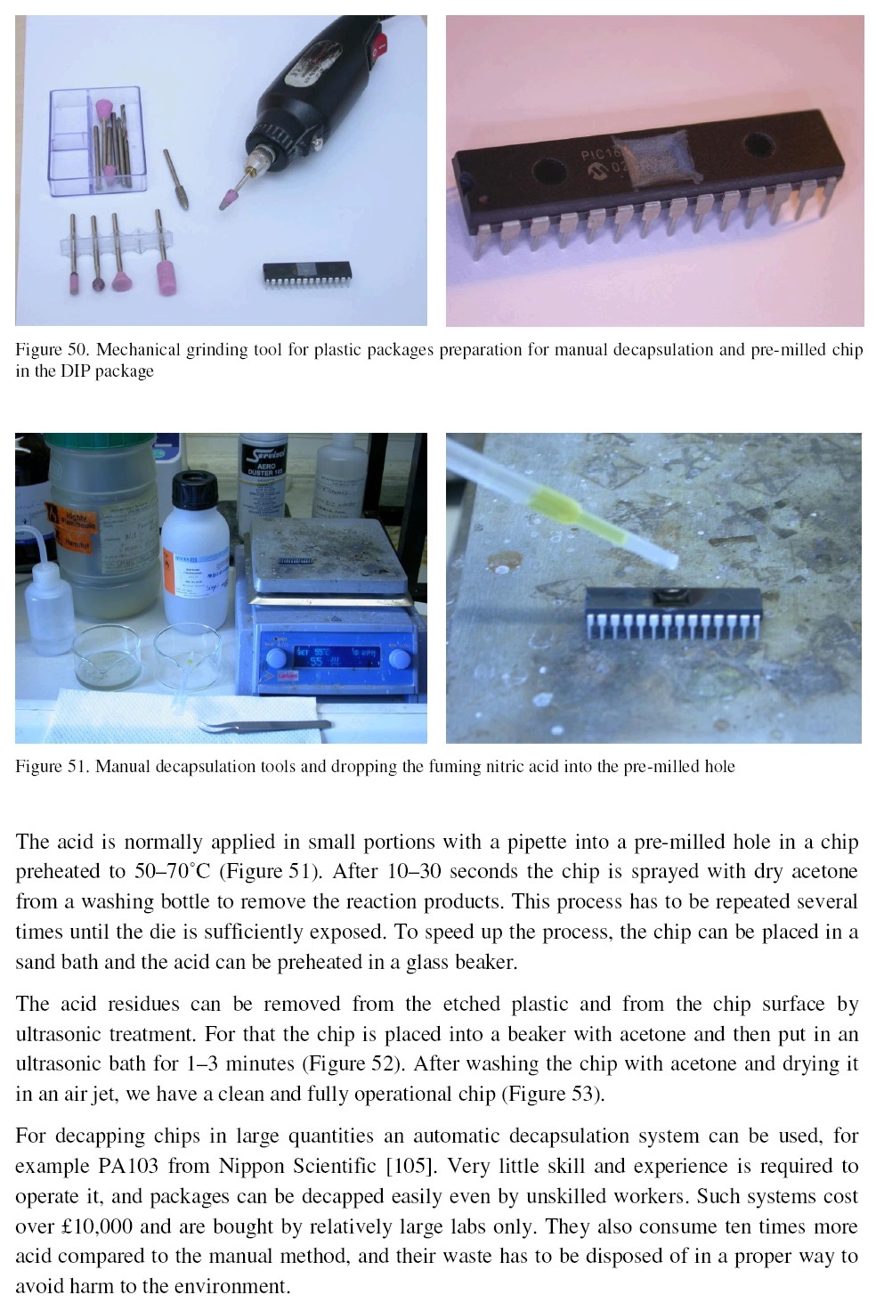

      Sekret uklanjanja epoksi smole
      google say
      Secret of removing epoxy resin

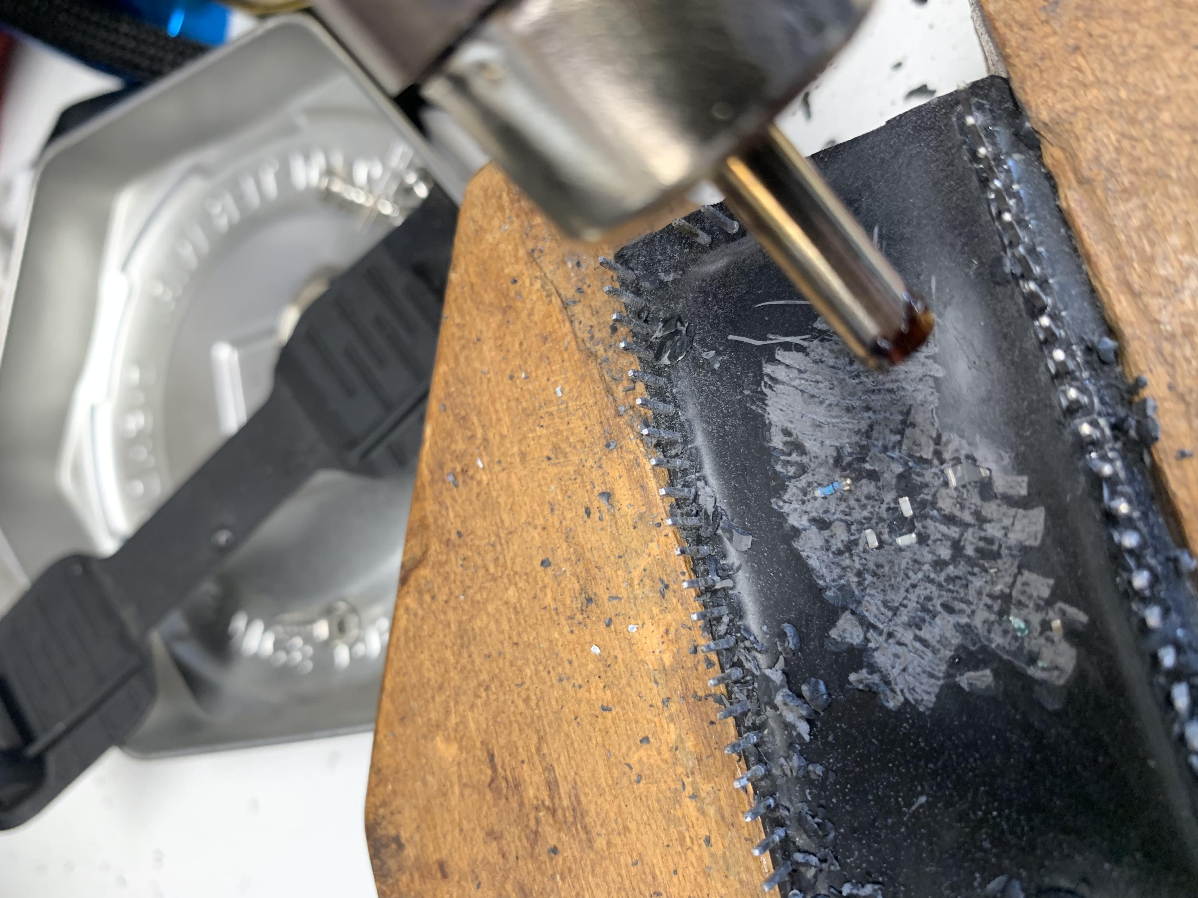

            SMD heat gun
            I tried my SMD heat gun. At 300 degrees the resin surface becomes a bit brittle. I can scrape it away with a small flat blade screwdriver but I’m very scared I’ll likely knock components off doing this.
            Maybe I can use a lower temperature.

                    I tried lower temperature- 250 degrees is where it starts to be useful.
