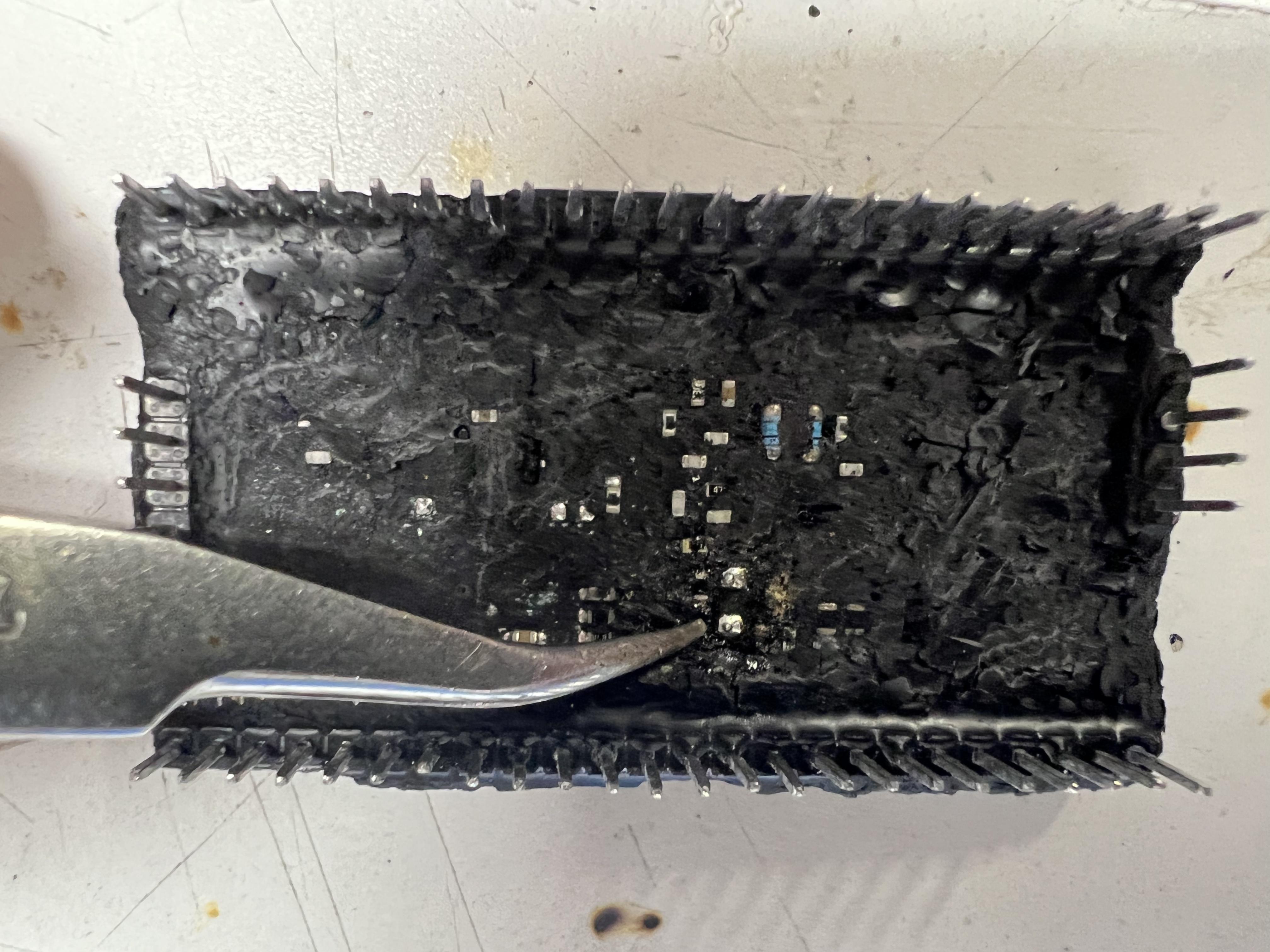

          • #50
            I did just receive the solvent. So I’ll put it in a jar with the board - but what should I expect? Will the epoxy just soften and I will have to pick off pieces or does it come off the board on its own? Wondering how I know when it’s done all it will do.

              • #52
                I did just receive the solvent. So I?ll put it in a jar with the board - but what should I expect? Will the epoxy just soften and I will have to pick off pieces or does it come off the board on its own? Wondering how I know when it?s done all it will do.
                I know my posts are sometimes too long and tedious to read, but read the first post on the first page again.
                I explained that it was a "monitoring" process over several hours.
                With a needle or a sharp blade, occasionally (every 20 minutes to half an hour) you check how far the process has come, by poking the mass.
                When you notice that the needle enters the mass very easily, or you can easily separate part of the mass with a knife;
                then it's time to take the module out of the container and transfer it to another container with water.
                Then with a knife, a scalpel, a sharp chisel; you remove all the softened mass that can be removed, but nothing by force!
                When you can no longer remove layers of mass so easily; put the module back in the dichloromethane container and let it stand for the next half hour.
                And then repeat the same again. And so you repeat the same thing until you remove all the epoxy from the module. It usually happens in a couple of attempts.
                So, at the start you have two containers, one with dichloromethane and the other with water. And they remain there "in the game" until the end of the job.
                The first "poking" check is done after 20 minutes, and the next one is done even longer, if you notice that the process is running slower.
                And vice versa, if the process goes faster, then you do the checks in shorter intervals.
                Epoxy will not fall off on its own even at its softest. You have to do it with a blade or similar tool.
                The epoxy will turn into a gelatinous mass that easily separates from the module.

                  • #54
                    12 hour report: the areas that became brittle from heat gun 150 degrees C and later scraped exhibited some of the brittle material coming off the board and settling on the container bottom. The areas of the board not previously heated show no change with the soaking - still a hard surface. Bummer.
                    • #55

                        • #57
ID:	363251Click image for larger version
ID:	363251So it?s been a few days and I decided to check it. Again some of the areas that were affected before would freely come off a bit more but nothing major. I decided to try heating it with the heat gun some more. The epoxy would pop off like popcorn! But it took a part with it - looks like a diode perhaps. I?ll have to get my microscope out to see if I see any markings. It?s from the area that got hot with power. I checked with my meter and it is shorted. So if a diode, how does the replacement go? The pad inside does ohm out to several of the pins on the sides. The outer pad doesn?t ohm out to any of the pins. 50-50 shot at it I guess!

                            • #59
                              Nah, I think it’s time to give up. I tried a replacement diode both directions. One at it was very poor sensitivity, the other way none at all. I need a replacement black RX module. Maybe if you hear of one of these getting caught in a fire?
                              • #60
                                is there anyway you can get this block xrayed?, its a long shot but you have low sensitivity so its now working at least, an xray of it might just show which other parts need changing.
                                if another part looks distorted you can just focus on that, taking just enough epoxy to get to that bit, but my guess would be a cap/caps connected to the diode you changed.
                                if it was a cap the circuit would work but not properly, most other parts would stop the circuit from running, if you know what i mean.
