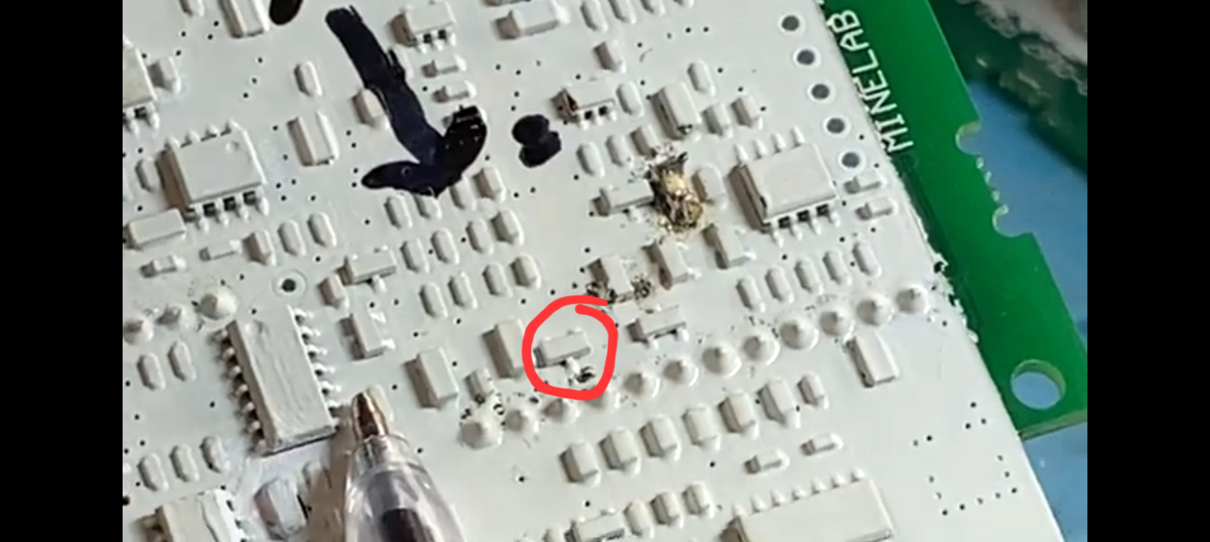

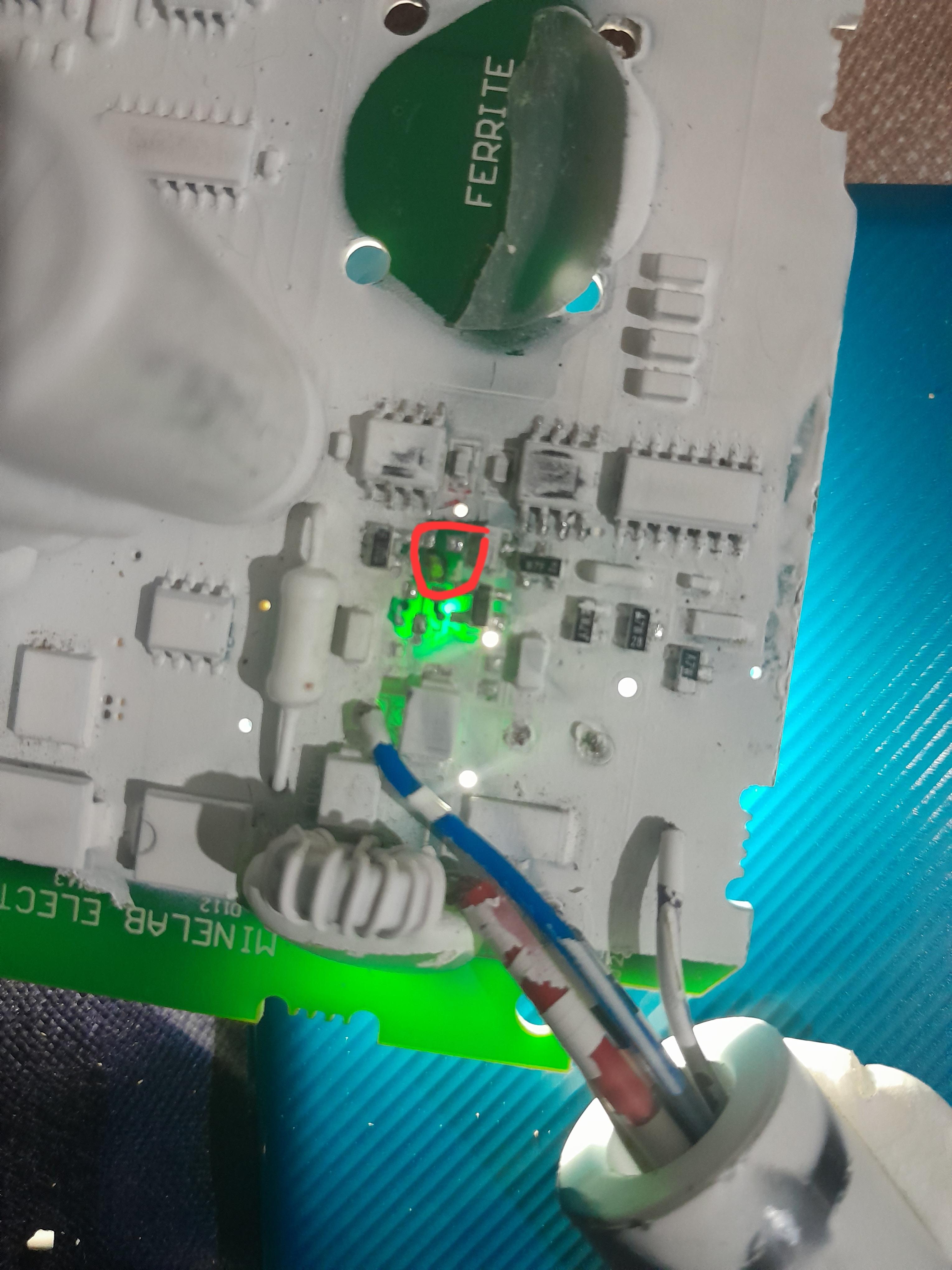

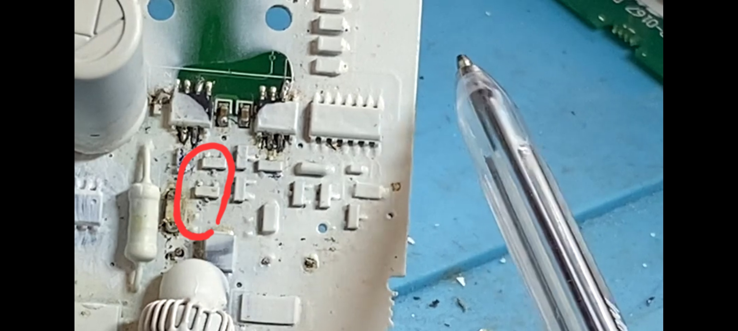

          Yes, I have watched all of your videos. I own a gpx 4500, some transistors burned out, and it gives a depth of no more than 10 cm on large objects. I wanted to repair, but I do not know the name of the transistors. Here are some of their pictures for you . Click image for larger version

          Regards part names pls thanks
            If you watch the video i point out the N channel mosfets and the bav99 protection diodes, just remember that SD GP detectors input fets are n channel and then p channel and with gpx the fets are both n channel, my take is that the p channel had too much intrinsic capacitance for the faster switching time for enhance and fine gold. Did you see my video on the floating front end? Gets rid of the board based gate drive with associated noise injection and gate modulation.

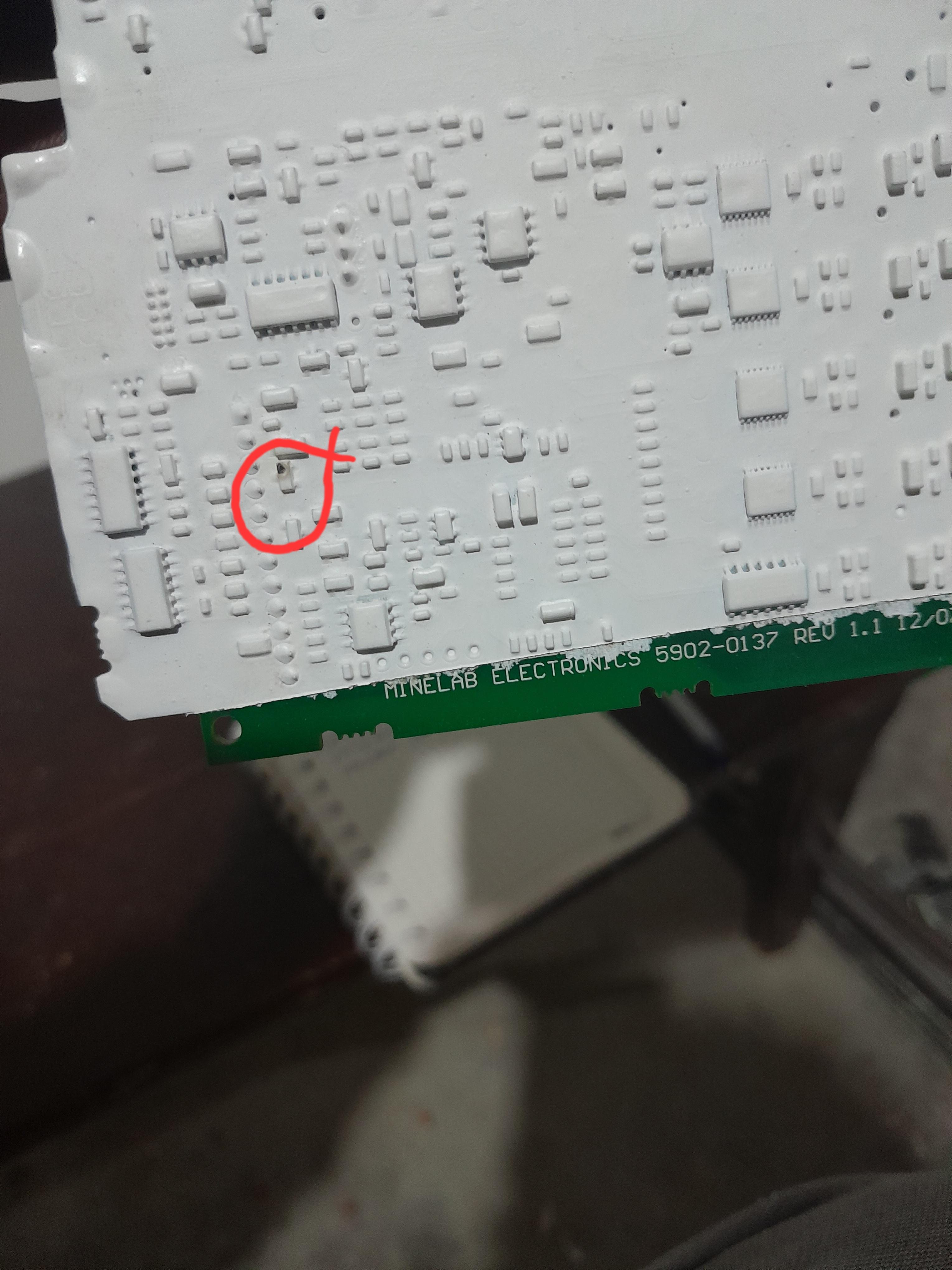

              Thank you so the doid are bav99 and the mosfet are 2n7002 .did there are any replacment for ?
                The detector works with BAV99 removed, look up component specification and find similar.

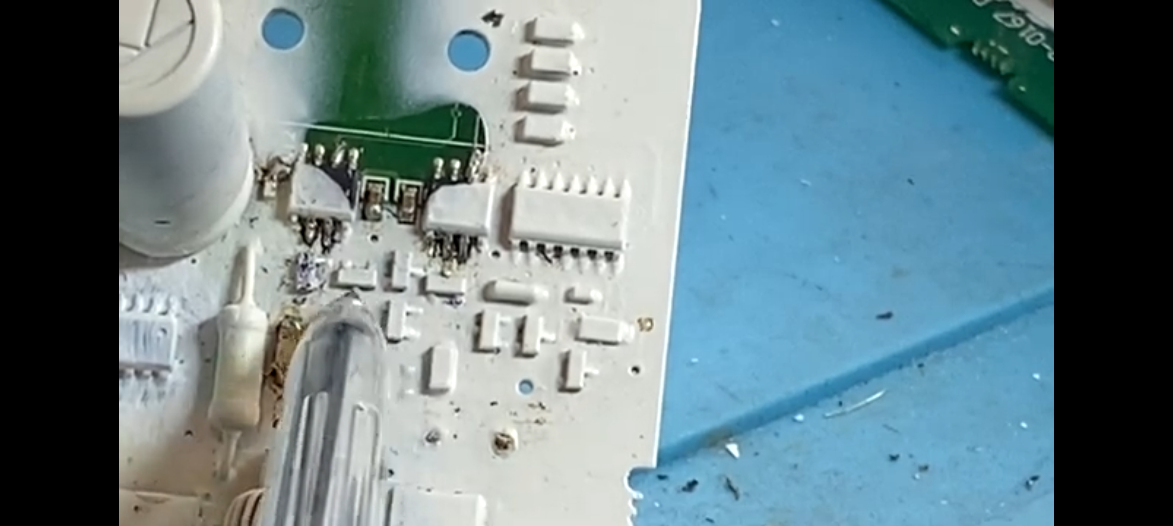

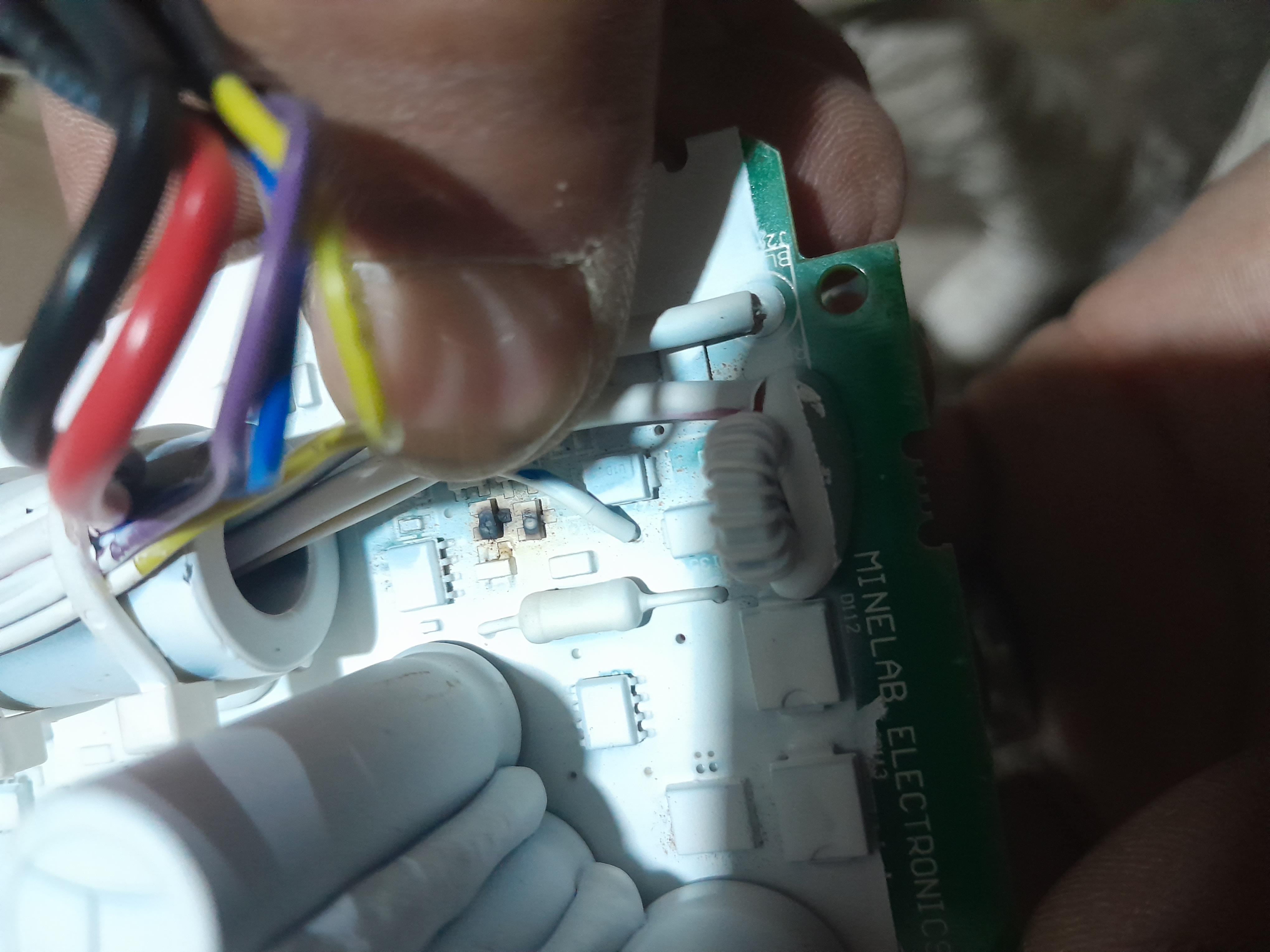

                            Where can jumber anode/gathod bav99 due to the damage of the welding place ?

                            Sorry for my english am biginer in electronics
                              Bss84?
