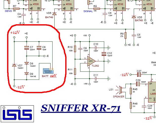

              hi All.
              the schematic, revised by Vladimir Demchenko. your comments if you see mistakes will be greatly appreciated.

                  hi All.
                  where are the power supply?
                  • #99
                    I think your hoody is obscuring your vision.
                    It's in the bottom left of the schematic.
                      sorry, no offense intented, just a bad day...
                      • Hi. And the other ic (U6A) is part of the power suply (it makes the common ...gnd)
