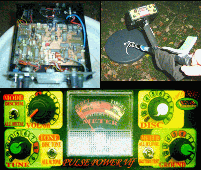

                I wasn’t known it, because I make and sale about twenty such Vlf detectors (50cm coil), for the last couple of month. They are working perfectly stabile, can go deep in ground for medium non-ferrous metals, with good DISC reject and GROUND balanced systems.
                This Vlf works with 2W Tx power, and with a lot of new technology solutions.

                  By the way, since it appears you have this built and for sale (very good !!!) what are the size, type, and number of batteries your unit uses?

                    My units using a lead-acid rechargeable battery 12V, 2,2Ah, 18.5cm x 4.4cm x 7cm, in apart a bag, which can put on belt too, and which can be easily replaced with reserve battery.
                    Pulse Power Vlf is just the name, like Dual Voltage Technology. Power MOSFETs sends intense pulses on Tx, but result indeed is something similar to continuous sine wave.
                    Detection range is the most falsehood information in world of metal detectors. I was read lot of nonsense from sellers in the past, that I really don’t want to take part in it. I can only say, that my units, because of Hi EM Tx field, 50cm very efficient coil, can go much deeper for medium non-ferrous metals then other Vlf or Pi units whose I tested.
