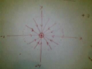

          do u remember my previous mail with drawings .about what I said we found coin from 4 meters(coin was inside of a small closed mud cup that when we opened it my friends hand burned because of gas inside.so think coin at a size of cup because of oxidation effect)
          that machine's antenna was in this manner.transmitter and reciever were in different axis.and in my opinion it's frequency was 50Mhz and it was spectral frequency analyzer.
          Yes i remember but there is a diference between coin and cup.I think that for a cup the max depth is 1-1.5m.I know that for detecting in the ground the max frequency is 500 KHz.Signal of bigger frequency does not have infiltration in the ground.

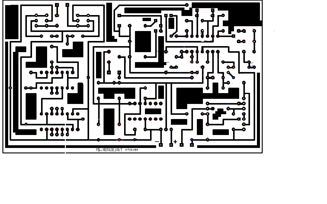

            2 box pcb!!!

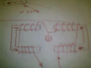

                    Hi GEO
                    I read that files ,thanks for your offer.
                    in my unit there were 2.7 pikofarad condensators which carries frequency to Mhz levels.

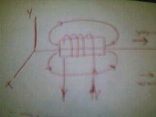

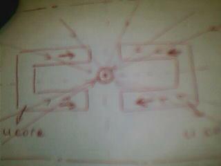

                    in my receiver unit thre were two windings that were connected eachother paralel. one of them is like in picture.and other is around the u cores in rectangular position( in channels around the cores)which is not drawn here.this not drawn one has just two turn around .and it is decreaseing the total inductance.if you calculate you can find approximate frequancy of operating.
                    I tried and found something like 50 Mhz.(I am not electronition and can make mistake)( you can see u cores here http://www.aet.com.pl/en/ferryt/rdzenie_u3.html

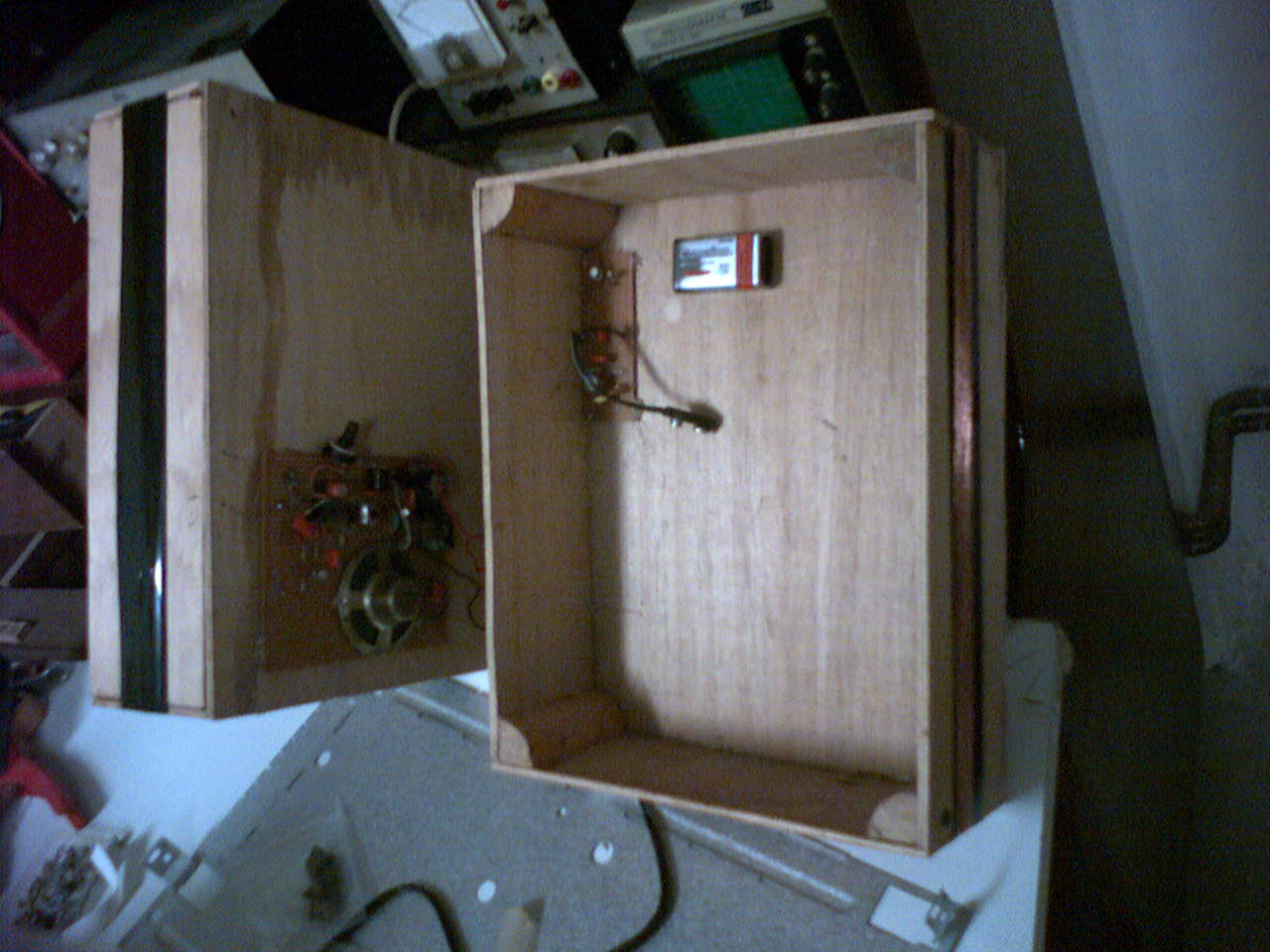

                    and something else ;receiver and transmitter were in a small volume.like two mallboro cigarette box (which have 20 piece in ).
                    QUESTİON ;why , while transmitter and receiver were coming closer penetration to ground decreases? I can understand it's mantality
                    (my units pcb looks like similar to this two box detectors.,except condensator values and TR designs)

                        Hi okantex. I do not know why when transmitter and receiver were coming closer then penetration to ground decreases? But i know that when the coils coming closer then we can detect smaller objects.For an example if we construct the coils about 10cm x 10cm and at a distance of 30..40cm between them then we can detect a coin 25mm. I attach a file with the coils of a 2box detector who i manufactured 5 years ago.I found it today in a wardrobe.
                        Geo

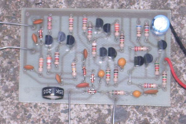

                            I Put the PCB Together Yesterday. One Part of the Circuit Doesn't work.
                            I'm trying to find my Error on the board.
                            I Proto typed all the stages before hand and they worked that way.
                            I Got a Small error on it Somewhere.
                            Take care...........Gary
                            • #44
                              I found out I missed a trace. Now it Works but Oscillates badly as soon as I turn up the gain. See Photo of this proto.
                              This Somewhat Duplicates the CA3035 IC, plus the additional parts in the reciever.
                              The first 3 transistors is stage 1.
                              The next four are stage 3
                              The Last 3 are Stage 3
                              Each stage has a gain greater than 40 DB and a bandwidth of about 250 kHz.
                              I have now re-desined the board and hopefully fixed the problems.
                              Gary

                                why do not you increase frequency and use ferrite core to get powerfull transmitter signal.with ferrite core you can obtain highly consentrated round wave structures that can penetrate ground easy.ferrite core makes small field circules biger and stronger which gives the same effect with low frequency 's optimum field effect.
                                and Mr chemelec the ujt which you do not like gives sudden increase in current and also sudden creation of big field lines that small ones have to be bigger with this effect .These are my opinions ıf I am wrong ,please tell me the true teory.

                                and Mr Geo did you buıld serzirfo in past.and the pcb of chemelec .is it correct .did you check it?I could not undestand it.in schamtic there is a current meter but in pcb I could not find it's outputs.
