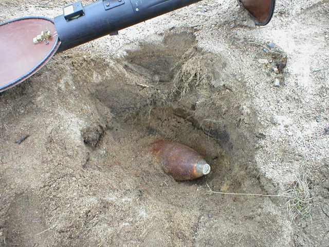

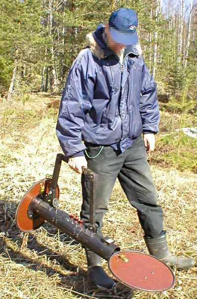

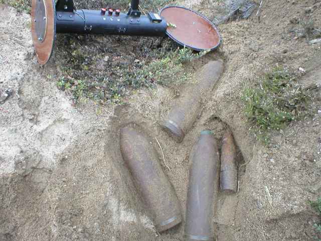

                    • Hi Nelson. The schematic is from Russia and it works. If i remember right as Sevzirfo wrote me the T/R Locator has the ability to Find a very big object (auto) at 4..5 m. This is a modify schematic of Locator maybe by KT315. I don't remember right but i think that someone at this forum constructed it.
                      It is a easy project. Try it .
                      At photo Sevzirfo (i suppose) with prototype of T/R Locator.
                      • hello Geo. thank you for some advertising. Ivan has tested the device in field. succesfully, you can see it.

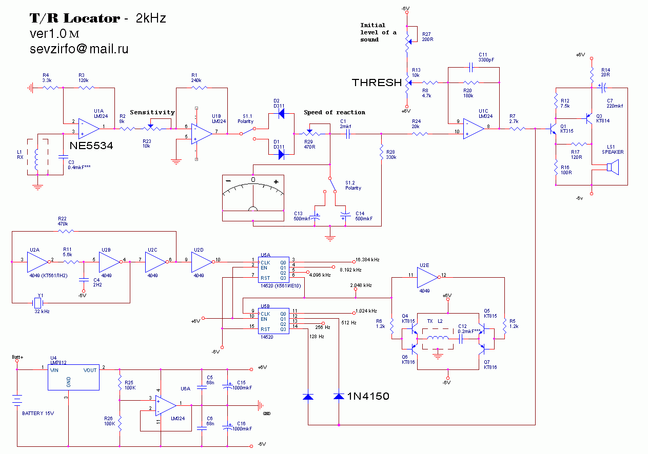

                        • TR locator
                          Hi Geo and thanks for your support.
                          Yes, i decided to build the TR locator, but i need to now a few things:
                          1.- Replacements or correct value for D1 and D2 (both are marked D311)?
                          2.- Value for the meter
                          3.- Correct values for C13, C14, C1, C7, C15, C16 and C3. This are marked number plus mkF, what is mkF?
                          4.- Need details for both coils
                          5.- On the modified shematic, there are two diodes marked 1N4150. I don´t have this, so wich diode replacement can do the job?
                          6.- There are two schematics, the original and a modified version that contains the 1N4150 diodes, wich one are best?
                          7.- I have the PCB, but i´ll like to know if this is the correct one.
                          I hope you or anyone can help.
                          Best regards.
                          Nelson
                          Santiago-CHILE

                          • Hi Nelson. Lets go to see how i can help you.
                            You can use 1N914 or OA91
                            I don't know the internal resistance but try a 200uA (micro)
                            Microfarad (uF)
                            I don't remember but if you are looking for at forum you will find it
                            1N4148
                            The version with IN4150 is a clever modify by KT315. Both are the same.
                            I think it is correct. There are two pcb's. One with jumbers and one without. You must try this with jumpers.
                            Best regards.
                            Nelson
                            Santiago-CHILE
                            Good luck
