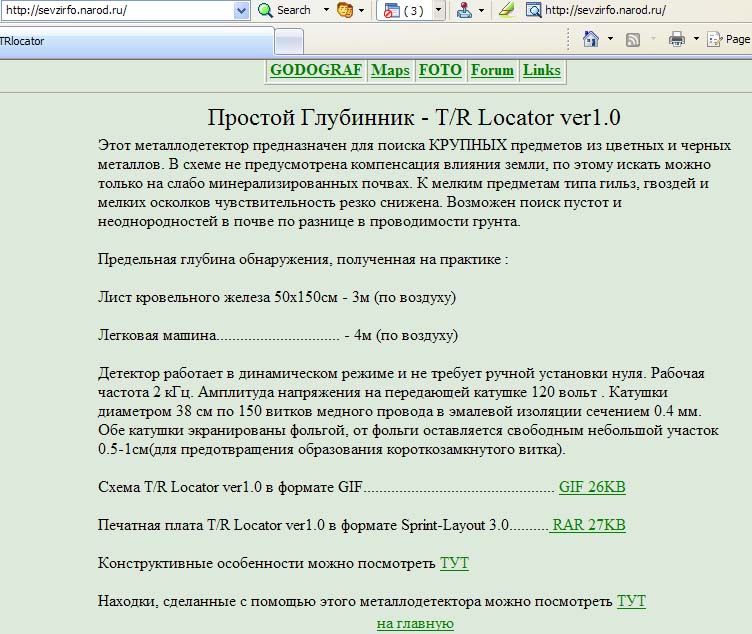

              Hi KT315.
              For some unknown reason i can get into that web site.
              So if you can help me with files i will be very happy.
              My email is [email protected]
              In advance many thanks to who can help me finish this detector.

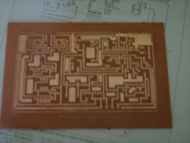

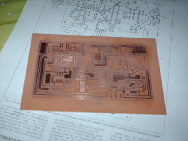

                    • TR Locator
                      Thanks for the information to everyone who is helping me with this circuit.
                      Here i m sending a picture of my TR Locator PCB. It was very easy to made it.
                      Nelson

                              • Linl problem to sevzirfo
                                Hello all:
                                There is nothing (blank) in the page:
                                http://sevzirfo.narod.ru/
                                Have you the same problem?
                                Thank you
