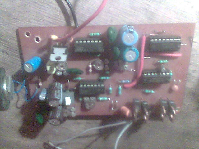

                          • 2 box helppppp
                            Dear members of this great forum, I'm new as you can see but I am old, I mean in this area of research and excavations, of gold .. I want to ask you something, I want to make a device 2box , but I can not find the best and suitable for the deapth I have three or four schemes But I'm afraid it is not good .. I want to your help to reach 2 or three meters . Can any of you help me with this and you have my full love.
                            • hi. i'm black
