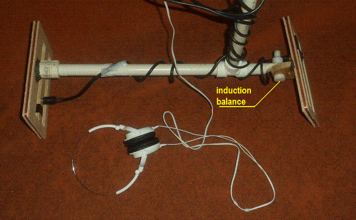

      • Finally I finished building (Re-make of the Treasure Witcher by Charles Drake),
        but it is sensitive only to very large metal at least 30/20 cm at distance 20 cm.
        Also I noted that the reciever battery decharging fast which leade to weakening of the power of reciever.
        I hope any one can fix theseproblems through below pictures.

        coils
        [IMG][/IMG]
        Final form
        [IMG][/IMG]
        • Totob, you sensors balanced? If so, how?

            • It seems that there are balanced in weight.: LOL: Why "receiver coil" you are right angles? Why are not parallel? And how do you balance in "0"?

                For use in the field, the right-hand coil is moved so that it is parallel to the ground. I think it's only in that position to keep it steady for the photo.
                • Problems.......
                  1.Coils must be vertical between them.
                  2. Distance between coils must be at least 80...90 cm if you are looking for objects with dimentions as a soda can or larger.
                  3. It is good to place the oscilator near to Tx coil and the receiver near to Rx coil. Every pcb must have its own battery

                    Yes the reciever coil in the right angle, at this position i hear very low tone (balance in 0).
                    Also when it is in the horizontal position to the ground the balance in 0.
                    so the two positions is ok
                      Problems.......
                      I don't get a tone at distance 80cm, only at maximum 60 cm when the battery of transmitter is fully charged.
                      After few moment of working the power of transmitter becomes weak, that's leading to shortage distance necessary between coils, (30 to 40 cm).
                      note: when i cheked the 9v battery of transmitter i find it 6.5v
                      3. It is good to place the oscilator near to Tx coil and the receiver near to Rx coil. Every pcb must have its own battery: I don't understand this

                            • Originally posted by totob View Post
                              It means to build the transmitter and receiver circuits as separate from each other, powered with separate batteries, to isolate them from each other.
                                The Transmitter Draws considerable Current.
                                Just a Small 9 Volt Battery is Not very good.
                                You need a Higher Amperage Battery.
