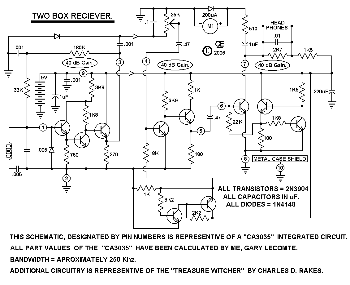

      • Here is the Schematic

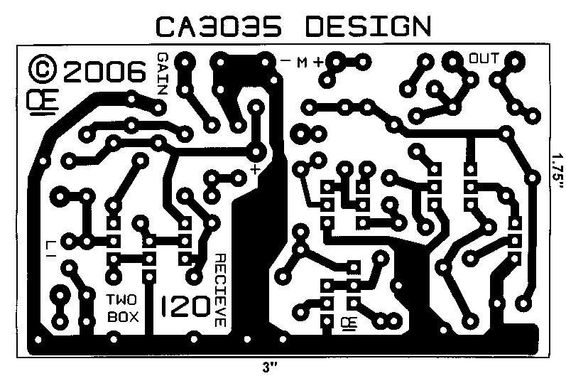

        • Here is the PCB.

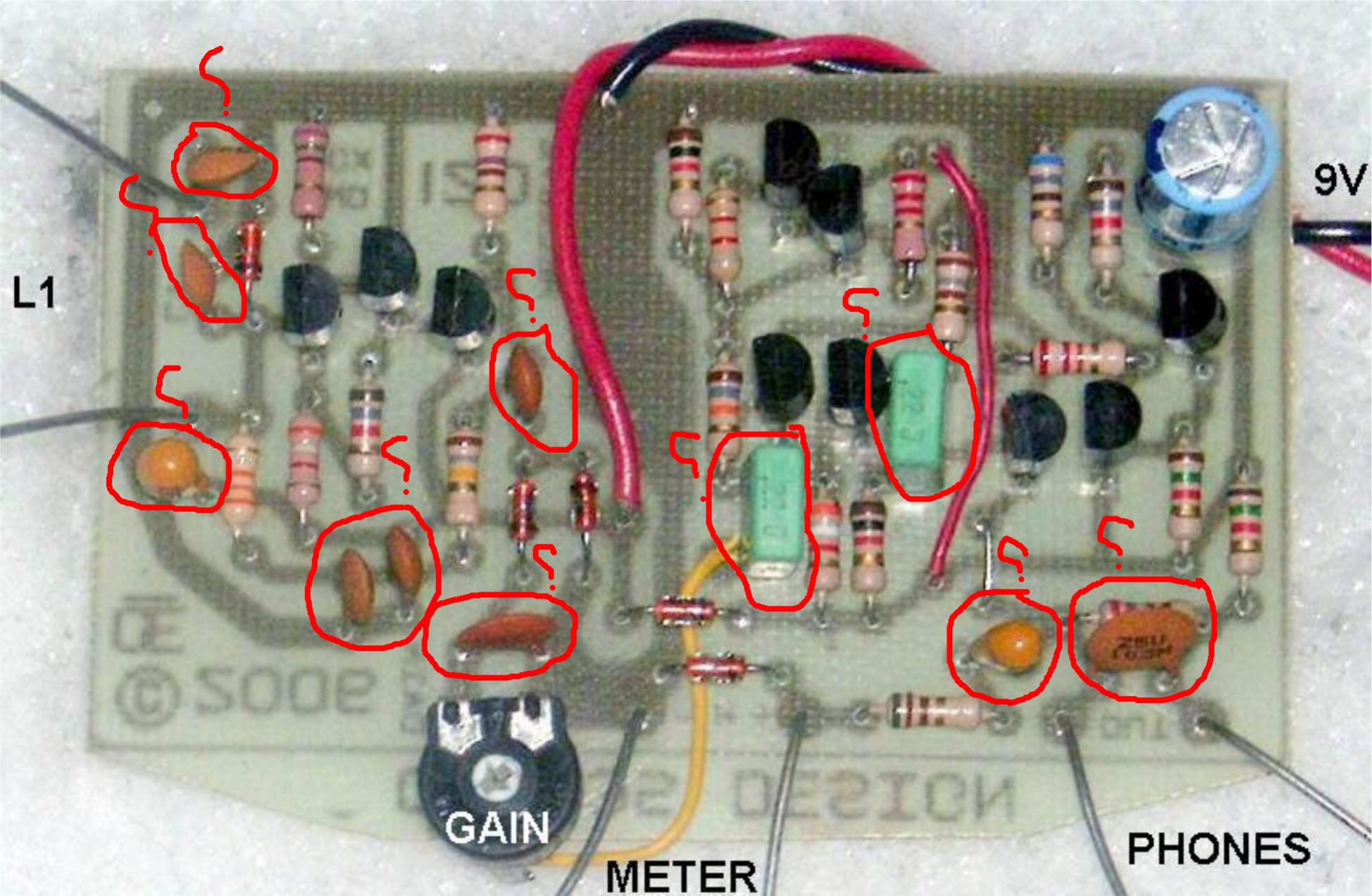

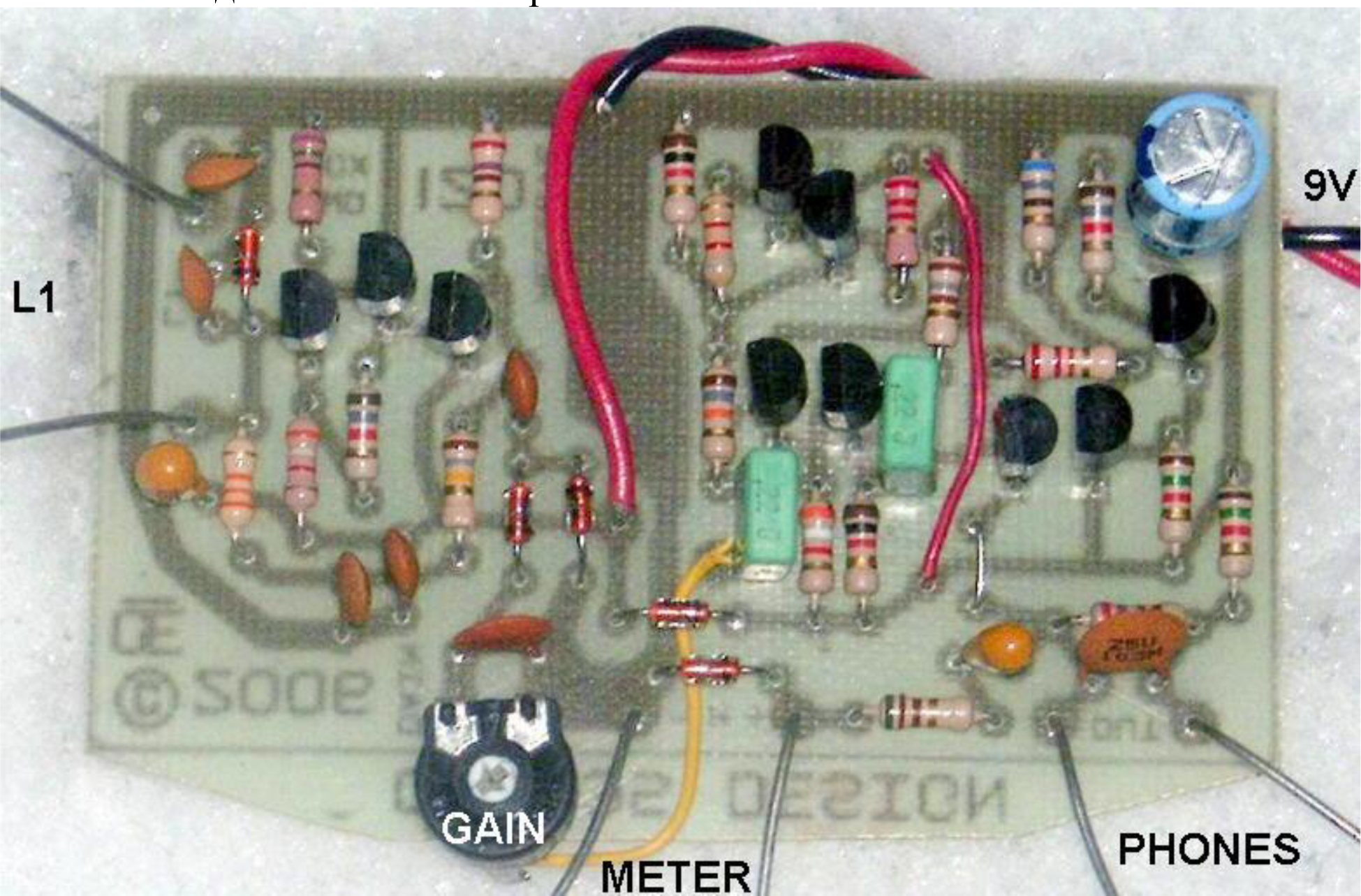

              • hello
                I want to build (Re-make of the Treasure Witcher by Charles Drake). but don't know these type of capacitors used in the reciever board, and if it is polarized or not?.
                [IMG][/IMG]
                [IMG][/IMG]
                - I didn't find the potentiometer 25k . can I use 23k?
                - Also I want to make big coils (50cm/40cm) for finding depth objects, how turns of wire I need and the length between two coils ?.
                I hope to anyone give me some help.

                      • A 23K Pot is OK.
                        The .47uF Caps as shown are Polyester types, But Mylar or Disc Types are OK.
                        The 1uF Caps are TANTALUM.

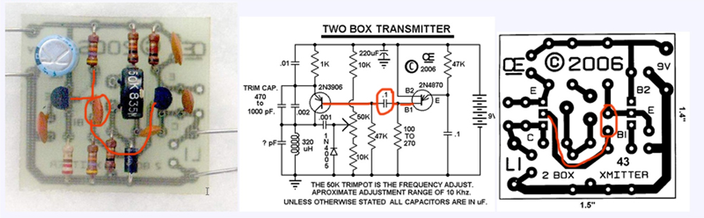

                          • Hello all
                            I am confused about transmitter schematic. I want you to check it, the pol of 0.1 uF capacitor go to the base of transistor (2n3906) and other pol to the B1 of transistor(2n4870).
                            but in the PCB and finished board of transmitter the pol of capacitor go to emitter of transistor (2n4870), instead of b1

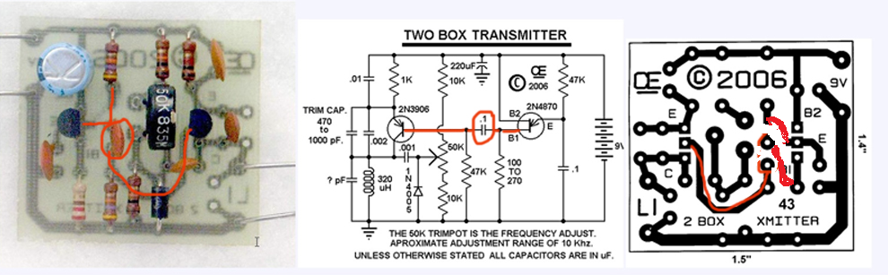

                            • I believe this is correct, a good catch.
