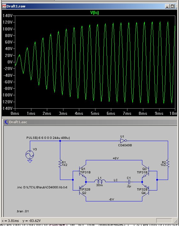

    The batteries B1 and B2 are large 2V rechargeable cells. Batteries B3 - B8 are small 2V rechargeable cells. The TX coil and inductors are very low ohm. The REMI group set for SPICE simulation the following equivalent circuit diagram. Something in it we missed out because the simulation results are poor.

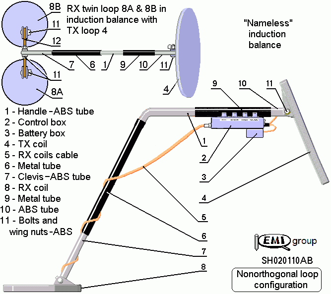

      Ordinary two box TX and RX coils is orthogonal , but in the plan of you ,
      It isn’t orthogonal . I read but cannot understand what advantage behind at this design ?
      • Depth!
        Aft, RX coils are close and parallel to ground, which means more depth. See the difference:
          Mikebg , ok, depth is one of the important parameters .
          Yes, receiver coil near the ground and main is increase deep , But tow box at garret hands ,
          Also TX coil relation to RX coil was 90 degree or other words " orthogonal"

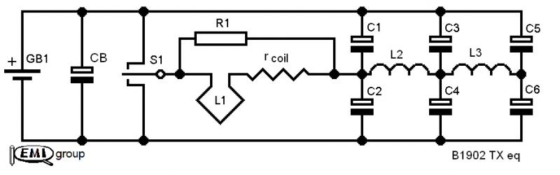

            Esteban, the REMI group has 3 ancient circuits only. I have posted 2 of them because the difference of third one #1902 is in TX and headphones only, but the action of its TX is unsolvable for us. The circuit diagram of strange TX 1902 seems so:

              • Aft72005,
                Experiments show that when the angle letween RX and TX coil axes is less than 90 deg, depth increases.
                The fine adjustment of induction balance also increases depth.
                Moreover, the angles of the coils can be adjusted according to the height of the operator or the slope of the terrain so that the RX coil to move always parallel to the ground and be near it.
                In a change of operator, the adjustment is made as follows:
                1. The operator holds the rod handle 1 and adjusts the length by inserting the tubes 6 and 7 so that the rear part of the carrier rod is horizontal. This principle is not mandatory. The original structure no adjustment of this length. The rear part of rod is a tilted backward or forward depending on the height of the operator.
                2. RX coil is fixed so as to be parallel to the ground. Change the angle is necessary and when the operator is climbing or descending on a sloping terrain.
                3. TX coil is rotated fine to obtain induction balance. In GEMINI 3 also provides fine tuning of the induction balance.

                    • Originally posted by GeorgeGW View Post
                      how much turns.... or inductance must have the coils.. TX and RX???

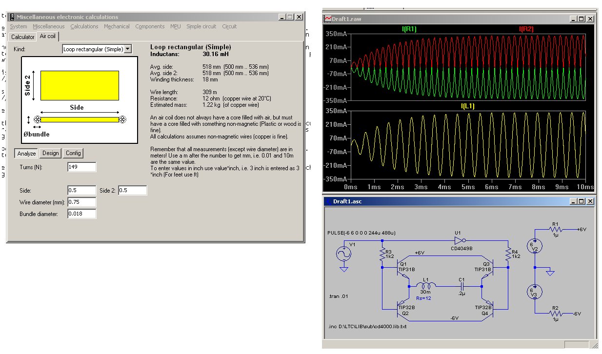

                      Before you can calculate how many turns, you need to decide on the size of the coil. For the transmitter coil to resonate with .2uF (aka 200nF) you need 30mH.
                      If you want the receiver coil to be in resonance you would use 15mH.
                      You should Google and download "MiscEl". It has a versatile coil calculator that can figure rectangular coils, and will tell you the length wire you will need and
                      what the resistance will be for the parameters that you input. It also will tell you how much the coil will weigh!

                      edit: One thing you should watch out for is that the TX capacitor will need to handle a relatively high voltage that will increase as wire diameter increases.
                      With the 0.75mm wire in my simulation, LTspice shows a 180Vp-p signal at the LC junction. A Polypropylene capacitor rated at 250VDC might be OK
                      but 400VDC would be better ESPECIALLY if you plan to use larger wire. I made a mistake with my second circuit simulation diagram after I re-drew it,
                      left out the 12 ohms series resistance present in the first drawing, and you can see an even higher voltage that could result.
                      Too late to change that. I hurried to get this "edit" posted and I make mistakes when I get in a hurry.
                      Use polypropylene, because anything less might heat up under the stress. I do not have conversion formulas for DC and AC capacitor voltages 'safety',
                      but be aware you could run into trouble if you use an inferior capacitor. Capacitors can explode dangerously.

                              Aft72005,
