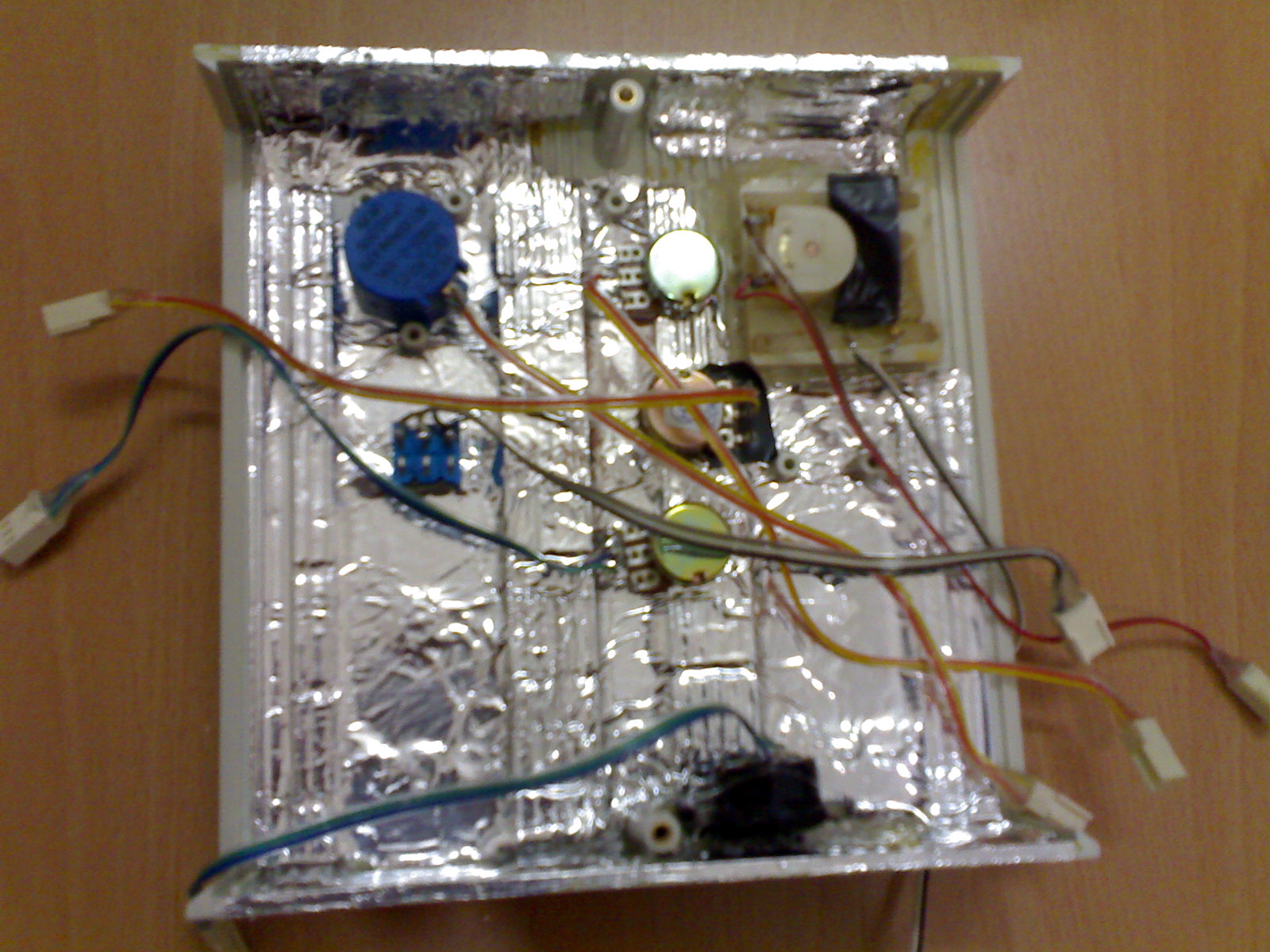

                      • How about this, dear Mikebg?
                        • Originally posted by scs View Post
                          The increased voltage of transistors and other changes that are known
                          • Originally posted by starmoml View Post
                            Starmoml, what circuit diagram you use for your 2box project?
                            Don't increase supply voltage. This can't help to increase sensitivity.
                            Please write answers the following questions in your native language:
                            1. How you test that your TX circuit operates correctly?
                            2. What is resistance of your coils?
                            3. How you adjust coils in perfect induction balance?
                            4. Explain how you adjust the gain of RX preamp?
                            Then post me the answers via email.

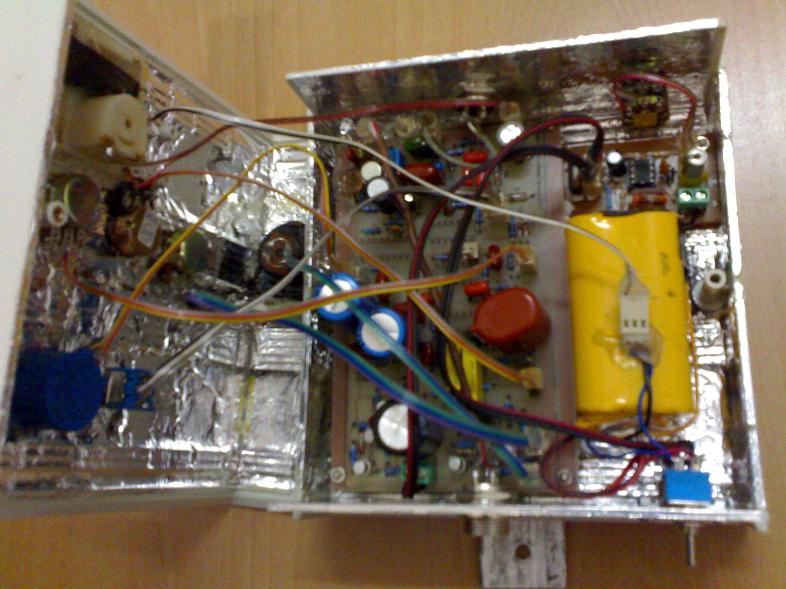

                              • WIRE: 0.7
                                Total rounds: 72
                                5100 to 5400 mh
                                Frequency: 11 to 12.5
                                Resistance: 4.1 OhmsClick image for larger version
