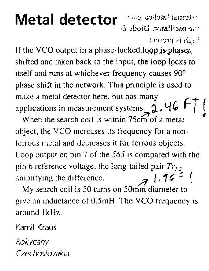

                  Yes - I am familiar with this circuit. In fact, in 1996 I actually built and tested a very similar design from Kamil Kraus based on this original concept. This design also contained a mistake, but when rectified the circuit did actually work. However, it does not have anywhere near the sensitivity claimed. According to a University experiment, a piece of thin metal sheet (5.5" x 3") moved near to a coil produced a change of about +0.75% in L for an operating frequency of 1KHz at a distance of one inch. Other figures taken from the graph were: +1% at 0.5", +0.25% at 2" and 0.1% at 3". For the similar design that I tested, a 1% change in inductance would have required the sheet to be within 0.5" to provide a meter reading of only 18% of f.s.d.
                  I very much doubt that anything would register on the meter at 75cm (29.5"). My suspicion is that this should be 75mm (2.95")

                        After searching for and finding my notes on this circuit, I can confirm that there are were two versions published by Kamil Kraus. The circuit published on this site by Carl matches version 1 exactly, and I still cannot believe that it is able to detect a large metal object at 75cm (29.5"). The search coil is constructed with 50 turns on a 50mm (~2") former !!
                        This is far too small a coil for detection at such a long distance.
                        I also noticed that in my notes I had crossed out "75cm" and replaced this with "75mm", presumably because I considered this to be a typo.
                        I will post the second version soon for your perusal.
                        Has any else built this circuit, or would like to comment?

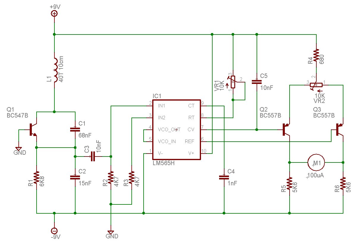

                          Second Version
                          Here is the second version of the PLL Detector by Kamil Kraus.
                          This one has a search coil with 40 turns on a 10cm (3.9") former, and the ammeter needs to be a +/- 100uA type. The null position of the ammeter at the beginning of measurements is set up by VR2 whereas the free-running frequency (set at 75KHz) - and hence the locking mode of the PLL - is set up by VR1.
                          This is the version that I originally tested and found to be lacking.

                              Another version
                              Originally posted by Esteban
                              Original application by Signetics, think was posted by Carl some years ago on first forum.
                              So this is yet another (3rd) version of this circuit, but with an 8.5" coil.
                              I have also searched the Geotech site and found references to this circuit going back nearly 6 years, with a claim that this (3rd) version was first published in 1972.
                              I've also attached a scanned copy of an article relating to the first version, where someone has added some written comments.
