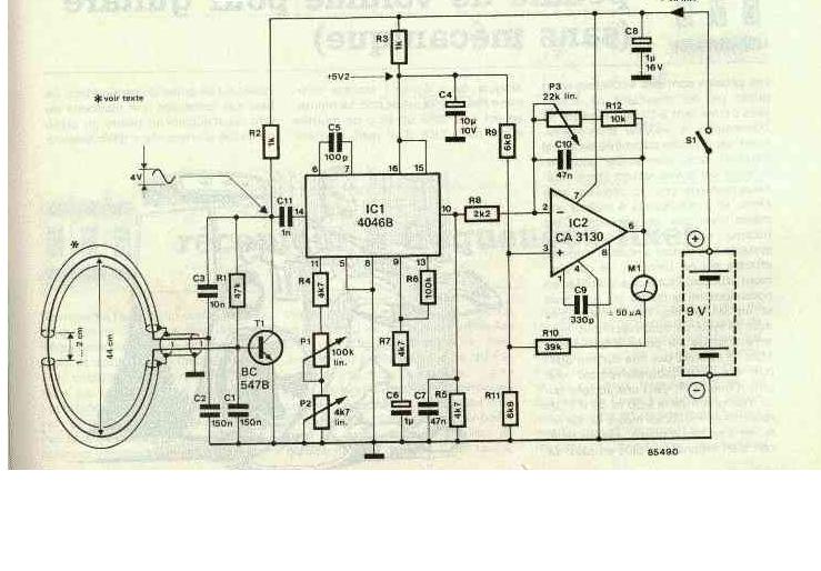

    Think first version is the application notes by Signetics. There are many different -some elaborate- projects: French, Italian, Brazilian... The Brazilian -interesting- is the last I collect based on 565.
    Another PLL -but with base on 4046- was published by Elektor: only one turn coil-coaxial cable...

      Hi Qiaozhi. Today i found the magazine with the schematic. The schematic is the same with attached file. Q2 Q3 Q4 and Q5 are 2N4403. I believe that with a big coil it will detect at large distance and has the ability to discriminate ferrous and no ferous objects. If i remember good it was a litle unstable.
        Hi Esteban. Did you try it?

          Not big deal if skip conventional way of making coil and use Cu pipe, rolled in a circle, with slice opened flange, for 1-2mm and also used that "holder"as gnd as well as F.cage....maybe help !? BFO has lack of stabillity anyway...
            Geo, only is for big items this one turn coil MD, no very enthusiast I'm constructing it...
              Hi Esteban.
              I thought that perhaps it was a good solution for big objects with a coil 70.. 80 cm.
              Yes I believe the same with Ivcomic about bfo stability.
                Hi, yes is true, you can build a big search coaxial coil. In this case hope the shield of the coaxial is enough for to mantain the stability.

                  The major reason of the bfo bad stability is the frequency shift so the bad quality of capacitors is the major reason (the coil is major of change only if has very thin wire and it heats)

                    This looks like a design from Elektor. Correct?
                      Yes, you're right.

                          The third circuit is attached to post #14.
