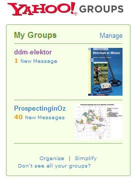

      Search in Yahoo French forum about projects by Rolf Wilhelm. In the forum, in the section Fichers, you can find the PCB of the DBP2010 and another PI's modifications: Stuart, XR71, Delta, VLF 770, etc., and another projects. First, think you require a Yahoo account (free email), and automatically you can access to Yahoo Groups in Yahoo main page.
      The name of the Group is: ddm-elektor
      http://fr.groups.yahoo.com/group/ddm-elektor/
      The image of the page:
        Thanks, Esteban. I have picked that forum apart for clues. I can't read French and when I use the translator, it doesn't always make sense. I did find the zip file and opened it, but you have to know which program they used to open the files. Boardmaker 2 created the .pcb file, but I can't open the .plt file. Can anyone else?

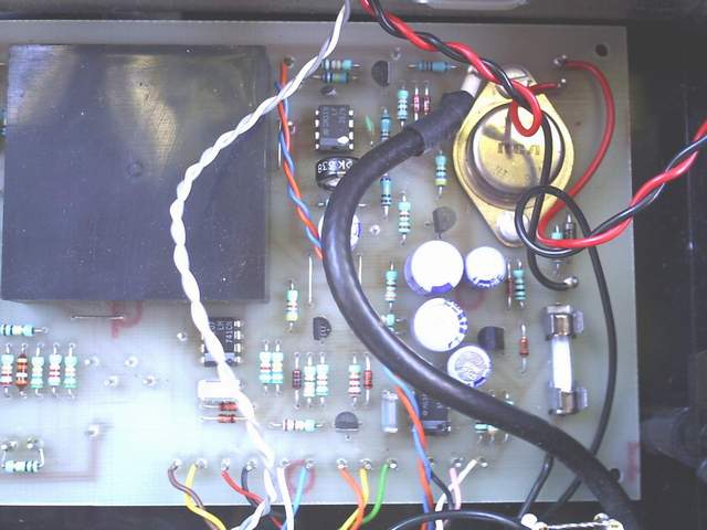

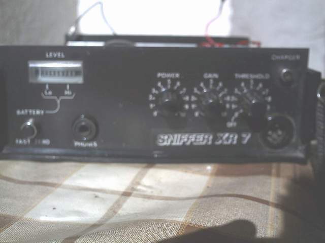

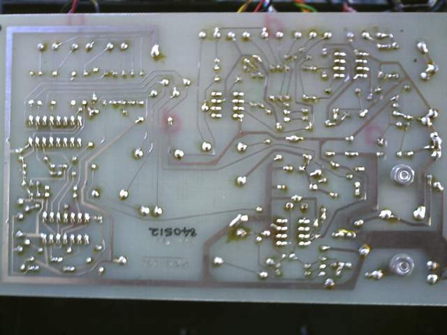

                          I just received strange PI detector!?
                          Sniffer XR 7 !?!?!?
                          Inside the box i founded DBP 2010!!!
                          Detector is in very good shape,working nice.Comparing to Delta Pulse
                          I can tell; EVEN....
                          Very good results on test field!

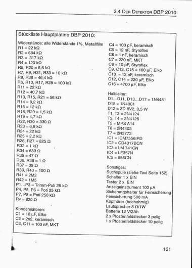

                          Excellent chance to check out validity of project documentation i already
                          have and try to find eventual fakes...

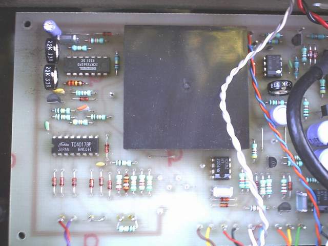

                          So i checked. On posted BOM every component value is accurate!
                          I checked all elements on pcb except those in black box,since it is glued/filled
                          with a kind of resin,which right now i can not brake,scratch or anyhow open.
                          Asume that misterious fake must be in that black box,cose every other element
                          value is trully quoted in BOM.
                          I made a copy of DBP2010 few years ago....it failed...I respected the very same
                          BOM....
                          Later,when winter comes,i'll have much more time to "play" with it.Than i'll
                          try somehow to open that black box and check elements inside.
                          If any remarks i'll post here than.
                          This device,although it is a bit "obsolete", is still very useable...i can tell.
                          I checked it on my regular test field, where usually checked so many detectors
                          so far. Results are very good! I am very satisfied with it.
                          Right now i can not help here with any more than post a few photos....
                          P.S.
                          Any tip how to open box without damaging components and pcb inside?

                            Hi Ivconic . Here is the answer that Alexismex gave to Qiaozhi when open the black box of Mineoro.
                            "Hey Qiaozhi, I tell you my secret 70% to depotting all the epoxy and polyester, urethane and silicon resin ...USE cold (freeze) and hott temperature (500-600°) alternating , the resin brake gently very quickcly and many times the electronics resist very well (because the temp do not go direct to it, always the resine "brake" 3-4mm above the ic,resistor,inductor, etc...)...it is the essence of the technique, imagine the tools and you have the other 30% of the secret.you can see in the photo the scraped away in flakes and chunks"
