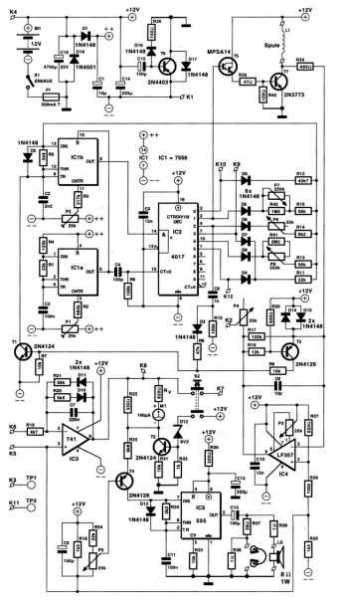

      Yes Okantex that is right schematic, i also have...

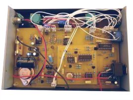

        look at third picture.opened black box
        total IC =8
        not five like which is on list

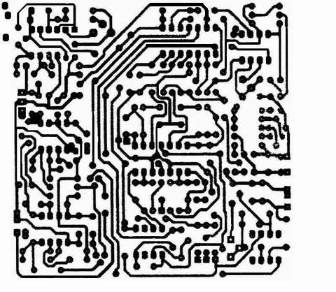

                pcb
                I would like to make easy for you.Here is pcb i used...
                Components placement you can see in Jackdetects "...Fisher inknown..."...
                Schematic of Classic I is posted somewhere here on this forum-original White's schematic...Difference between CL1 and CL3 ....few...
                Also there is very accurate schematic of CL3 that KT315 posted here...

                    Hi Ivconic. Thanks. The pcb in photo is in drawing mode or i must draw it oposite? (i have not photo sensitive pcb so i will draw it with my hands...Ohhhh ). I have 1 year to draw pcb (from delta pulse).
                      Peace of cake
                      :confused:
                      C'mon Geo! It is easy to "flip" it horizontal or vertical with Corel PhotoPaint or ACDSEE or any other software!?
                      "Flip" or "Mirror" or any other term to name that function, all grpahics software has it already...
                      Compare to components placement from Jackdetects Project under "...Fisher unknown..." and you'll see...
                      Very easy!
                        I use irfanView for my photos and it can make this change.
                        you chose pic than
                        in image column ,there is "hprizantal Flip" ,click this
                        and here what you want
                        than print with lazer -jet printer( toner)
                        than iron it on copper
