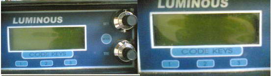

                  Excuse me I tried but couldn't take better or useable Graphics. the formation of unit didn't allow me do it properly. Please pardon me for bad quality.
                    these three from its' panel. I am sure there is no technical note can be as a help.
                      Thank you very much, Michael. The pictures aren't too bad at all If you're concerned about quality up close, then most cameras have a button with a flower icon that will let you take close up pics.
                      Your unit has a module board on it above the main pcb. My guess is that the module allows for the discrimination. Thanks again. More pictures, please? Maybe a picture of the whole machine?
                      Best,
                      Darren

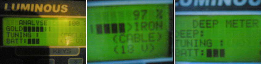

                        OK Darren, this more pictures for you, but can they be really useful??!!

                            Thanks, Michael, for the pictures...and Ivconic for the explanation
