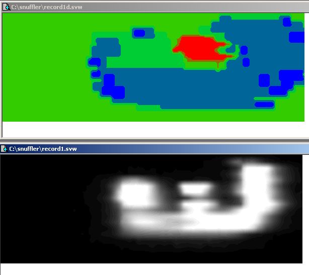

      Yes It's a great project and I'm very pleased with this unit. All claims on that site are true. (air tests, discrimination).
      Note that delay time of this unit is quite long +-25us.
      I use it (attached to logger) primarily to screen out ferrous targets from magnetometer surveys in suburban areas but it should work well for treasure hunting too.
      Attached is the result of logged scan of curved metal tube, with two coins inside. (this was done by Krasnimir - constructor of PD3200).

        Do not like to post untrue informations..
        The delay time is around 50us..as this detector was built for coins and bigger targets. But Krasnimir can adjust PIC hex for faster sampling if you want to.
