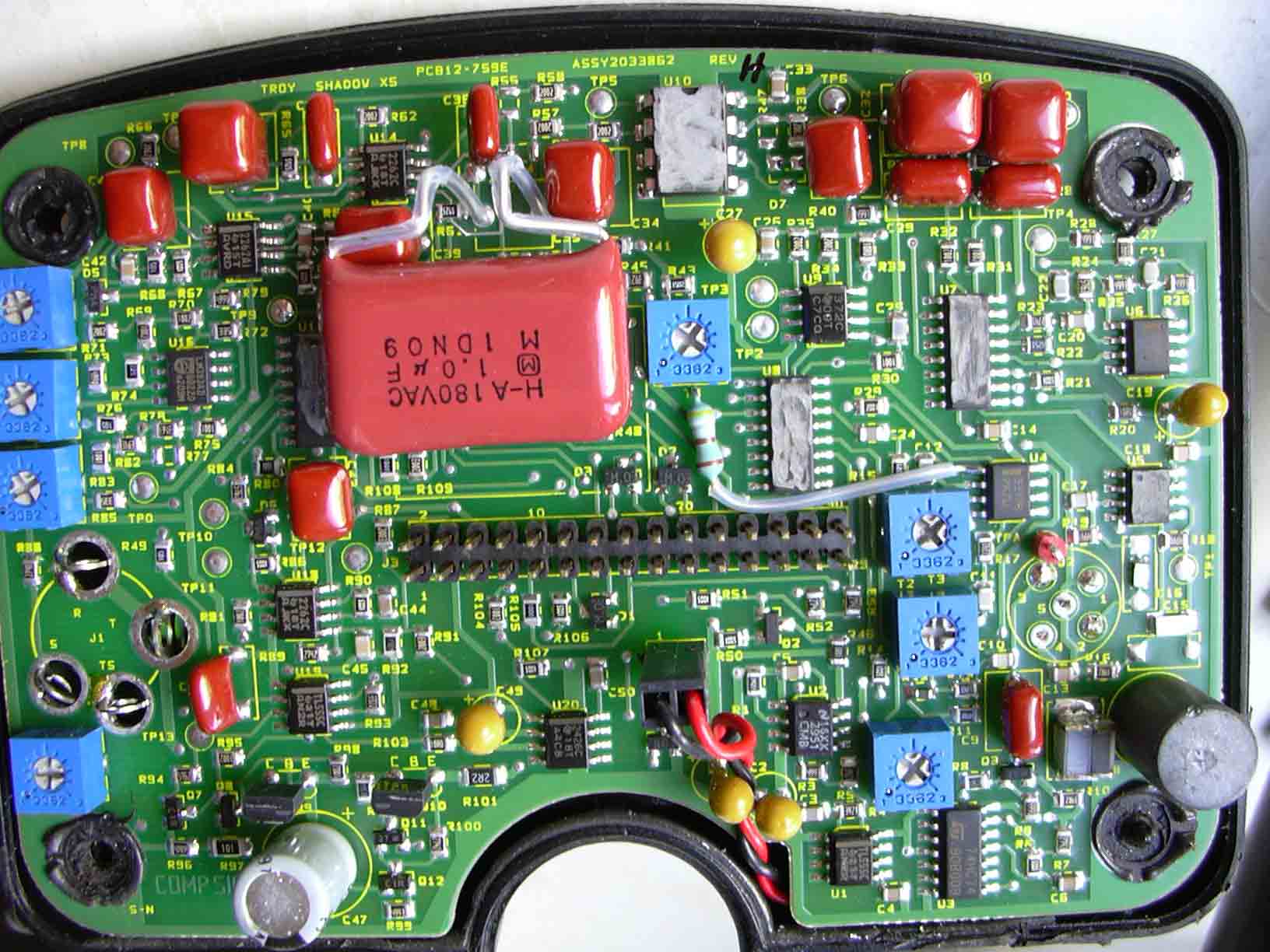

    Hi all, Just wanted to see if any of you have had a look inside a Shadow (X5,X3,X2). I heard somewhere that its all surface mount and very efficient circuit. I would like to know what the story is with the 9 volt battery? Is this a detector using the same old circuts but just so efficient that all it needs is 9 volts or is this some radical new design that doesn't need a lot of juice? Whats with the frequency? why so high? has anyone used/played/tinkered with one? are they worth the money?

          Most current detectors are mostly surface mount. In fact, unlike the detector pictured, many detectors have surface mount capacitors. Surface mount parts are now used in most electronic devices, but they do not make a circuit more efficient.
          Circuit efficiency is increased by using close tolerance components (meaning that the actual values of the components are close to the ideal values calculated by the circuit designer). Most of the components in the picture are 1% (very close tolerance).

                  Can anyone guess my that large cap (probably an early mod) had to be 180V?
                    I have schematic and therefore I'm able to answer. This cap is fulfilling two functions.
                    1.Is normal cap in motion filter in Disc Mode.
                    2 Is Sample & Hold cap in All Metal (Pinpoint) mode.
                    And therefore voltage must be 180V.
                          I didn't look it up but it looks like a panasonic capacitor.
                          Polypropalene - lower dialetric absorbsion (spell)
                          than polyester, which is smaller cap and cheaper cap
                          but bunnie dave missed that.
                          someone else probably fixed it.
                          It could probably use a couple more as signal caps
                          in a couple more places. too late.
                          polypropalene is not often used for cost
                          performance is always better.
                          used for phase shift caps in motor/power circuits
                          Carl can explain it all.

                            Oh btw there is not 180v on that cap
                            max 9 v with the tiny 9v batteries
                            that won't find a pot o gold at 2 feet.
                            another advantage of polypropalene
                            temperature stability
                            in line polyester cap cause big phase shift
                            make you think you found pot of gold
                            when its just another nail
                            in this case probably temp stab.

                              Having done this crap for awhile
                              the red cap, up and to the left
                              in the picture, second from left
                              almost perfect square viewed from top
                              will be a 1 uf polyester for comparison
                              the far left one is probably 0.47 uf
                              you can see that the polypropalene is much larger
                              and the higher voltage is not needed but
                              the cheapest ones that they could buy
                              should be available in 50 v also
