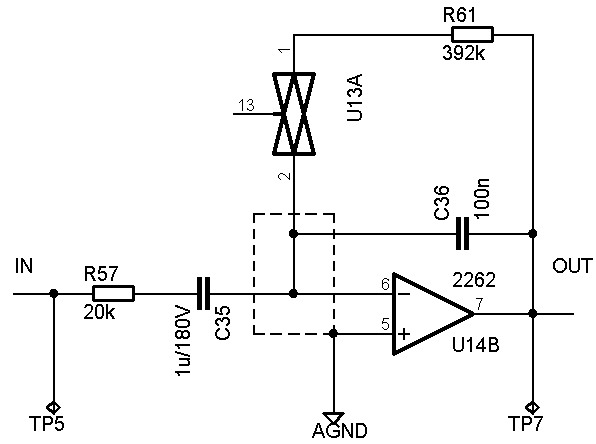

                              can you give me more pictures it is very ineresting to trace scheme and to see the pricip.
                                I was repairing these detectors. These aren't magic devices. The circuit is rather standard. However he is designed extremely optimally. And therefore he has so good parameters. Detector about the similar concept it is Tesoro Tejon. However X5 is taking much less current consumption. Only 18mA. It is the only detector, which current is being increased in after excluding the coil. It was a lot of posts, what none explained why cap 1uF is 180V. I am placing the part of the schema where can be seen when he is connected the cap. When U13 is closed, cicuit is working as Band Pass Filter 5.5Hz x6.5 . When U13 is open, circuit is working as the DC amplifier x10. And therefore cap must be on 180V.
