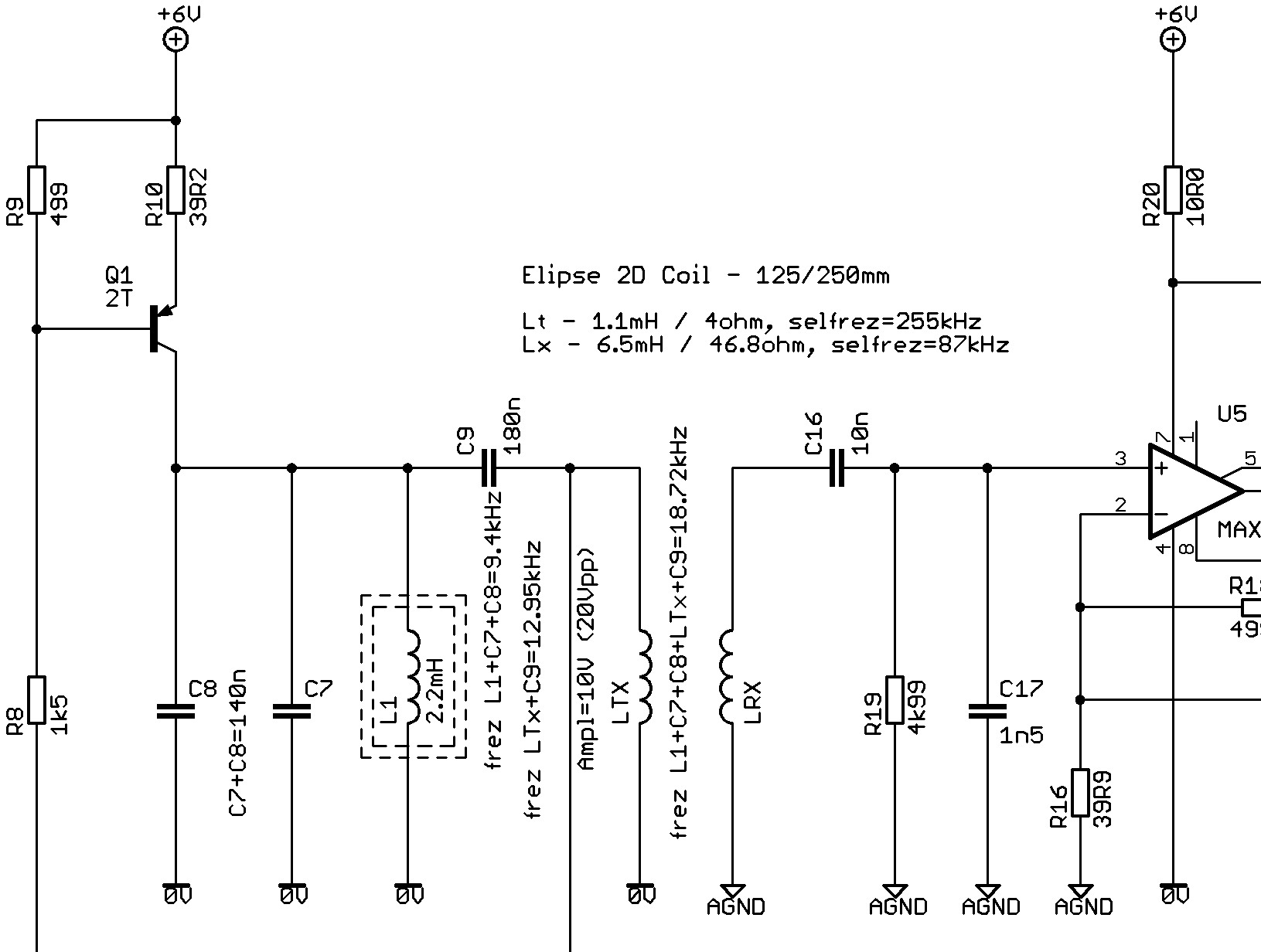

                              hi Mrand!
                              can you speak TX coil in this X-5 is of parallel or serial resonanse type? or maybe without a resonanse as it is in Fisher CZ-6...Minelab Elite etc.? can you share up TX driver's sketch?
                              yours
                              • #45
                                This is interesting part of X-5 schematic
                                Mrand
