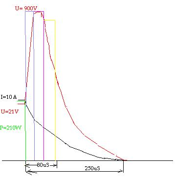

            Still don't get the 600W... 10 amps @ 21v is only 210W, and averaging it out only makes it less.

              Hi Michael.
              It is normal peak power to be 700W for 10A and 900V .Look at the picture:
              when you off the current , the selfinductance of coil produce hi voltage -900V. Becouse the current in this moment is not 0A(2-1A) and you multiply current by voltage you will have 700W or more for this moment(about 40uS).
              That is all ! It is simple!
